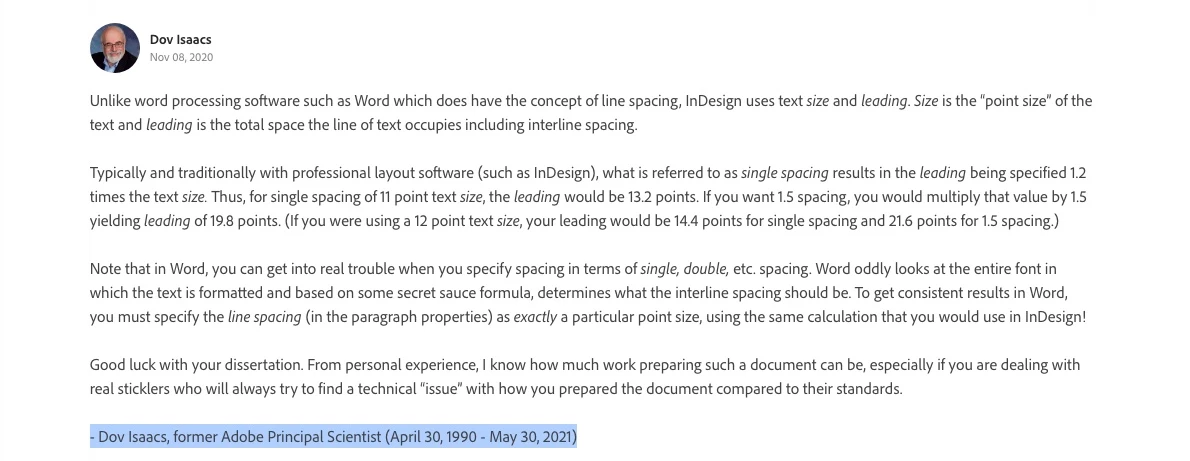

It was determined that by all indications the assumed number 12.65 provided on many platforms was inorrect. After reviewing an article by "- Dov Isaacs, former Adobe Principal Scientist (April 30, 1990 - May 30, 2021)"-  the math behind what was given was in fact inccorect. He stipulated that a single line spacing of text at 11pt font would be 13.2 so lets say for simple maths that 13.2 = 100% line spacing therefore 1.15 is 100%+15% line spacing (because in parameters 1=100% and any point value is a precentage of that one ie: 0.5 = 50%) making the actually number to represent 1.15 in spacing should in fact be 15.18 pt leading and NOT 12.65. Finding that my settings may not have been wrong I tested it again by printing a copy on transparency to over lay the text and found it nearly perfect. Near I say, because the lowercase height ratio of Bookman oldstyle may be off a little affecting the calculations, as indicated by his artcile, 'the font archetecture also plays a small variable' in determining these things. So, for Bookman Oldstyle for sure 15.18 is exactly 1.15 for 11pt font. Regular. I added  his article below so you can use this to make yoru own calculations and add it to your notes to help others down the road.

Im not I am merly stateing that when anyone googles "what does line spacing 1.15 equate to as leading in InDesing... you get 12.65" when in fact acording to research and technical readouts by the adobe comunity it is 15.18
The statement was that MY PROBLEM was I made an assumption based on Ai and corrected it and then posted the findings of that correction merely to show others not to trust google off hand. I had worked on this with an Adobe technical assistant and we came to the solution together. He is correcting the information in HIS handbook while I merly took initiative to provide my findings and my base for the solution to my original assumptions.

I would have to disagree with your assertion that single line spacing in Word for 11 pt. type is not 13.2 pts.
Standard auto leading in both Word and InDesign is 120%. if you want 1.15 times the single line spacing then the correct amount would be 15.18 pts, but what you are actually saying is you want tighter spacing, 1.15 x the font size  would in this case be the 12.65 points you are suggesting.

I did not say that 11pt single line spacing wasn't 13.2 ( which is the original 120 auto leading) I utilized that- IF (and only if)  it is 13.2 (as defined by the attatched document). and the value is 1 (as in One whole line space) then 1.15 would be 15.18 Because the math indicates (1 (13.2)* a value of it's self and addition .15 (1.15) is then calculated to 15.18) The print copy proves this to be true. Therefore the number provided by google's Ai algorithum 12.65 (for the 1.15 conversion) may be incorrect if its calculating bookman oldstyle at 11pt font reg)
the values I used are taken from the document attatched. There may be differences for each font so when using this information take that into consideration.
