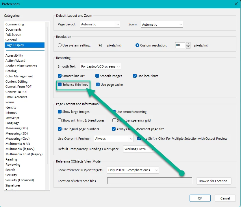

Did you uncheck this checkbox in your Acrobat settings?

Hi George,
Thanks for the reply but acrobat settings is not a solution for me.  Firstly, I have checked and unchecked that box and it has not made a difference in this case.  Also, as I mentioned in my post, the line weight issue in this case appears in both Acrobat and Preview, so to the extent that its a PDF viewer software setting, it seems to be a default one accross platforms.  Furthermore, the fact that it can be addressed in the acrobat settings is not a solution for me because I am sending this portfolio to employers and I cannot be in the room to see what their acrobat settings may be, nor can I expect them to adjust their settings at my request.
I am not concerned with my own ability to view a document correctly as an individual user, but how to ensure that a document I send out will be viewed correctly by the recipients.  I cannot expect them to "find a workaround" or even to realize that my document is being rendered incorrectly.
If there is a way to manage that type of setting as one of the interactive behaviors in the inDesign export dialogue or something I'd love to know.
