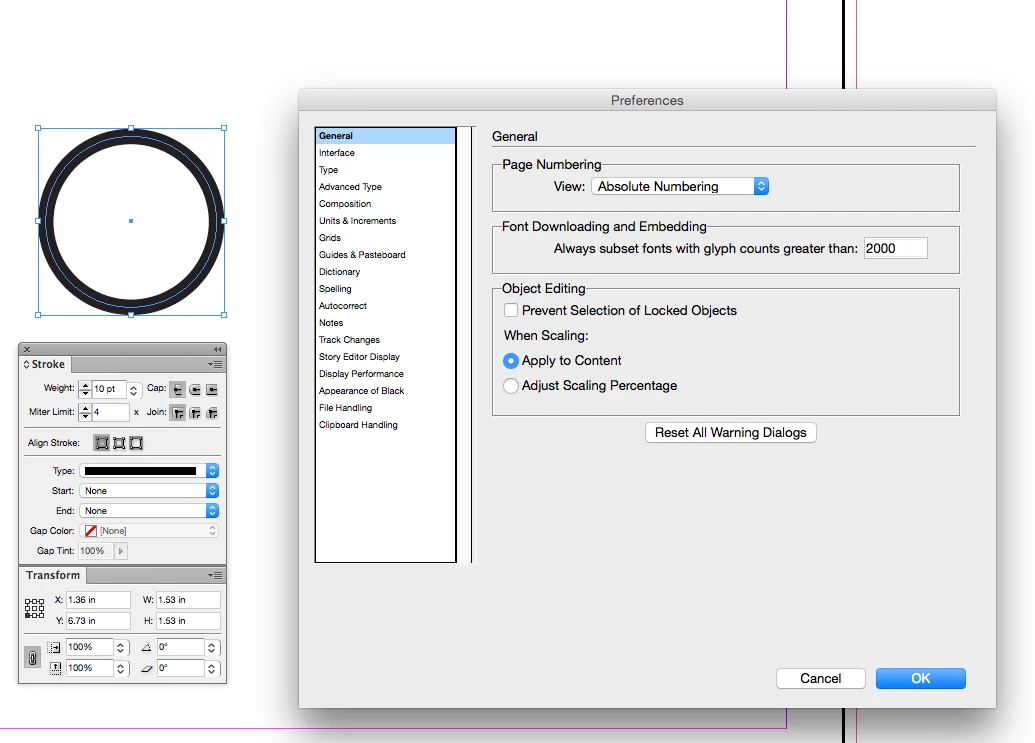

The preference has changed a bit with the CC apps, but this is what I see in CS6:
With Apply to Content selected, the stroke is scaled and the transform percentage stays at 100% after the scale, so a 300% transform shows the stroke starting at 10pt and ending at 30pt with the scale value reset to 100%

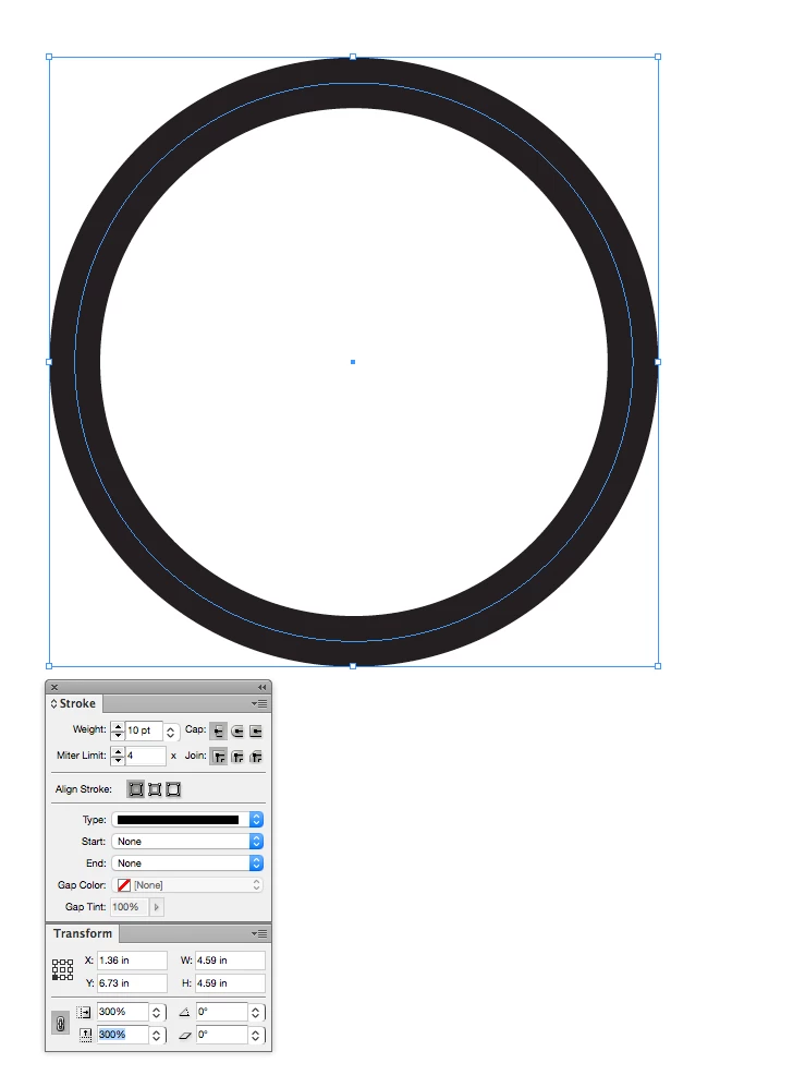

With Adjust Scaling the stroke size is unchanged, but the transform percentage is indicated, so here I have a 10pt stroke, but its scale is 300%. Changing the preference only affects future transforms
