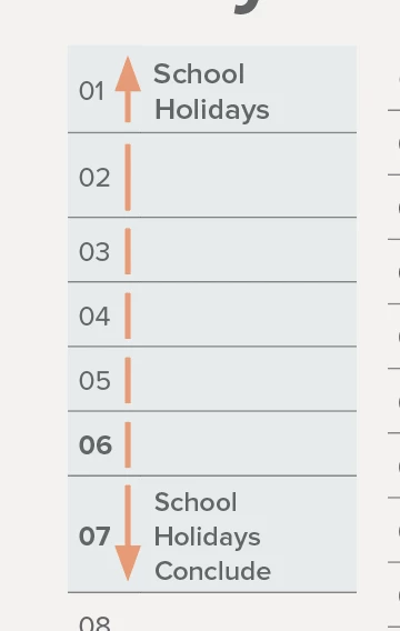

I’m working with a table in InDesign and trying to create the appearance of a vertical line with gaps at the top and bottom between rows.
Here’s what I’ve tried:
  • Added a narrow column and applied a cell fill to mimic a vertical line.
  • Added top and bottom cell insets (padding) via Table > Cell Options > Text.
  • Tried adding spaces or soft returns inside each cell to force the padding to take effect.
But the fill still runs full-height, and I can’t get the padding to create visible gaps at the top and bottom of the fill area.
Is there a better method to achieve this effect using native table features (no manual lines)?
See orange line below, I'm trying to create this with stroke, not add in manually. the arrow head I can add in manually.

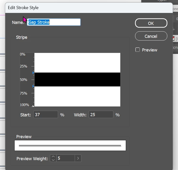

Another option is to create a custom stroke style in the Strokes panel wtih gaps at the top and bottom.
Then create a cell style (auto-applied to first column in table style) with the orange rule.
Note: I did not try to replicate your layout exactly.

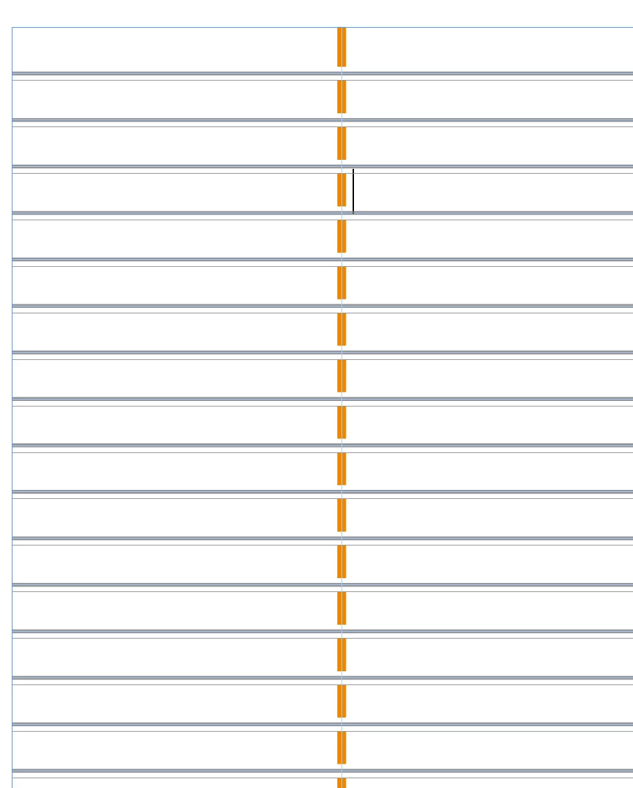

Jun 17, 2025 12:26 AM UTC
I'm so close to getting this but I'm just not getting the gaps in still, I just can't for the life of me figure this out!! I don't suppose you could have a look at this .indd file and see where i've gone wrong?
Dave Creamer of IDEAS
Jun 17, 2025 12:55 AM UTC
Here you go.

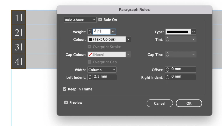

Instead of this you could try using paragraph rules for the Numbers
Normally they sit above or below - but you can offset the rule to the right and increase the pt size
Keeping them all even - you can then use a Paragraph Style going forward to make any global changes.
