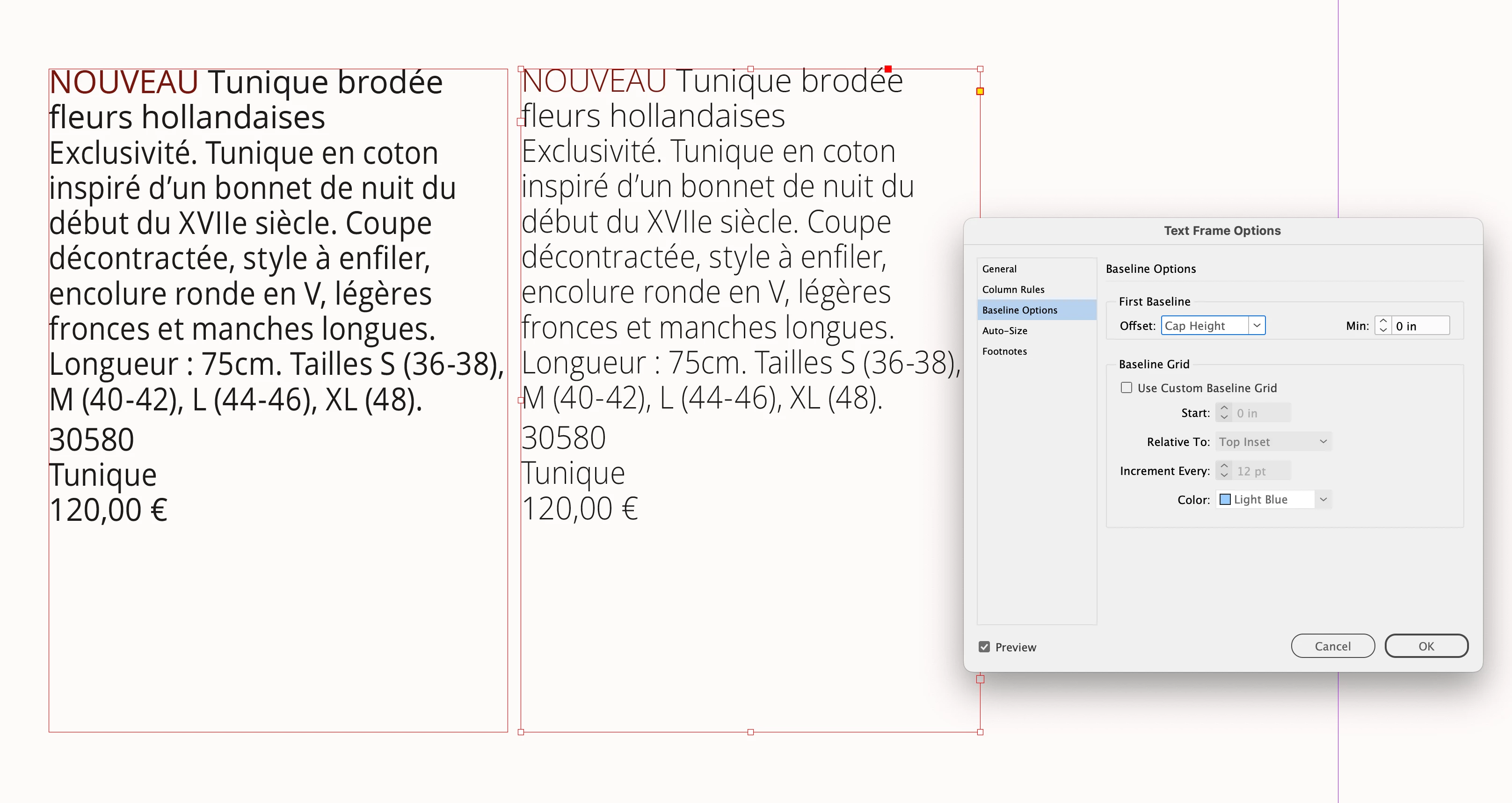

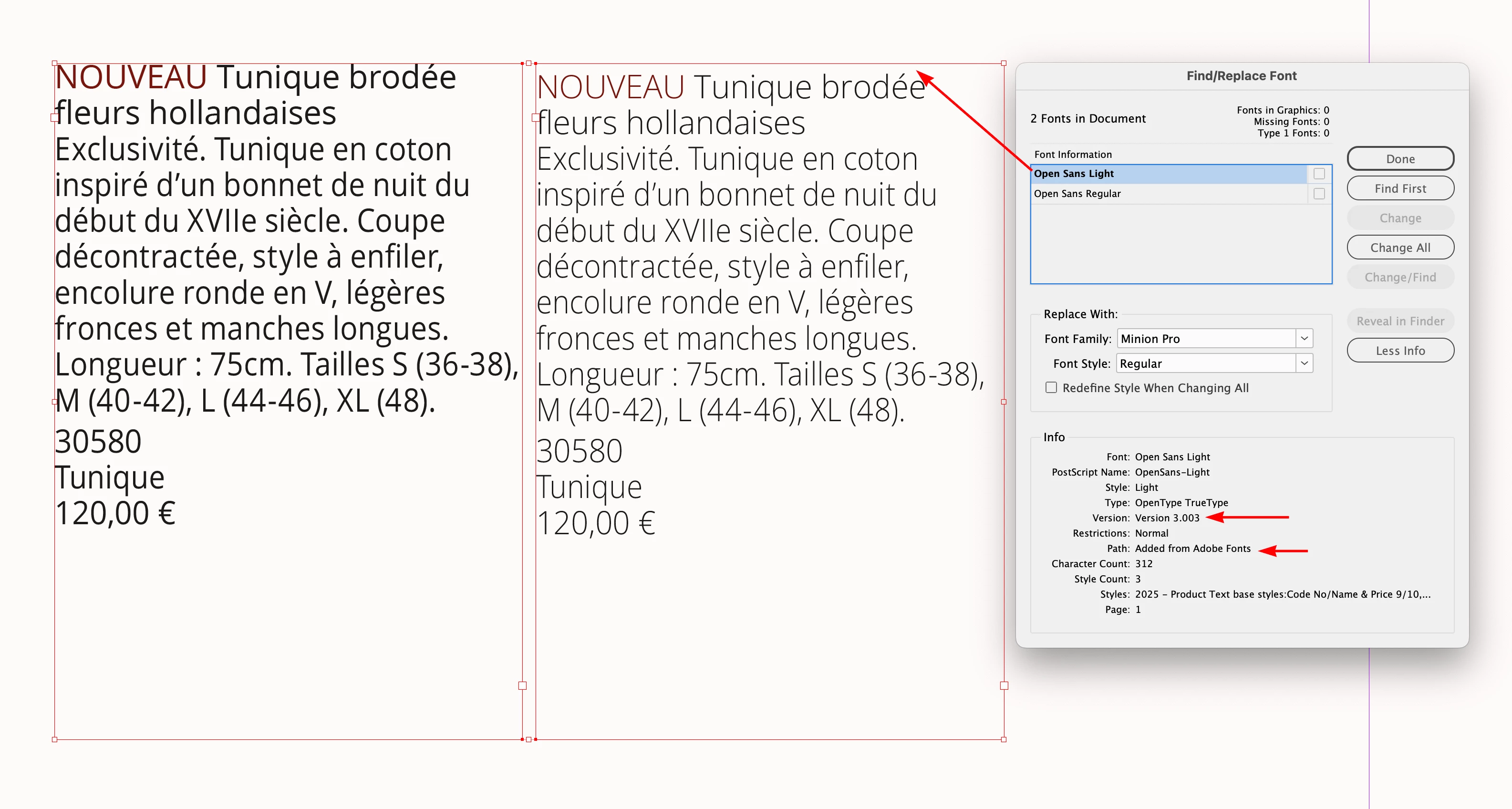

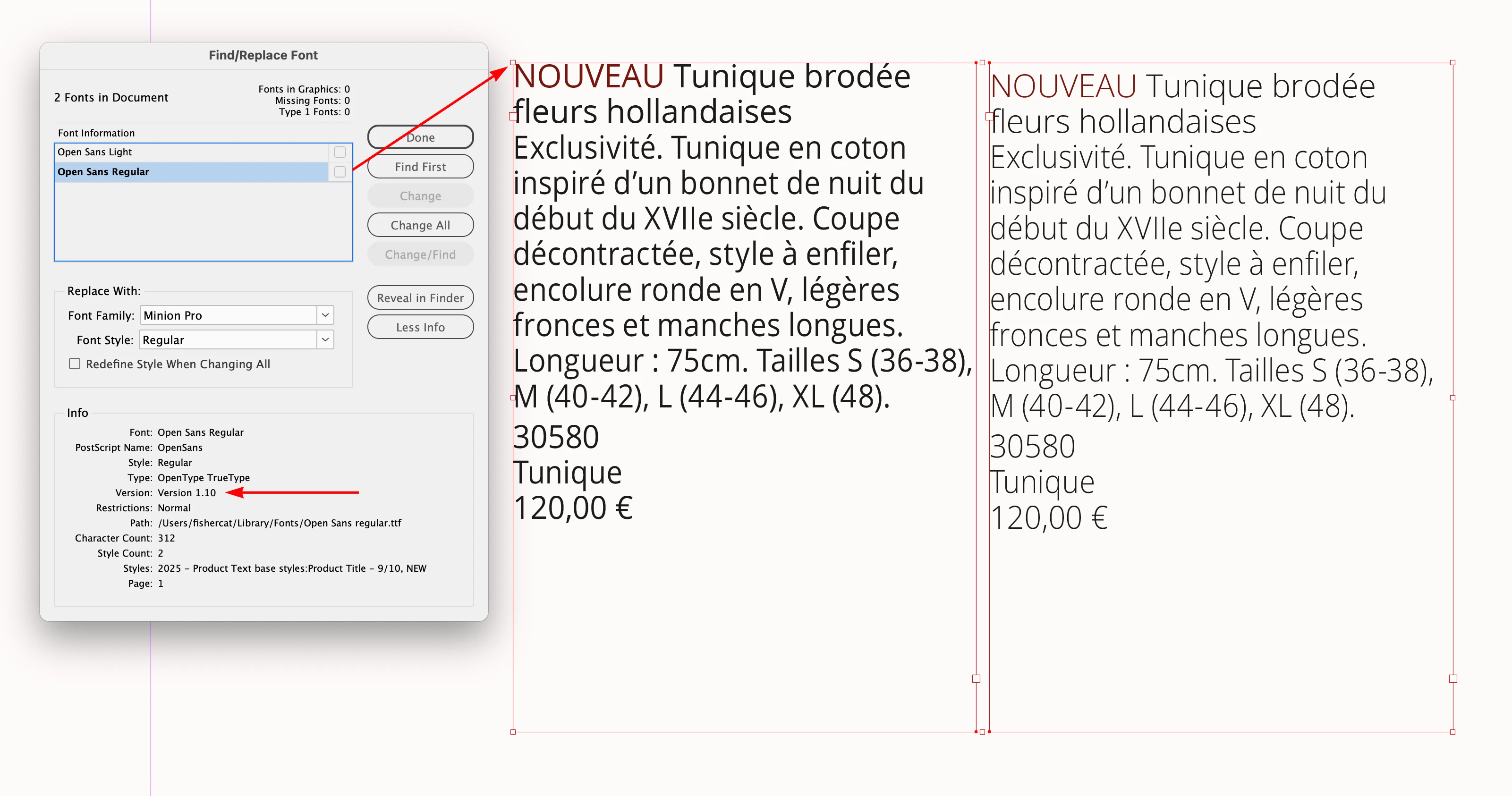

    Right the different font version problem could happen with Open Sans, which is a Google font. Google now offers a free variable type version, but there is also an older .ttf version—Find/Replace Font lists it as Version 1.10, Adobe’s version is 3.003. I’m guessing your client has the Google version installed in their system:
    If you need to stay with the Adobe version of the Google font, the simplest solution might be to set all your document’s Text Frame Options First Baseline Offset to Cap Height. If you are not using Object Styles and there are a lot of text frames it could be scripted—see attached:

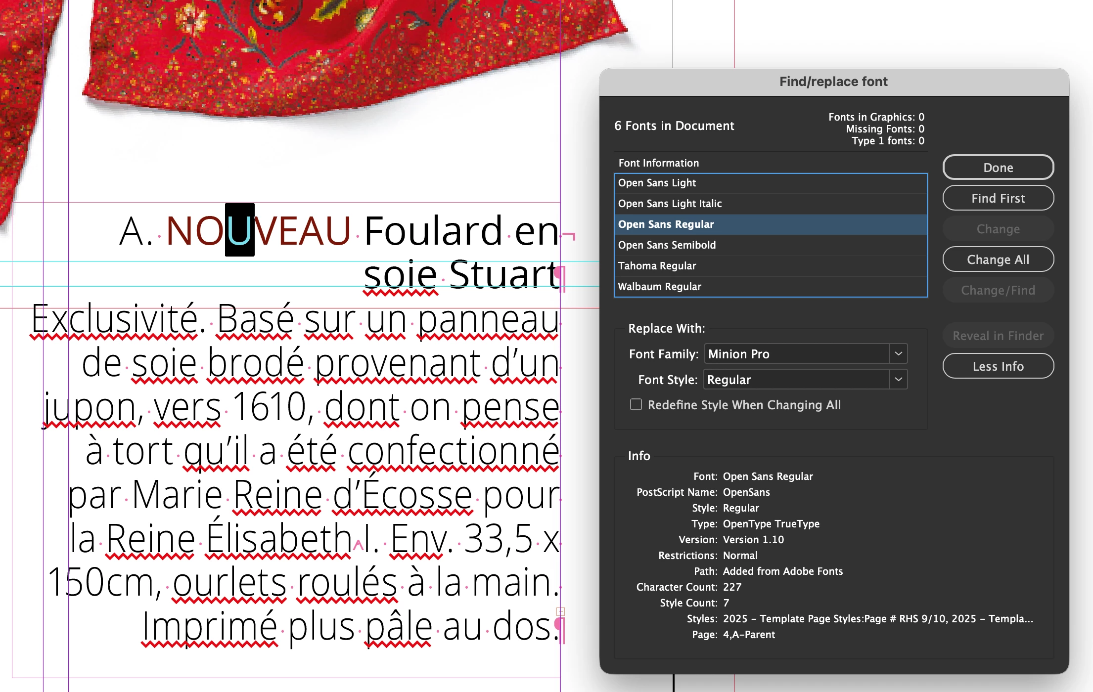

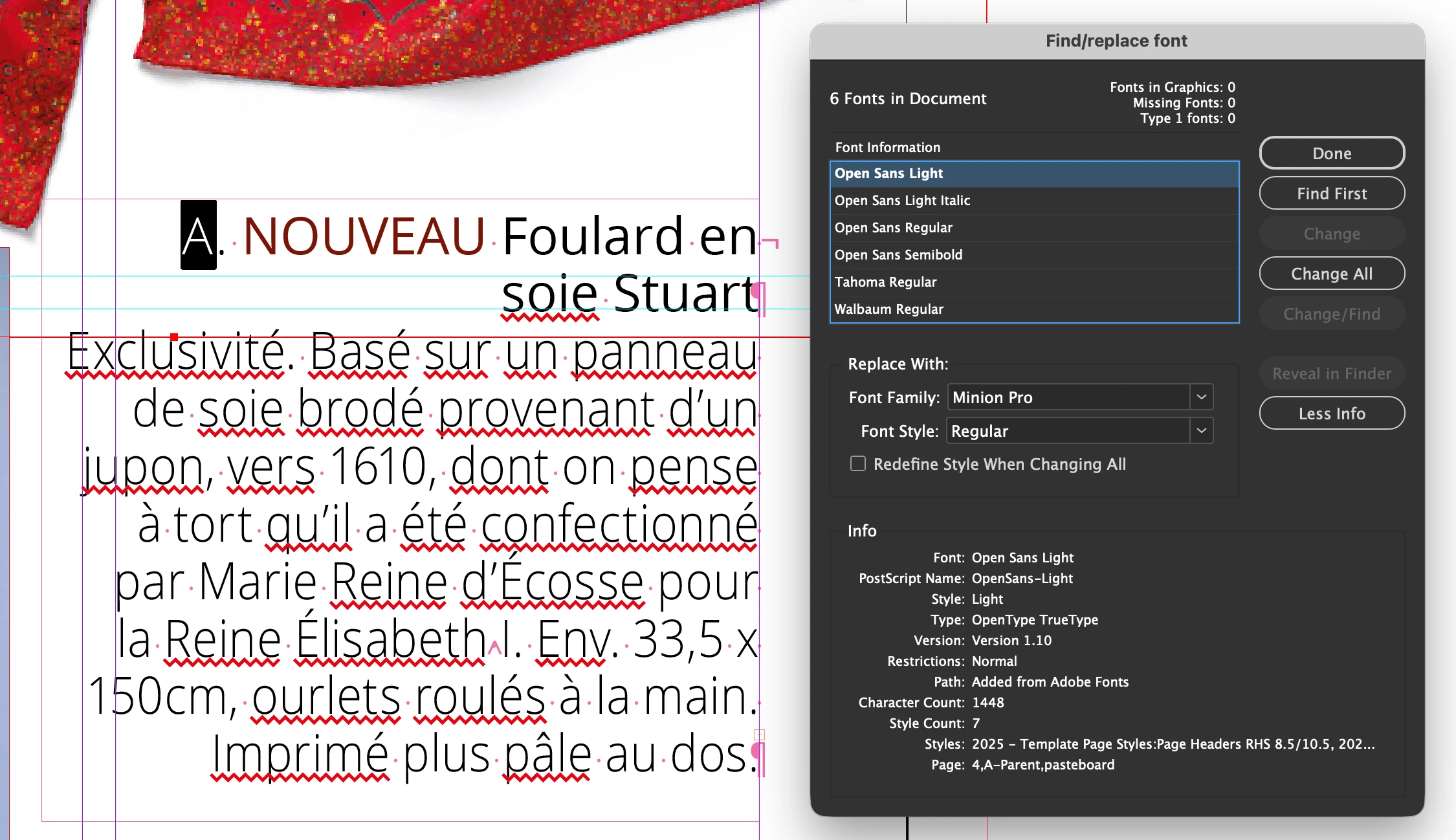

    thank you Rob, certainly looked like it was the answer to a lot of pain, unfortunately having looked at the font information dialog box to try and resolve this, I have a curve ball for you - mine is saying it is version 1.10. Any advice - thanks in advance
