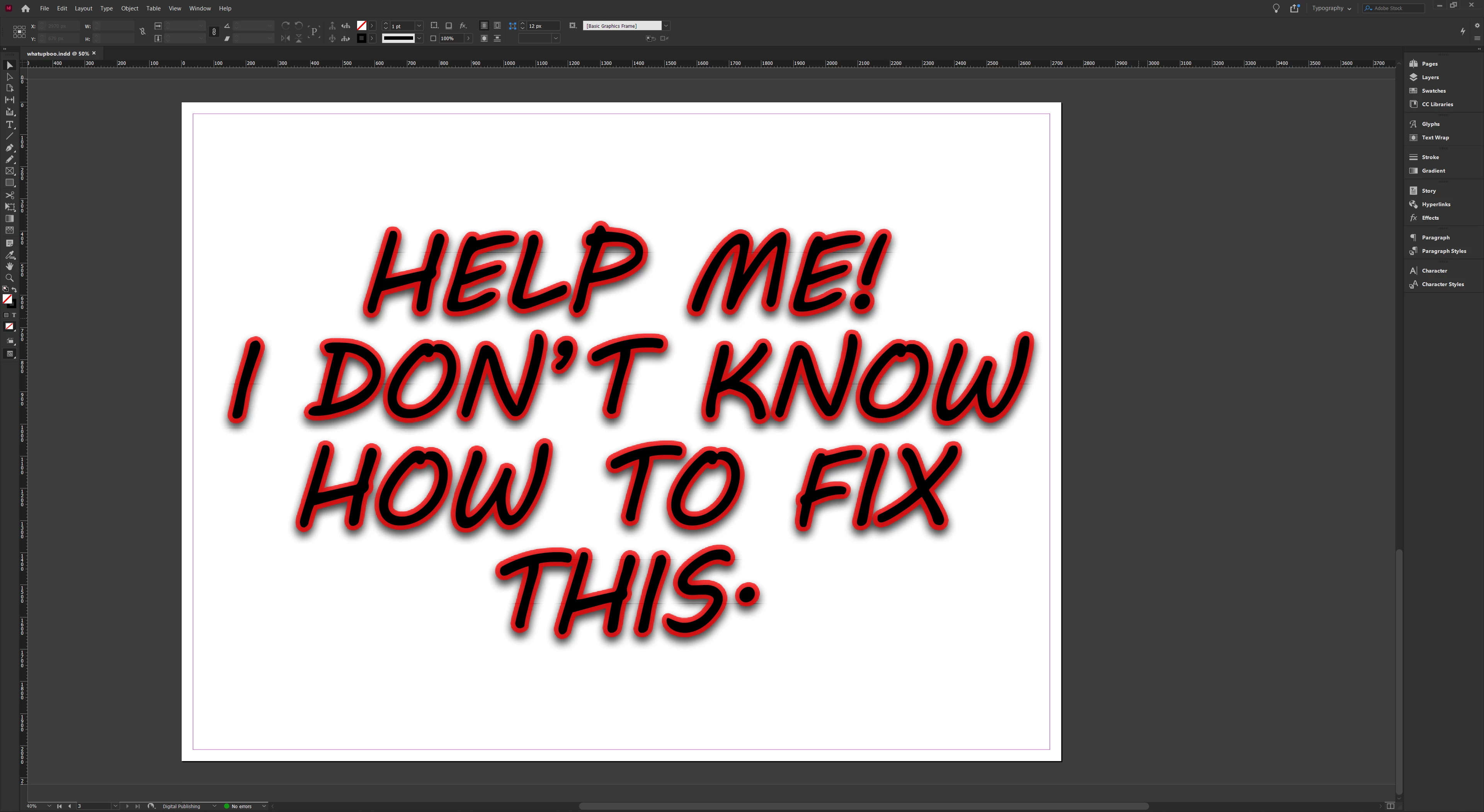

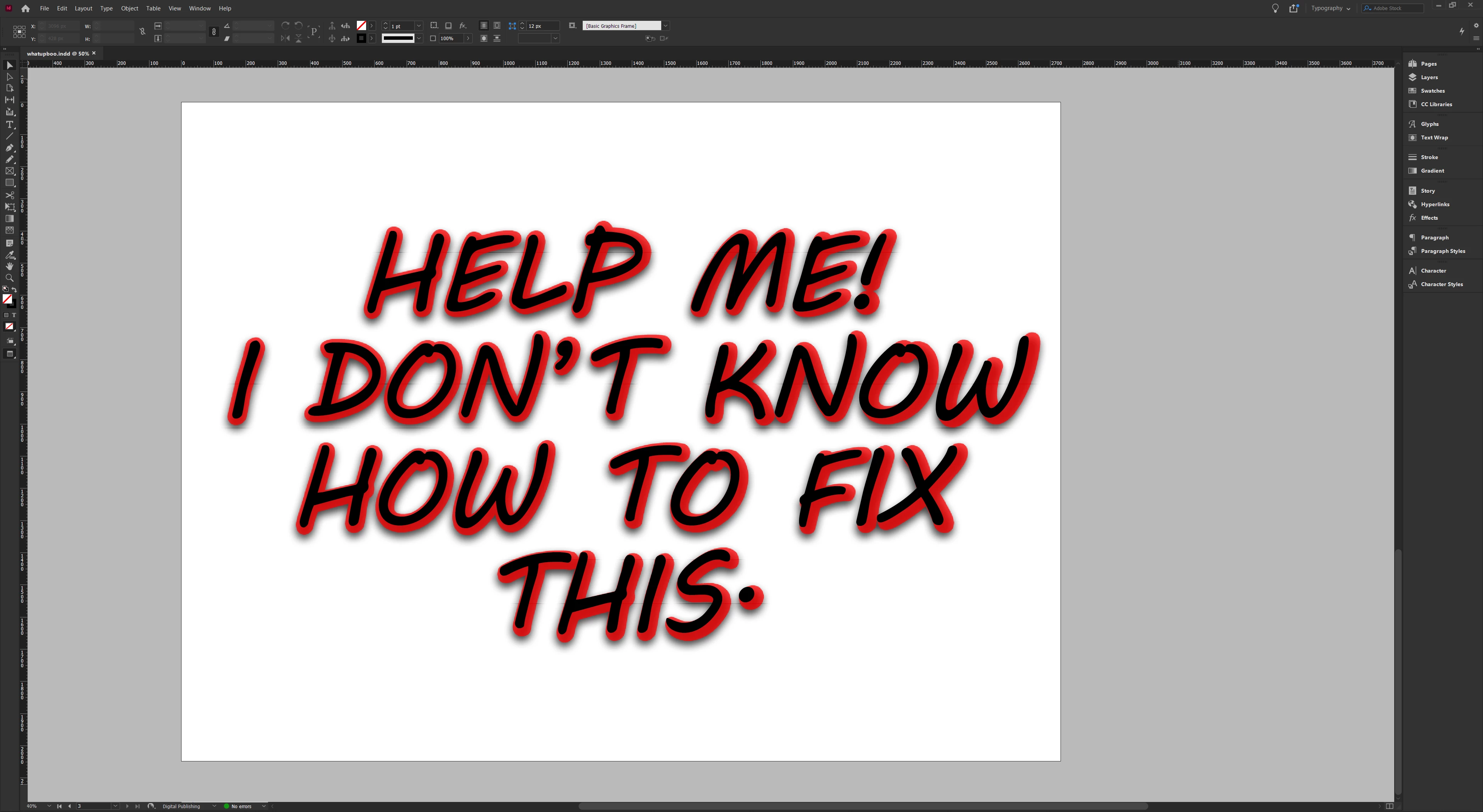

1) text elements with effects applied will display strange strike-thru lines which disappear and re-appear if I scroll the affected page in and out of the viewable area.
2) but much worse: applied text effects will only show in active screen mode but never translate into any alternative screen mode selected e.g.  when typically switching from NORMAL to PREVIEW the effects show incorrectly as if offset and with added thickness -> please see attached images. This also happens the other way around: when working in preview mode, applying effects and then switching to normal mode.

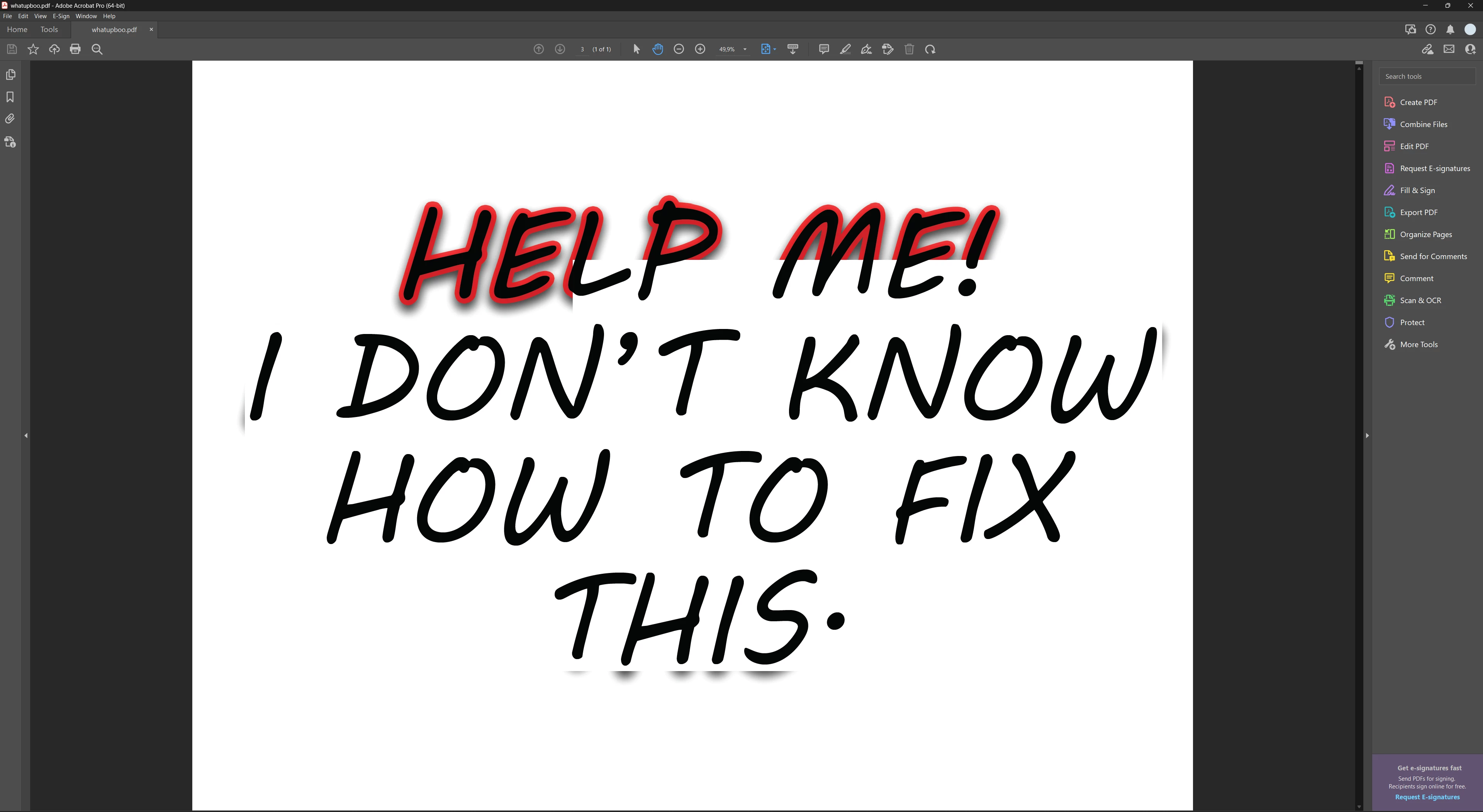

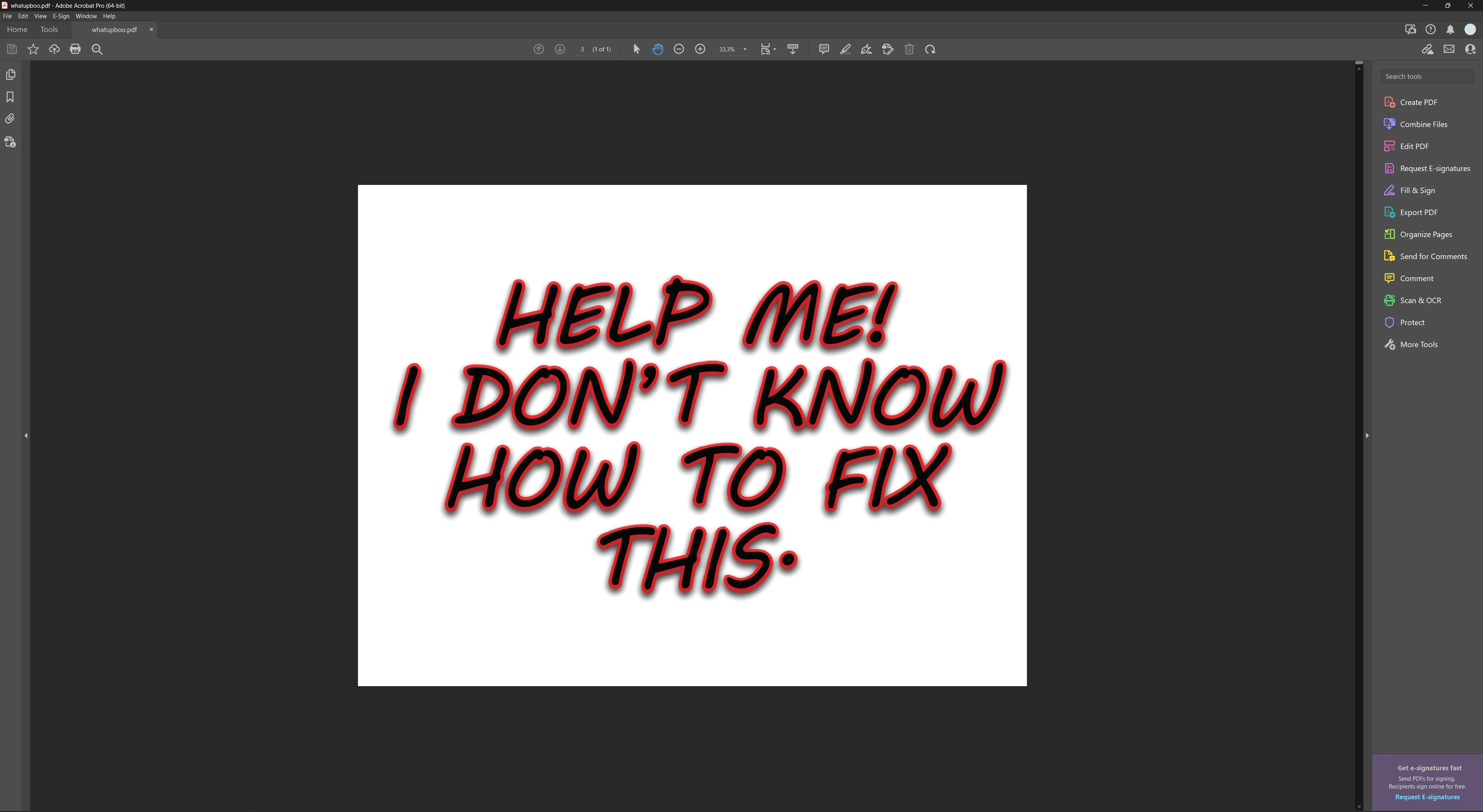

Also, since you mentioned PDF behaviour;
The PDF export looks correct on first open but on first zoom it looks corrupted, then on second zoom ok again and breaks on the next, so basically every other zoom level breaks. I attached images for reference.
