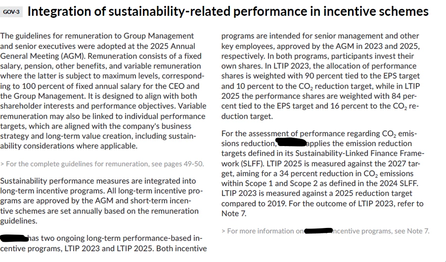

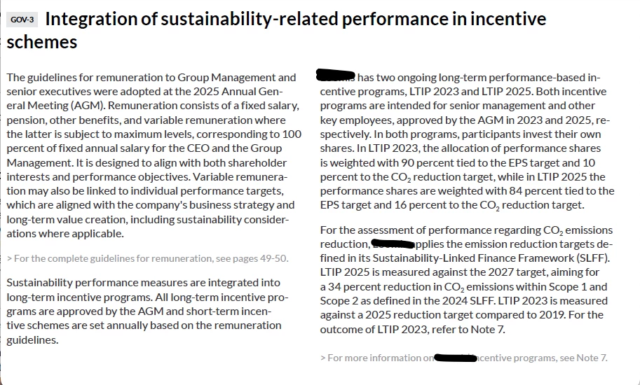

    tinas39366092
    Mar 3, 2026 4:06 PM UTC
    Screenshots attached! It is my computer causing the different line arrangement, and now I tried opening in InDesign 21.1, with the same result. Several other people can open it with correct adjustment in ID 2025 (have to check their specific version), it’s only me who has the problem.
    I’ll try updating aswell, but since 21.1 gave the same result, maybe it’s not that much to hope for.
    the screenshots: ”16.55.18” is the correct one, ”16.55.19” is mine.
