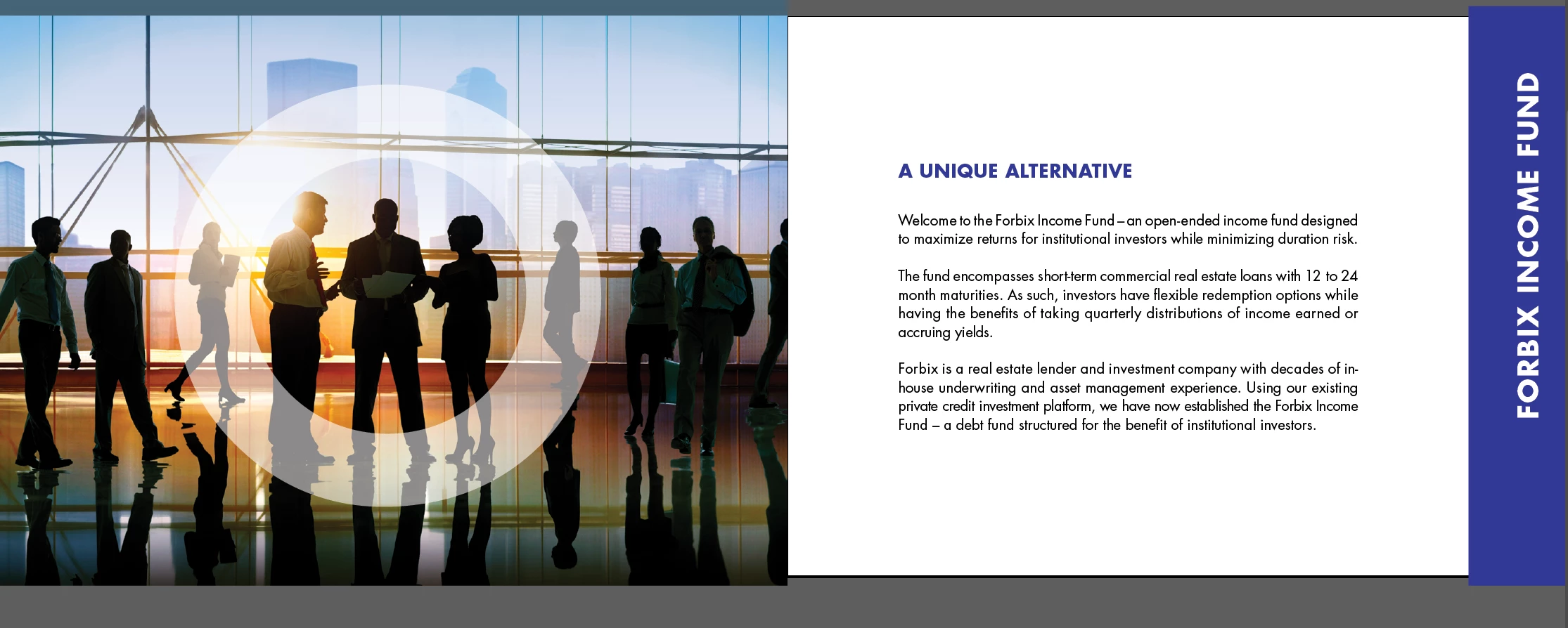

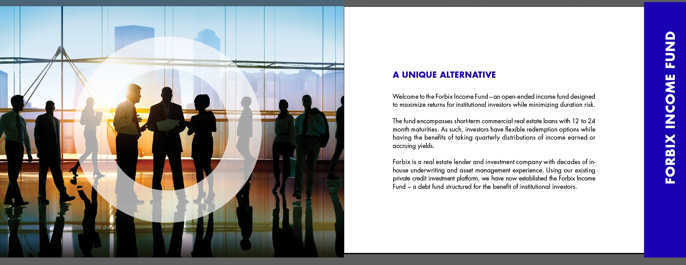

Hi, I'm trying to prepare an InDesign file to print offset that has transparencies. When I set the transparency blend space to RGB, the colors looks bright, but when I set it o CMYK everything looks dulled. I've been looking at tutorials, and am baffled.
Is it somthing to do with other color settings?
I don' really know much about that.

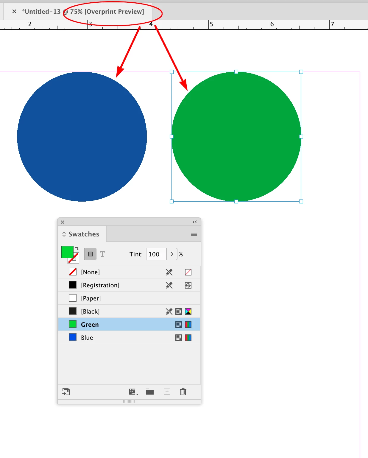

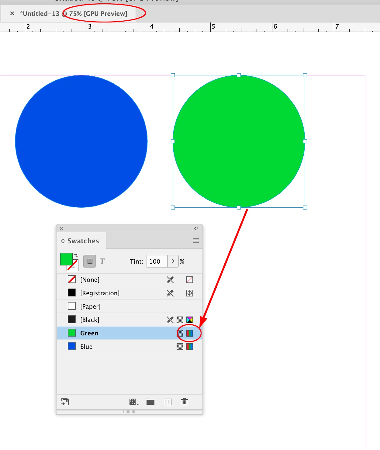

Hi @askinnn , Whether you are using transparency or not, for print output you’ll need to turn on Overprint/Separation Preview for an accurate print soft proof:
