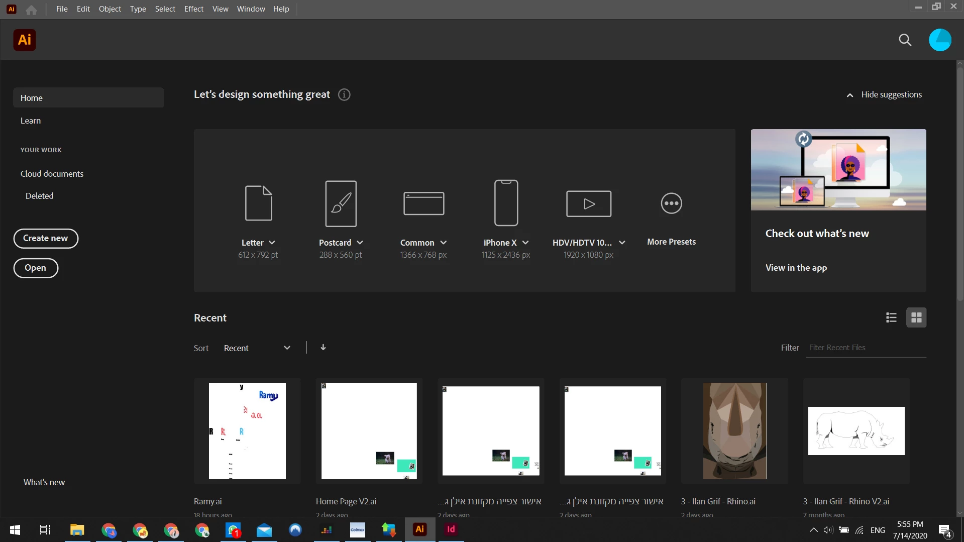

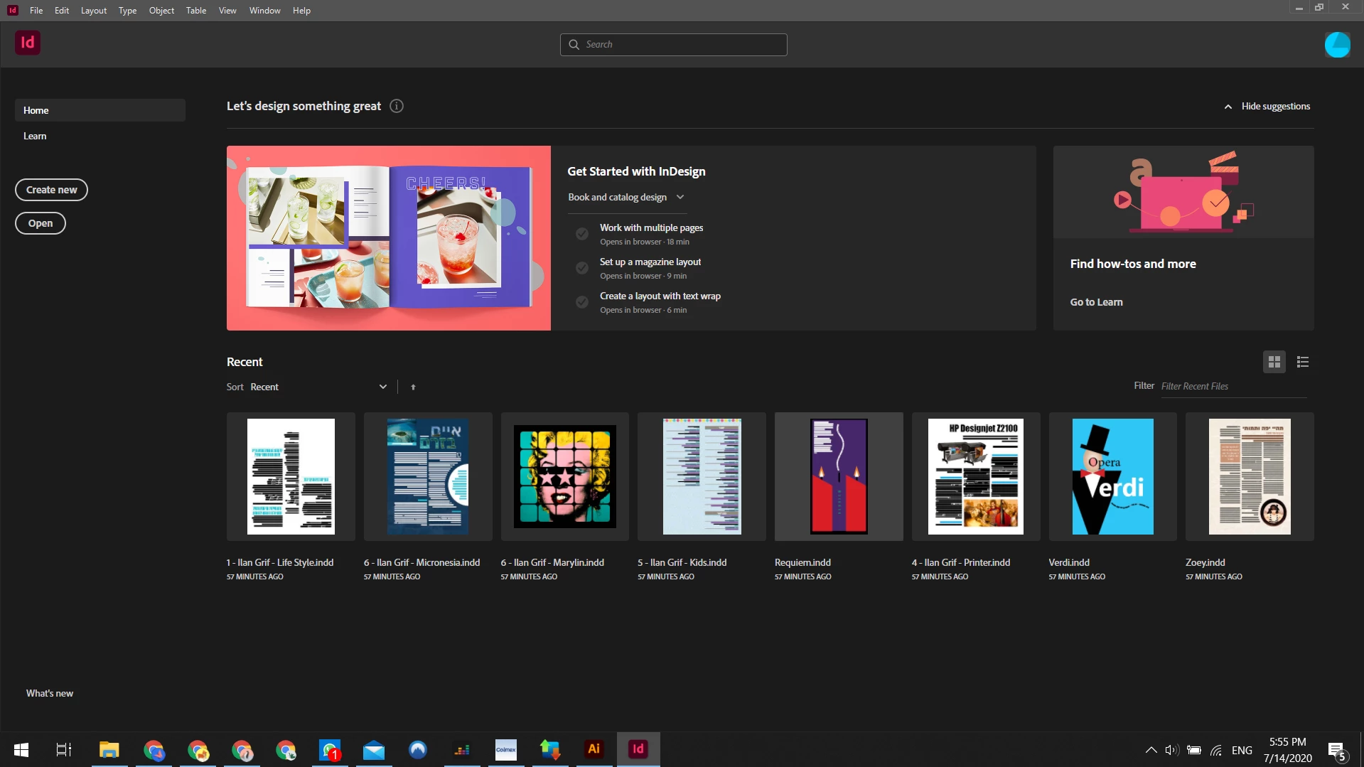

I have been searching for a while and couldn't find a solution for this issue, maybe I just missed it but it is not possible to work with such a small UI that I can barely read the letters.
For comparison I added the opening screen from Illustrator and also InDesign, whenever I open a setting it is so huge I have to move it from side to side whenever I try to use it because the software thinks my computer has a bigger screen for some reason.
Images:
https://ibb.co/D9r7PcZ
https://ibb.co/W6pCk1S

From your screen captures, I can see you're on Windows.
And yes, the UI is phenominally miniscule on high-resolution monitors running Windows.
And yes, it doesn't happen when running Illustrator, Acrobat, or Photoshop on the same monitor.
