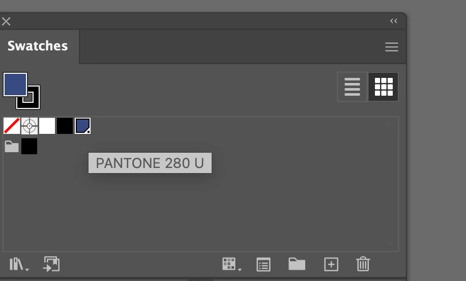

    Hijacking this old post incase anyone is still looking. Is it a spot color used in a placed graphic? You have to open the graphic and delete the swatch from the Illustrator panel and re-place the graphic in Indesign. 
    In INDD Copy graphic / Cut / DELETE THE SWATCH / then paste in place (Graphic), it will place it without carrying the swatch name from Illustrator to your Indd swatches.

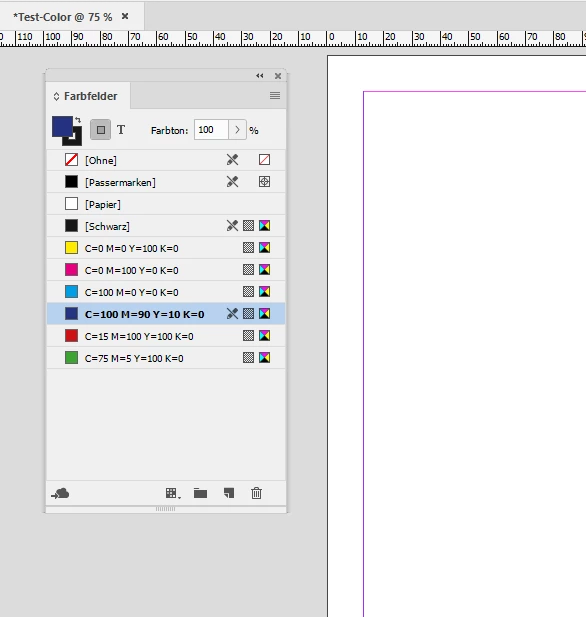

    Here a weird example where I set a false for a true with attribute ColorEditable in Graphic.xml for one of InDesign's default swatches:
    And here the same where I changed ColorRemovable to "false" to the same swatch.
    As you can see now the trash bin is grayed out when selecting the swatch:
