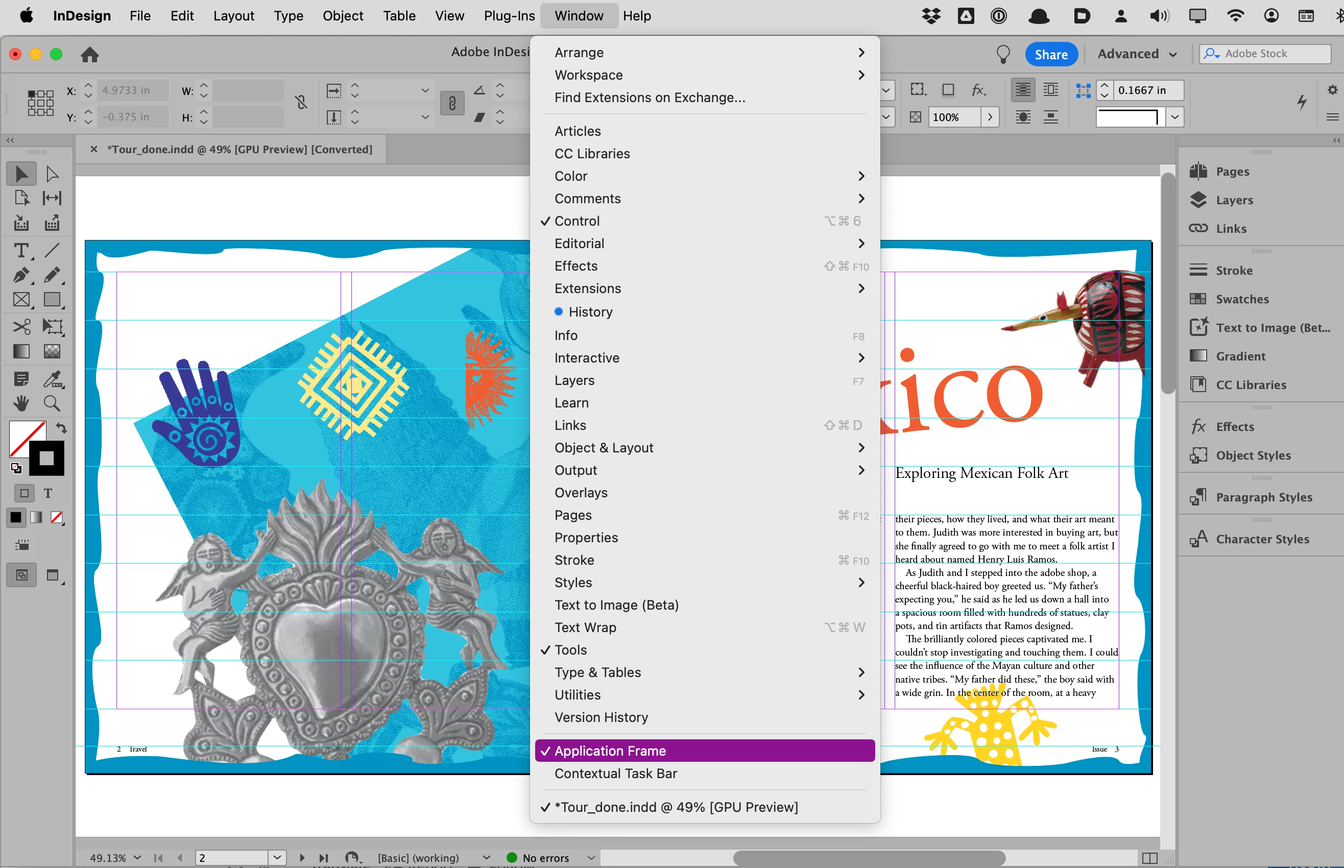

If you're "floating" your InDesign window on your screen, it's unlikely InDesign will be able to remember the size the of the window after you go into Presentation mode.
Instead, create a "fixed" InDesign window by turning on Window > Application Frame. In that mode, InDesign controls the window size, and it will return to the same view after uisng Presentation mode:
