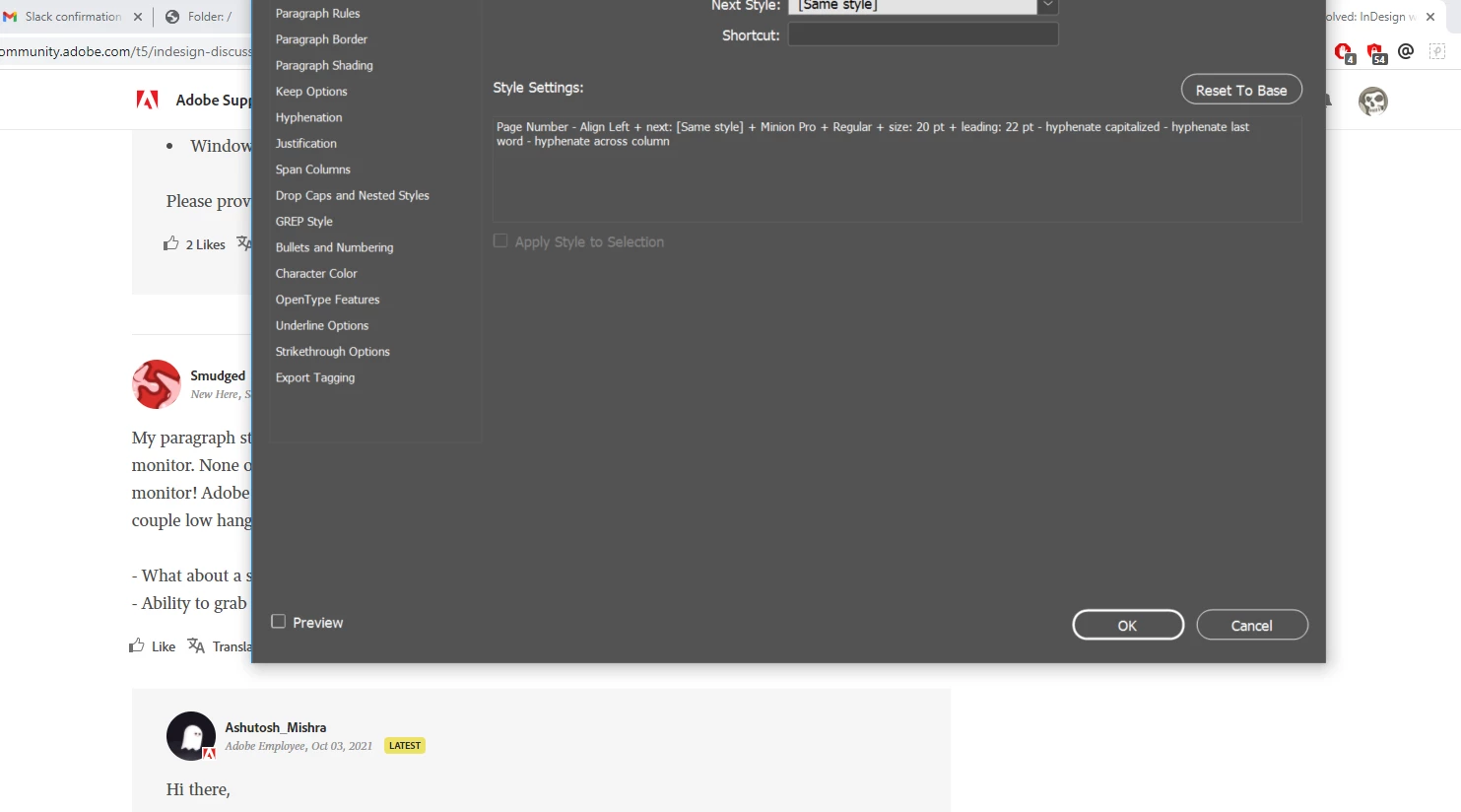

My paragraph styles dialogue box was the issue, its a tall one... and all I can see is the bottom of it on my alt monitor. None of the above options fixed the issue. The only thing that worked was going back to the previous monitor! Adobe lets get this fixed. My AD isn't stoked I found another reason to head home early... Here are a couple low hanging fruit solutions:
- What about a simple 'gather pallettes' option?
- Ability to grab pallettes from all four corners?

Oct 4, 2021 12:54 AM UTC
Hi there,
Sorry to hear about your experience. You may try the InDesign Prerelease build by following the steps on this community post & see if that helps with your concern.
Ashutosh
