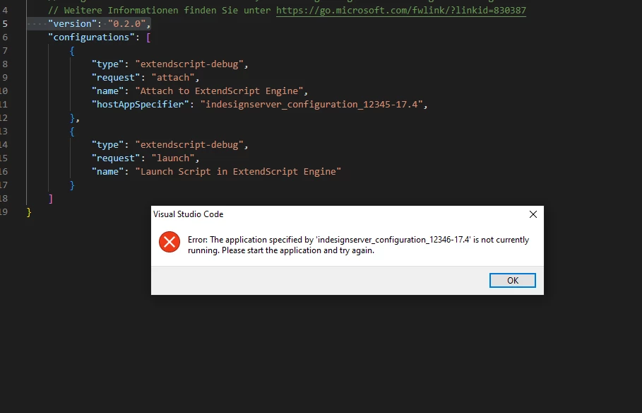

Hello, we are having some problems with our Indesign Server which gets all Files that are stored on the Server and render itafter than to  complete new PDF. Now were coming to an Issue that one File will not be imported (it stucks). We builded another IndesignServer for Debugging and wanted to try the Debugtool ExtendedScript Toolkit, but it seems its not working properly, the debug server runs but the tool does not find the server even if i attach the correct version of the server. So all in all it will not work...

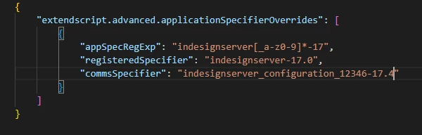

Hey thanks for fast reply, yeah im already using the vsc extension, but i often dont work with VSC, so its a bit new for me. How can i execute the command on an new Instance, because we have the problem our server which is installed is 17.4 but with estk the server versions are restricted to 17.0 and to attach a new serverconfig in the .json does not work.
