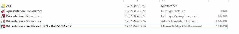

There have been reports of INDD files being associated with Acrobat but you've given us zero information to be sure. First, please supply screenshots of Finder or Windows Explorer showing the files in question and before you do that, make sure you have the display of file extensions available.
My guess is you'll see these are INDD files but the icons will show Acrobat. You'll need to re-associate the INDD file extension with InDesign.

My answer stands. Please follow my directions and enable the file extensions and you will see that these are not PDFs.

it looks like this -
[cid:626fac98-8687-41e0-ba97-3c30467d1a08]
