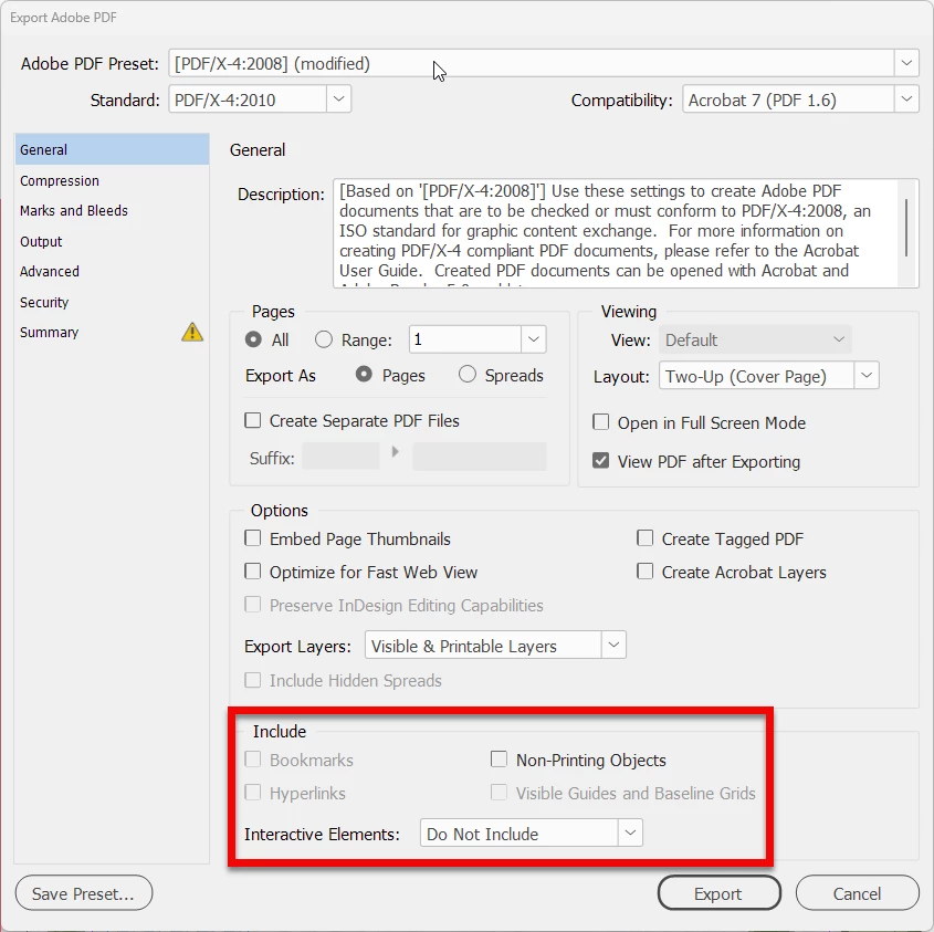

BobLevine
Nov 29, 2025 11:55 AM UTC
Does it work if you export a Print PDF? Hyperlinks can be included by making the proper selection in the export dialog.
