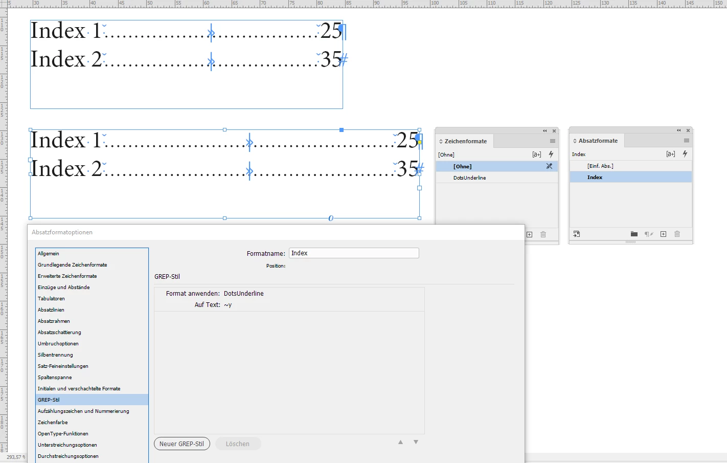

Hi cryptoref,
alternatively use ^y as entry separator if you want a RIGHT INDENT TAB special character.
Perhaps also add a small white space before and after that character. Maybe a THIN SPACE special character like that:
^<^y^<
That together with a GREP style in the applied paragraph style using an underline with dots could give you a result where the first dot does not start right after the number and does not end directly at the page number:
The GREP pattern for the RIGHT INDENT TAB is:
~y
