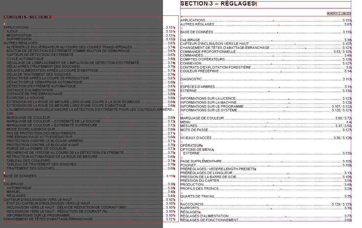

I think you have two different questions here. One is why the index is so different and two is why InDesign can't finish placing the whole index.
Have you spoken to the translators? I think I would start there. It looks as if they re-indexed the content and added subtopics. For example, Autres Réglages is a level 1 entry on both. The example on the left has a long list of subtopics and the one on the right doesn't have any. A good indexer reads the content, and determines what needs to go in the index and then adds the markers. There's no way we can know which one is right—someone working with you will need to make that determination.
The never-ending text flow is an InDesign issue. That kind of thing can happen if the keep settings or instructing InDesign to keep all the paragraphs together. If it isn't obvious, the quickest fix is probably to let one of us look at the index to figure out what is going on there. (I'm happy to look at it). I would start by looking at story editor to locate the end of the content. And then I would try to figure out why InDesign can't finish placing it.

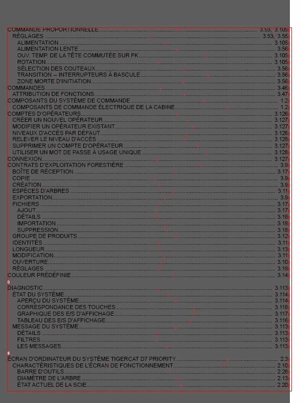

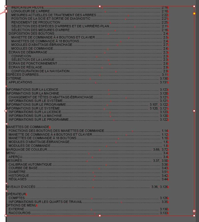

Hi Peter,
When I generate the index it replaces the original index with a much larger index.  As in, there are so many entries it seems to never stop being overset like you mentioned.  The original document only has 3 pages of index.
When i say multiples i mean that i can see some of the index entries have doubled or tripled.
