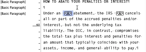

InDesign isn't going to index anything that doesn't have an Index Entry Marker.
You may have copy/pasted a "Chesapeake Bay" and inadvertently picked up the index marker to go with it. You can check your entry in the index through this process:

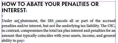

  • Navigate your way to page 2 of your index, where "Chesapeake Bay" appears on your page. (For the purpose of this response, I'm going to change the indexed item to "abatement" for my illustrations).
  • Get your Text tool and click into the text near your "Chesapeake Bay" entry. Then, go to your Type pull-down menu and select the Show Hidden Characters menu command.
  • This will show you the non-printing characters entered into your document — like tabs, paragraph returns, spaces and indents, etc. Including index entries, which would show up as carat characters below the text as shown in the instances of "abatement" and "cancels" in the illustration below. If you look very closely, you'll sldo see two blue dots like a colon right at the start of each word. That's the non-printing indication of an index entry marker in your text.
  • Technically you can edit it from here but it's very difficult. It's much easier if you use InDesign's Story Editor function. Go to the Edit>Edit in Story Editor menu command to see the index entry marker as a ancient thunderbird in a box, as shown below. It's also easy to highlight it in the Story Editor and delete it there than it is in your page layout.
