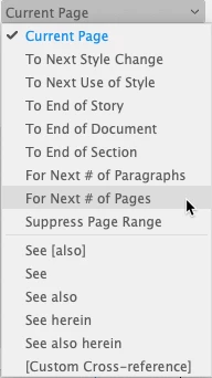

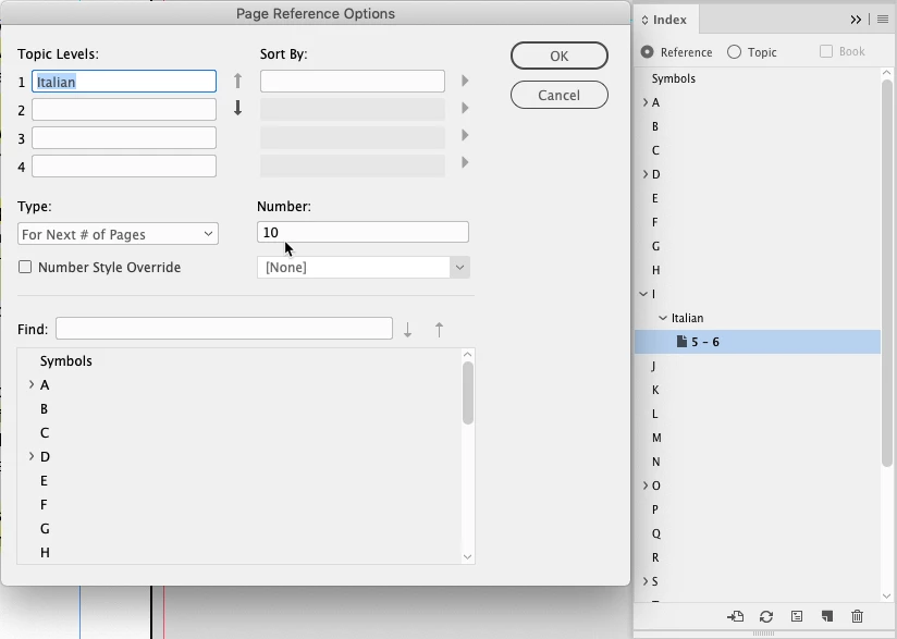

1. To go through your index entries, identify the ones you want to set with a range, and manually identify which index entries you've already made identify the start of a range of pages in your Index panel. This is the only practical way to edit index entries you've already made. Double-click on the entry to open the Page Reference Options panel, then go to the Type: options box and change from the default Current Page reference to the For Next # of Pages option. This opens the Number: edit box below, which lets you ener the number of pages in the range of pages you want to describe, including the page of the index entry. Using your "Theme 3" example, to define the range of "10-20" means that you would have to enter 11 in the Number: edit box, as shown in the second illustration below.
This will allow to identify a range of pages in the relevant InDesign document. Not the book. If you used InDesign's book functions to string together smaller InDesign documents, your page range references cannot be strung across them. For the InDesign document example I used below, the reference was for page 5 of a 256-page book. It doesn't matter if reference should cover the range between pages 5-14; since this document is only six pages it stopped the page range at pages 5-6.
