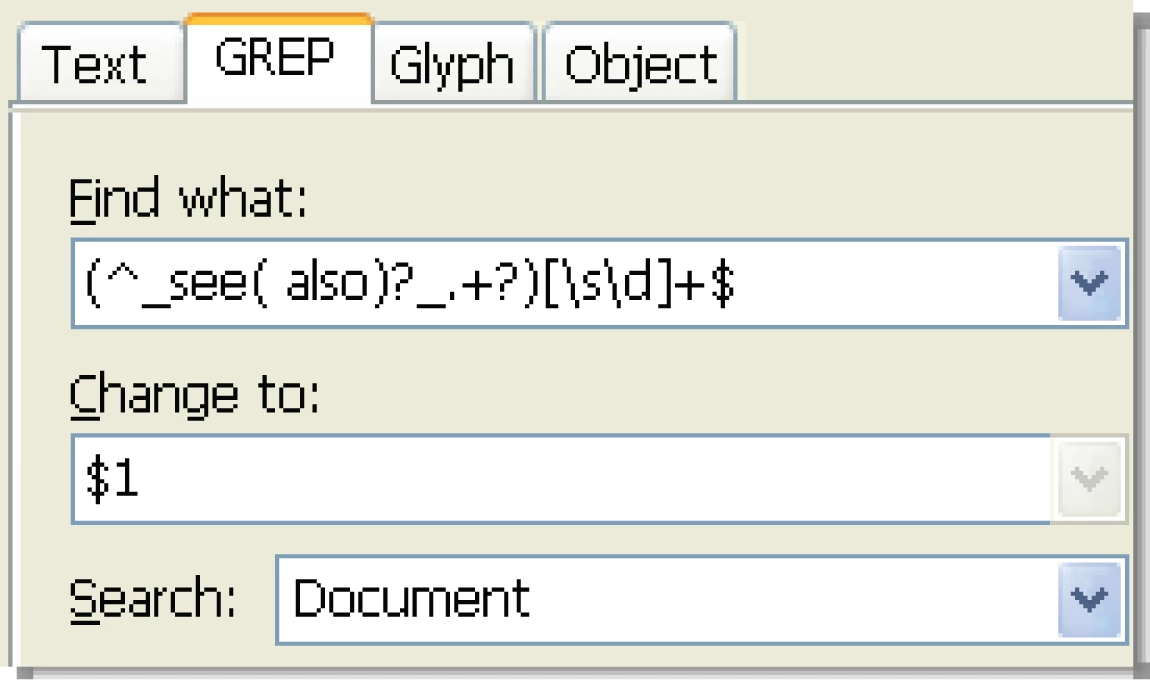

Correct answer Peter Kahrel
Sorry Jay, that should have been this (forgot about the z):
^z(_see( also)?_.+?)[\s\d]+$
To add italics to _see_ and _see also_, do this:
Find what: _([^_]+)_
Change to: $1
(and set italics in the "Change format" pane.

Peter,
Thank you so much for your solution and for taking the time to help. This time it is working perfectly.

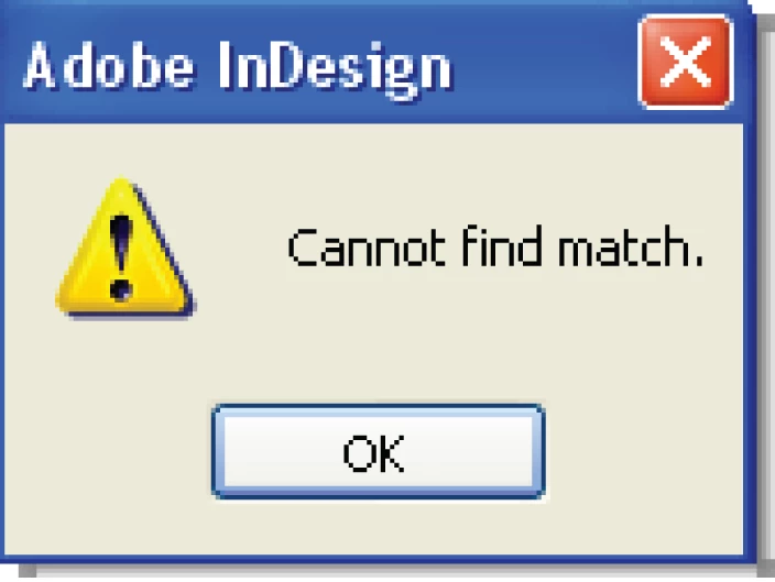

I very much appreciate your suggestion. It seems like it should work -- what am I doing wrong?
I get the following message:
The sample index looks like this:
The Find/Change looks like this:
