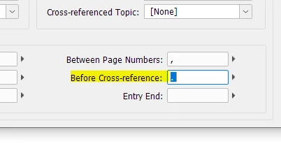

> there is no forced space between what people will look for and where i want them to "see". this is despite me putting a space after COPD

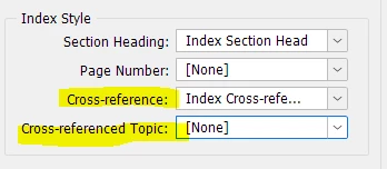

You set this in the Generate Index window:
> why isn't this nicely nested on the next line with a page number?
A cross-reference with a page number? If you mean, why are cross-references not on a new line, then the answer is that that's how Adobe thought it should be done., but it's just one of two styles. The one you're after can be done with a script, see https://creativepro.com/files/kahrel/indesign/index-fixes.html, under "See also cross-references immediately follow the topic".
> why is there no option to italisise?
You can italicise 'See' and 'See also' and/or the referenced topic in the Generate Index window:

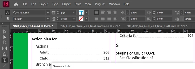

Ok the best i could do withour spending hours trying to figure out something that SHOULD be inately simple for an index is
 - The script suggested did little other than move text to next line
- Using the index style AND Entry spertators was the easiest way to "force line break" and "EM space" to look midly OK
pictures attached
posting picture intext here for some reason are low quality
 Would be nice and professional to finish this index with these "see" entries similar to all other entries e.g.
Staging of CKD and COPD
       See Classification of ......................................................455
