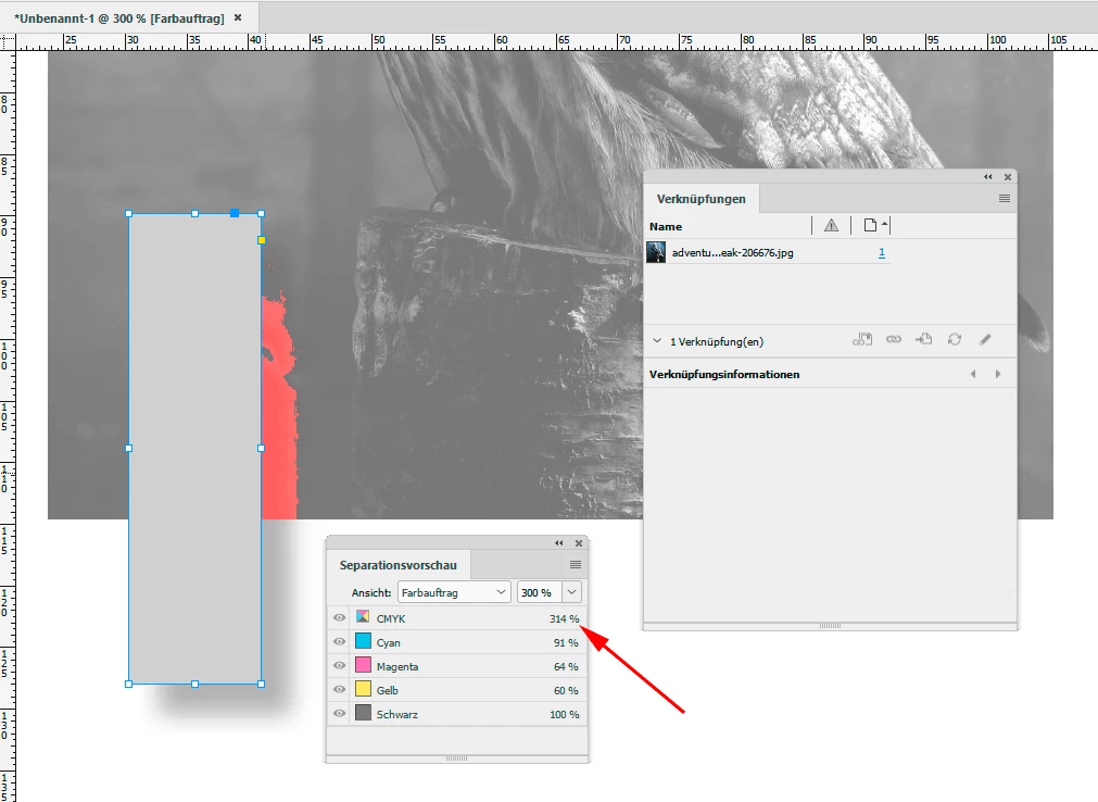

also note that effects like a drop shadow with rich black multiplied on other elements stacked above placed images can higher the amount of ink above 300%. Even if you are using tagged RGB images and use a profile like eg ISO Coated V2 300%.
And it can also depend on your PDF export settings what will happen with the colors.
So always check the amount of maximum ink with your exported PDFs also in Acrobat Pro.

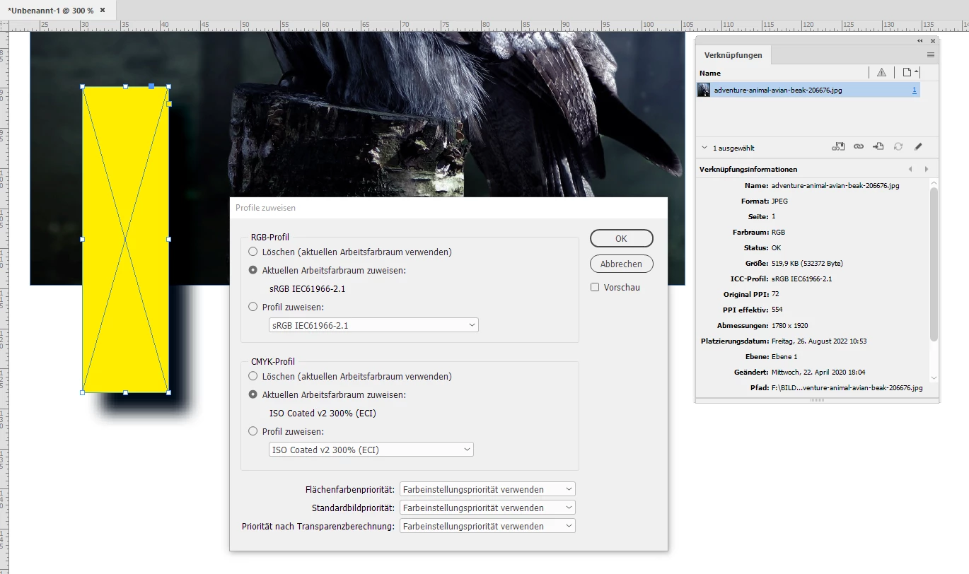

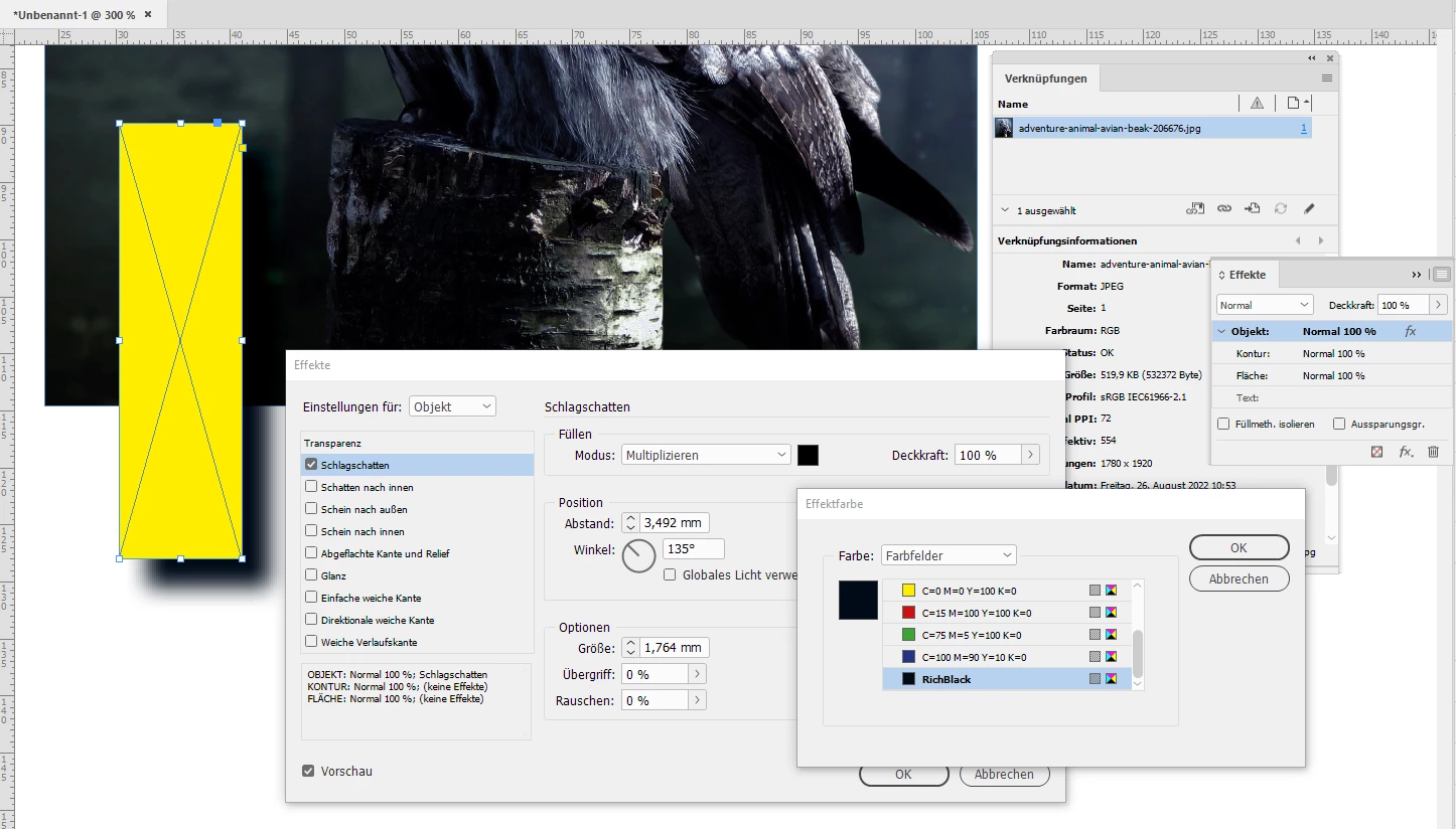

Screenshots below from my German InDesign 2022 where I used ISO Coated V2 300% for my document.
The applied drop shadow is done with a 100% rich black that consists of 60% Cyan and 100% Black set to multiply. The image below is an RGB image tagged with sRGB:

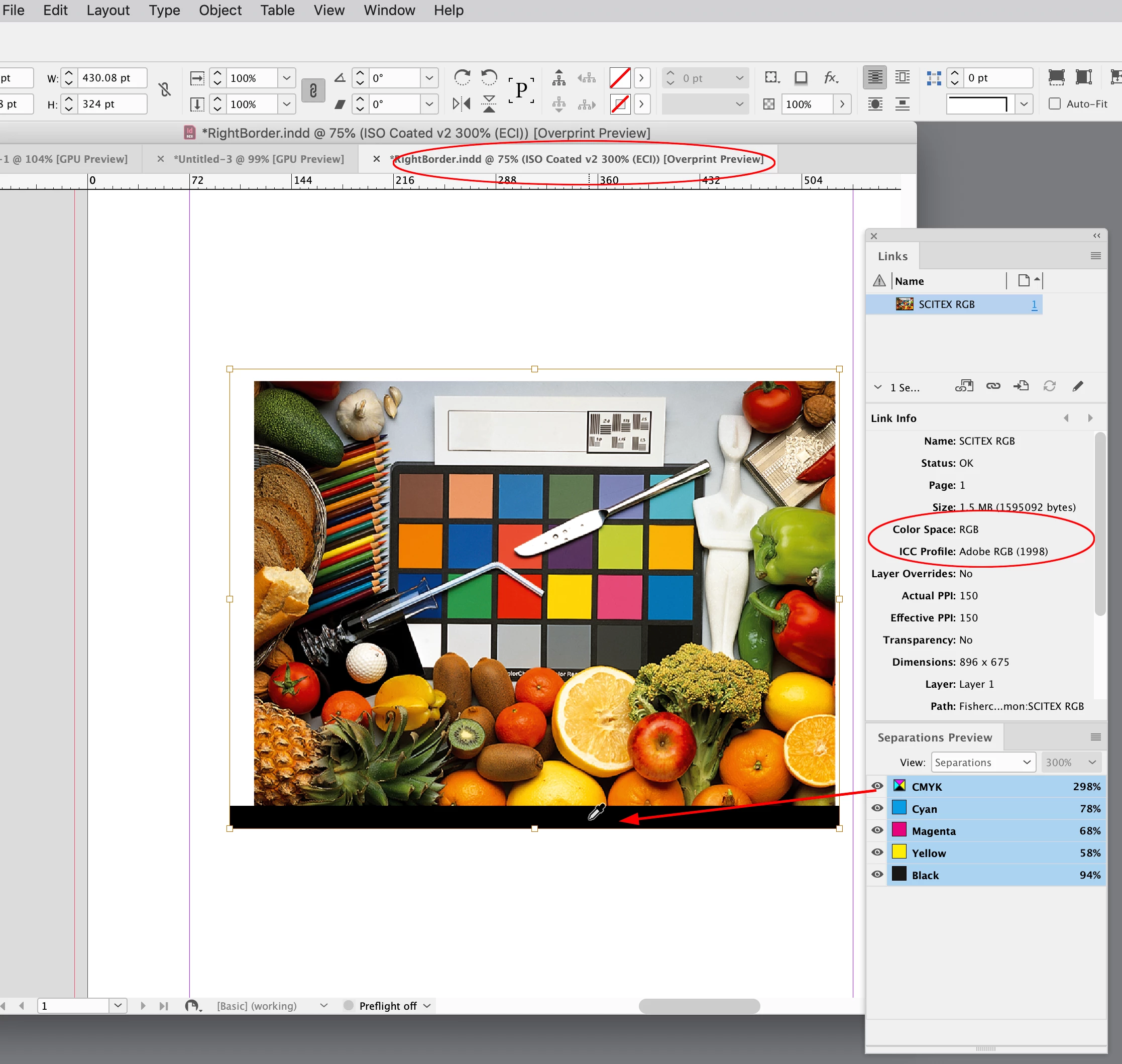

Hi @karlik57615243 , A CMYK image‘s total ink limit is built-in to the destination profile you use to make the conversion. So if you convert to a CMYK space like Coated GRACoL to total ink of the black point will be 330% unless you force an additional conversion into a different CMYK space with a lower total ink allowance.
For that reason it would be better to place profiled RGB images in InDesign and set your InDesign CMYK profile to a profile with a 300% total ink, eg ISO Coated V2 300%. Here I have a profiled RGB image in a document with ISO Coated as its CMYK profile assignment.

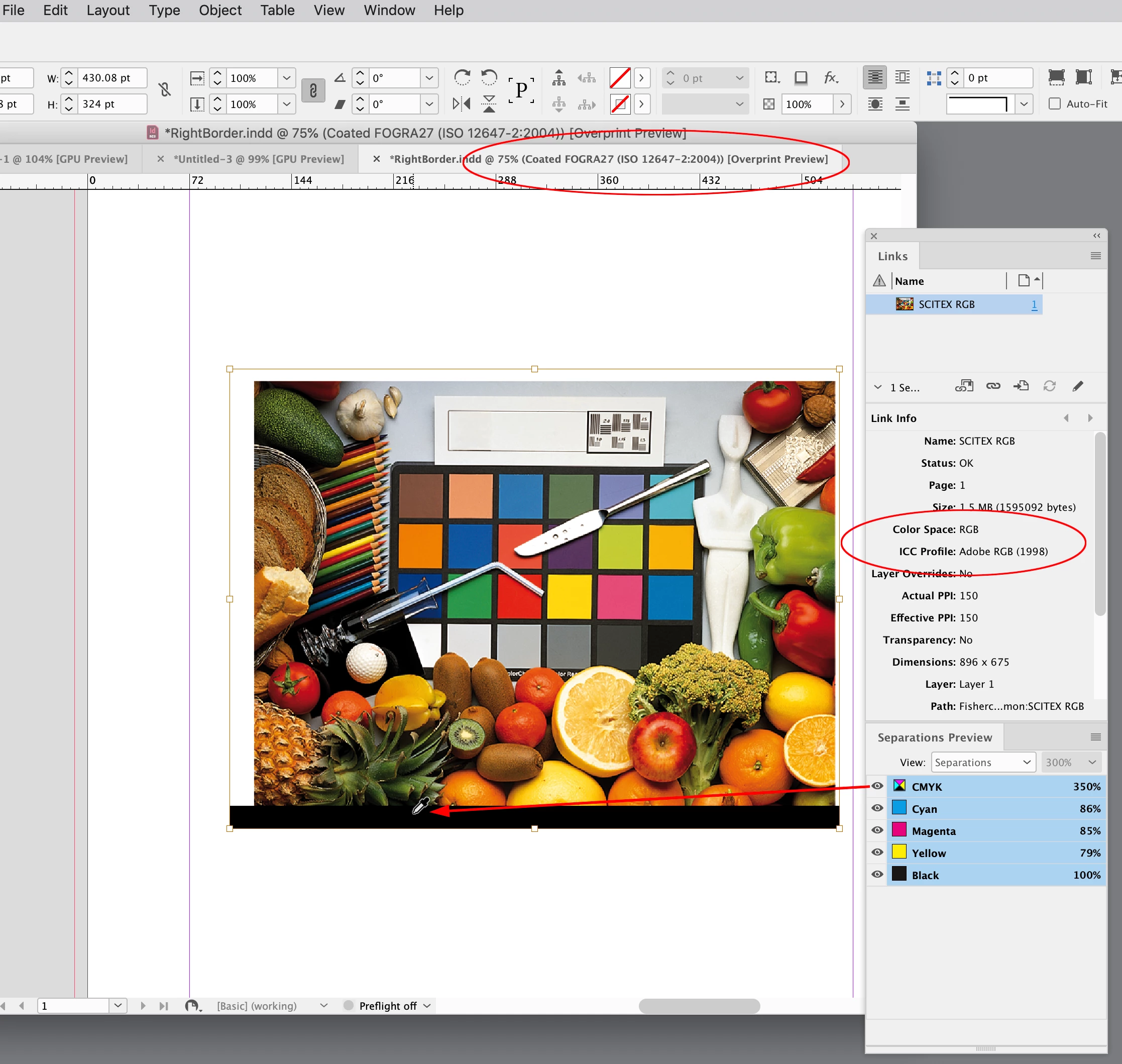

Here  my Document’s assigned CMYK profile is Coated FOGRA 27, which has a total ink limit of 350%, so the black in my RGB image is going to output at 350% when I export to that Destination profile
