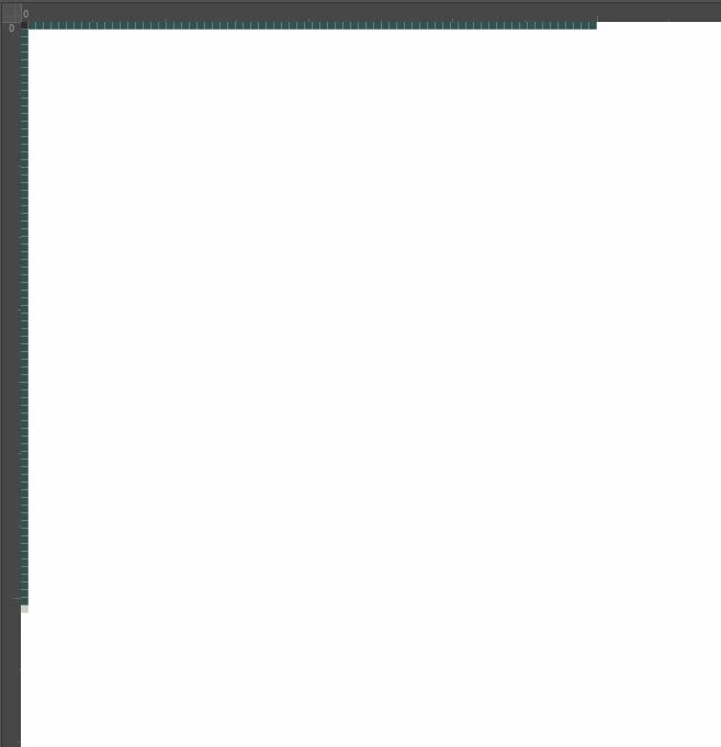

is it possible to automate the insertion of interior crops? By that I mean I want small keylines in the corners of some documents - see attached for an example. This helps us use less material sometimes when for example, we want to print two24" wide signs next to each other on 48" wide material, but need guides for cutting.
Maybe there's a way to add a box around the art, and only have a keyline around the corners? I couldn't find an easy way to do this.
