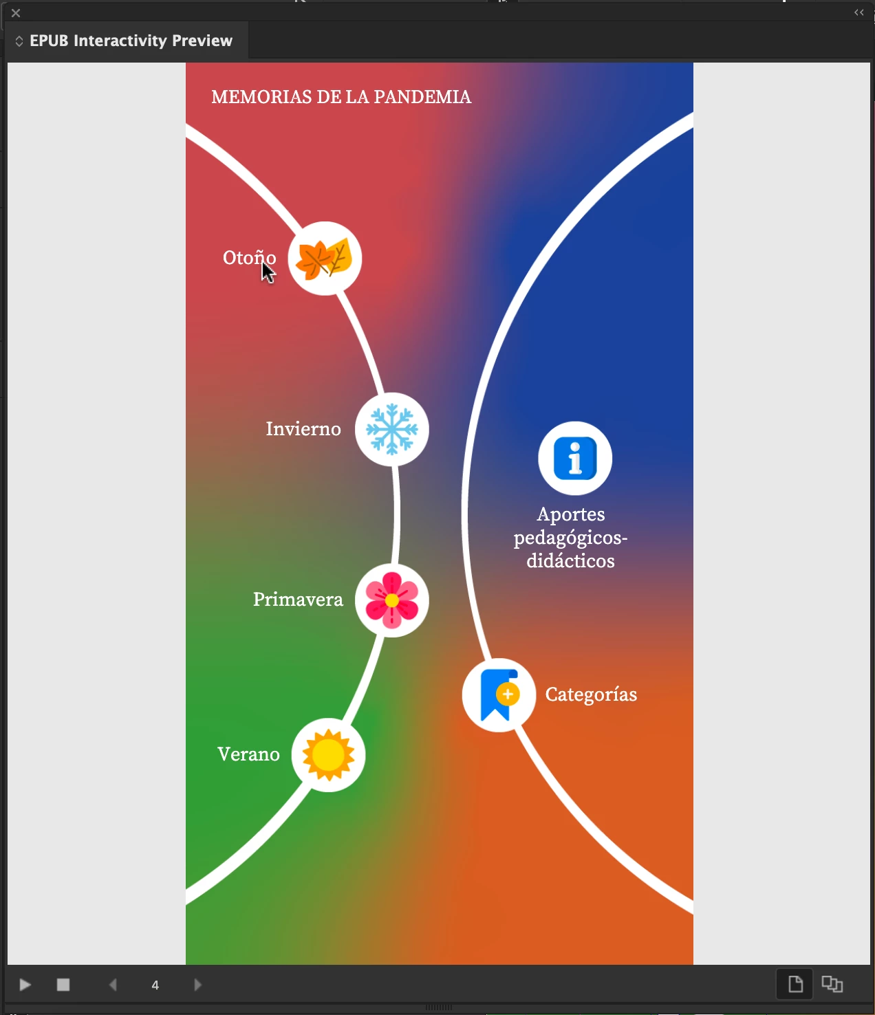

Hello! I've had some problems with button and interactivity when I publish online a Indesign 2021 project.

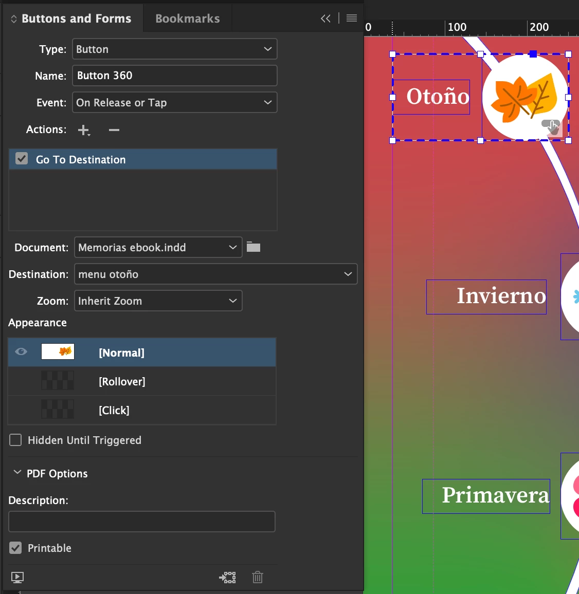

I've created a button (text and graphic group) and added an action. *Image below.
The issue is that when I plublish it online, button don't works.
Or simply, button don't have interactivity on its entire area/surface, just on a extreme.
Other elements loose their interactivity or effect (drop shadow) when it's publish online.
I thought this was due to file size or connection demand, but it's not something that happens with all the elements.
Someone have had a trouble like this?

Have you organised your interactive objects to be on top or in a separate layer that is on top of the stack?
Eric Dumas
Eric DumasCommunity ExpertCorrect answer
April 20, 2021
April 20, 2021
Well, I've re organize the layers on the file and it works!!!
Thanks you so much @Eric Dumas for your help.
I had tried many other things, but this one was correct!
