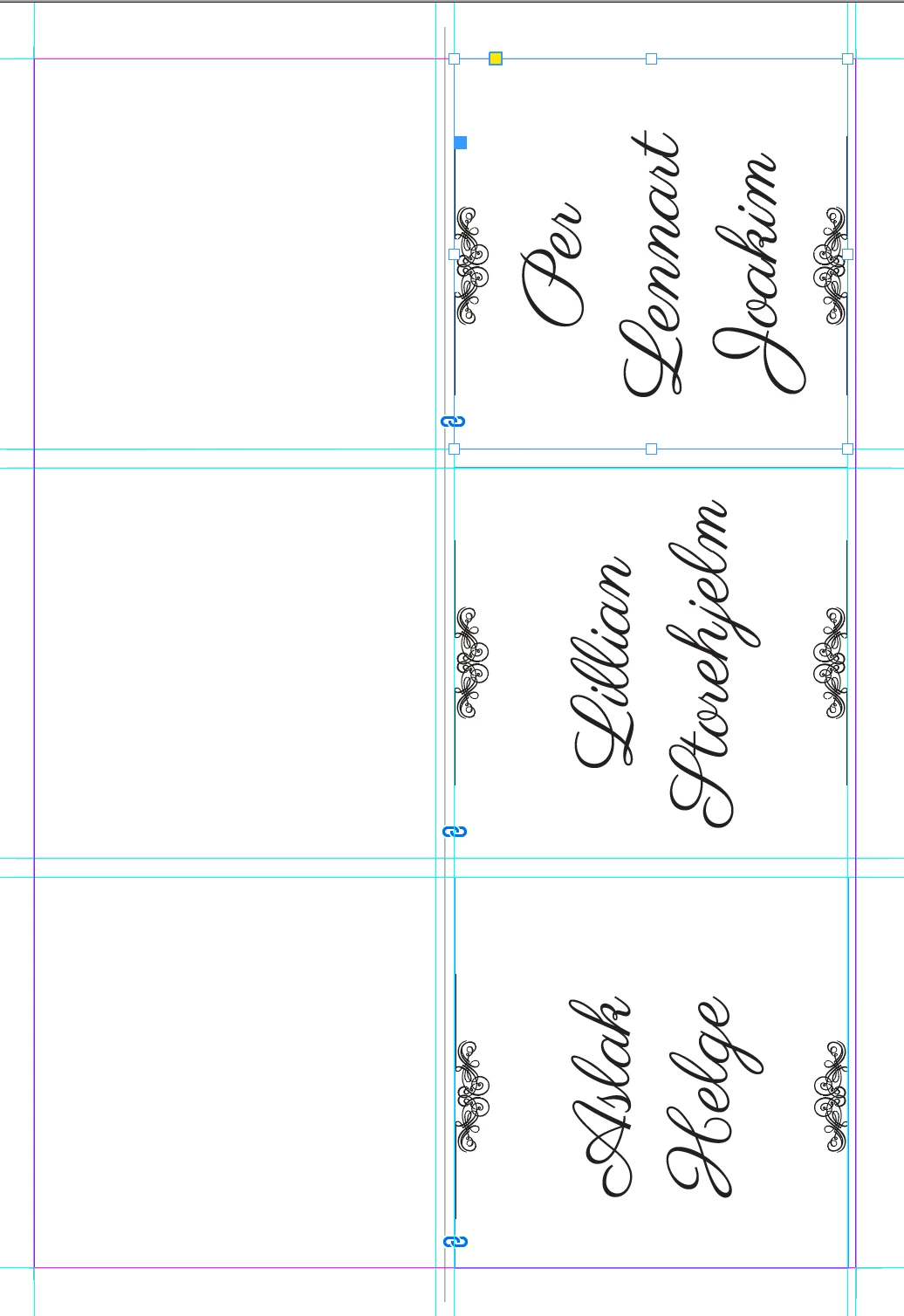

I have, basically, previously created what I call "singlets" in Illustrator. These singlets are basically, the same file, but have a little different text in them. The size in pixels and allignments and everything else are the same.
Now, when I try to import my "singlets" into my "printing template" in inDesign, even though they should all import as the same size, inDesign imports some of them correctly, and some of them incorrectly.
The error inDesign seems to do is that it does not import the full width of the "singlet" and cuts from one of the sides.
For the purpose of the demonstration, I will provide 3 of the "singlets" that need to go on a "printing template" as well as an inDesign "printing template". These are placed in the following Dropbox shared folder.
In this exact scenario, inDesign places the "singlets" for "Per Lennart Joakim" and "Lillian Storehjelm" as it should, but weirdly crops the one for "Aslak Helge".
Does anyone know how I could stop inDesign from doing this, and basically make it place the files as they are?

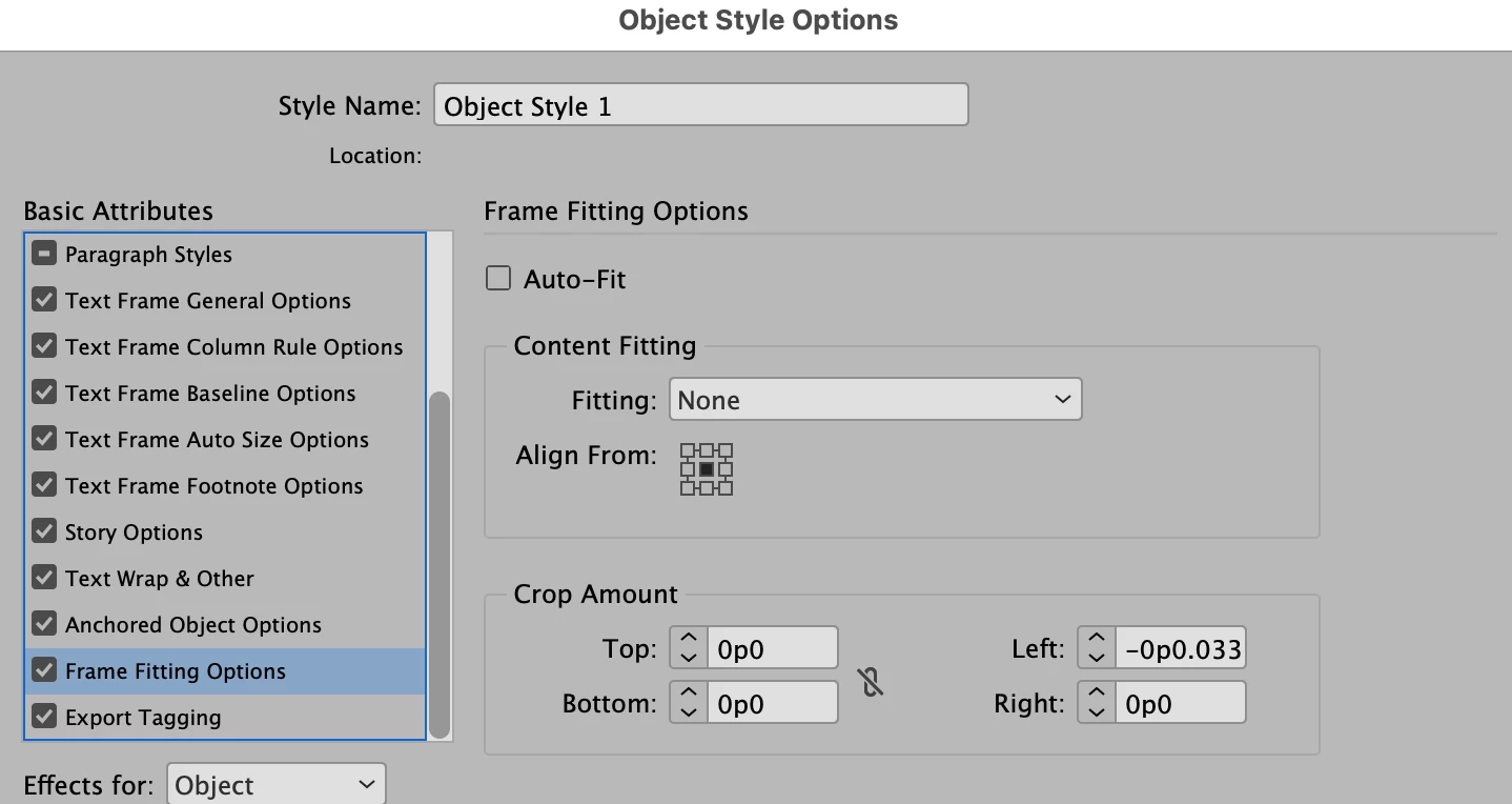

If I were setting up the template, I would create a placeholder frame where the AI file is supposed to be placed. I would apply an object style to each placeholder frame which included Frame Fitting Options that control how the AI file is placed and cropped:

This is extremely weird then, because I suspected a simple display error in inDesign and actually printet several copies of the file. They all showed, both the electronic version, and the three printed copies, the same fail.
The frame for "Aslak Helge" is not centered, as the others are. It is "leaning" towards the lower side of the page instead of placing itself perfectly as it should...

This is how your template looks when I open this on my MacBook Pro, macOS Big Sur (11.5.2), InDesign 16.3.2
