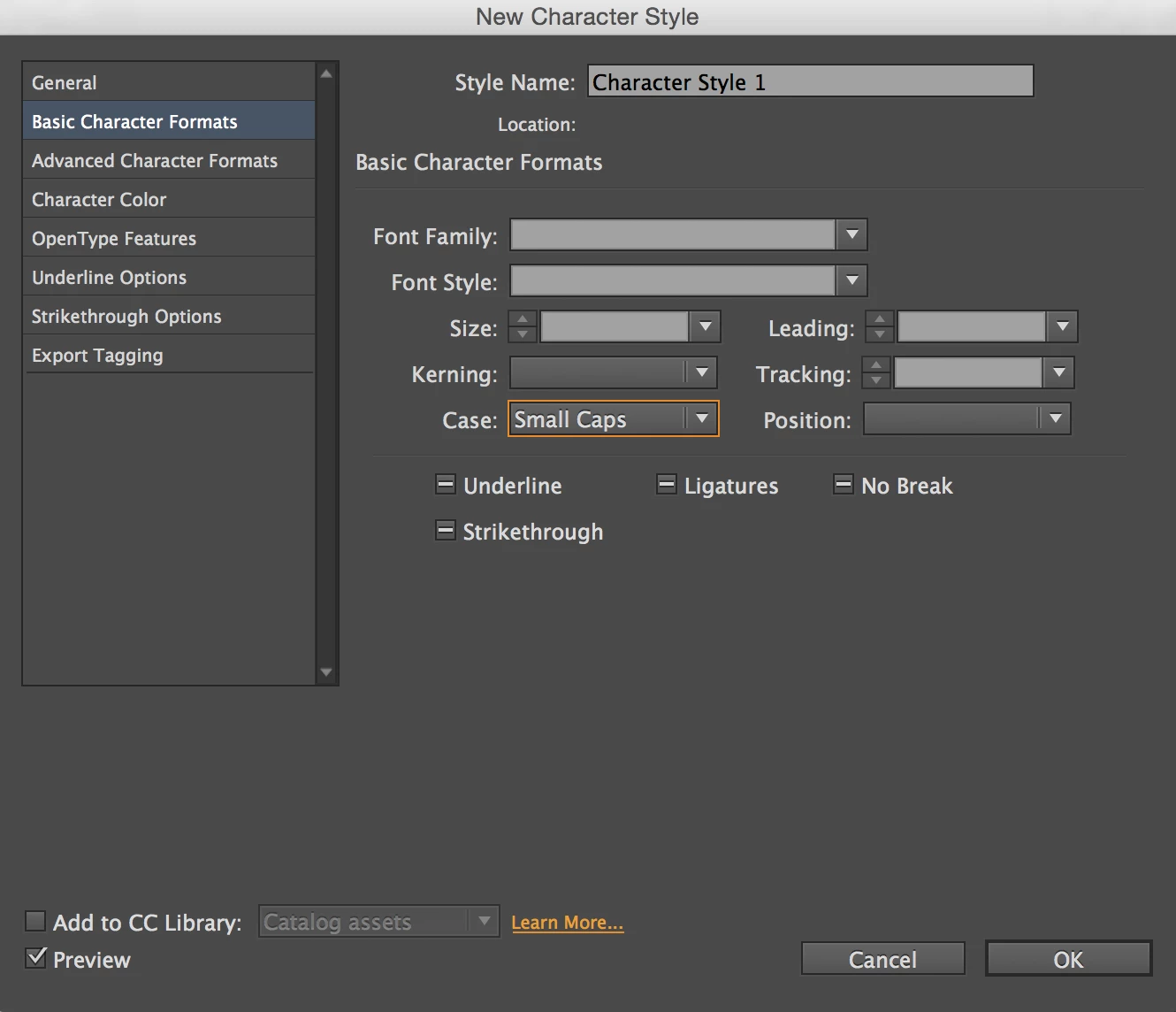

    What version are you using? I was able to set do this.
    --side note   I went back to try to do it a second time and Small caps would not stay selected. I closed out of the dialog box, and when I went in a third time, it did work.

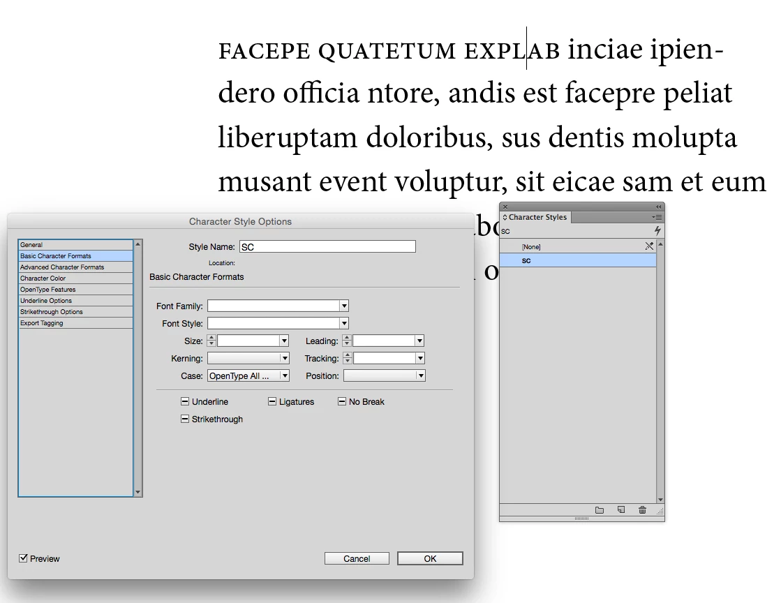

    Are you using the Character>Open Type>AllSmallCaps, or fake small caps Character>Small Caps? Fake small caps should work for any font change, but open type's AllSmallCaps would only work when you switch to another open type font that includes small caps.
    So here's MinionPro OT—I've set the Font Family field blank and Case to OpenTypeAllSmallCaps in style options:

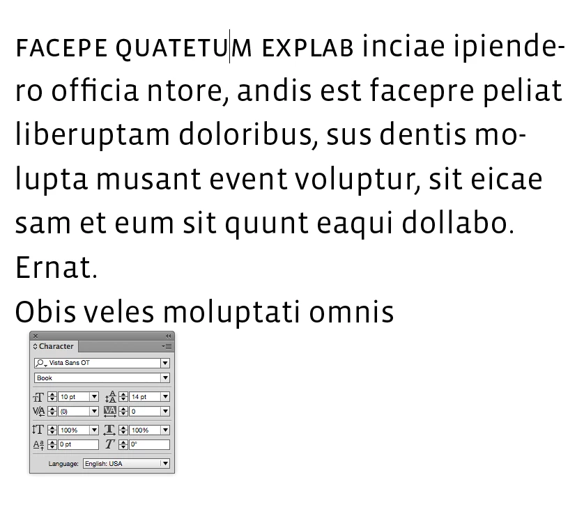

    Changing to another full OT font works:—VistaSans OT

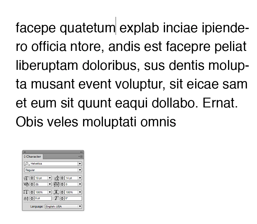

    But T1 Helvetica doesn't
