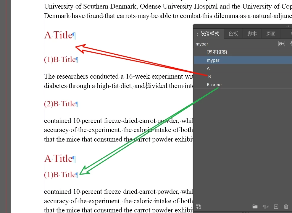

Is it possible to implement selective application of paragraph styles using scripts?
For example:
 A, B two paragraph styles have paragraph spacing.
When they are adjacent to each other, the spacing between A and B will be very large, then you need to set B to no paragraph spacing. For example, B-none.
Is it possible to use a script to determine, if A and B are adjacent to each other, to change the B pair of paragraph styles to B-none?
It's not a bug, it's just not advanced enough.
Will Adobe improve it?
Attachments available
Thank you.

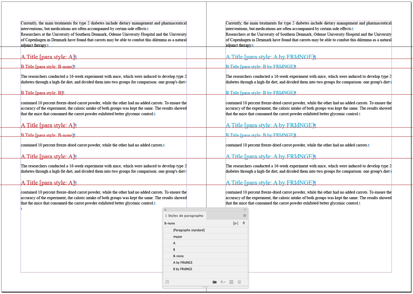

FRIdNGE
Jan 25, 2025 3:05 PM UTC
Just For Fun! … 😉
Are 3 Paragraph Styles and 1 Script really always necessary? Vs. just 2 Paragraph Styles!
(^/)  The Jedi
