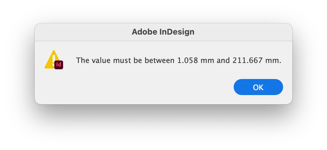

Is maximum vertical cell size in a table 211 mm ?
I'm trying to create a table in InDesign, to create some cells deeper than 211 mm (I keep getting a notification that 'The value must be between 1.058mm and 211.667mm' ?
I'm sure I've done this before, it seems a bit odd, any help appreciated.

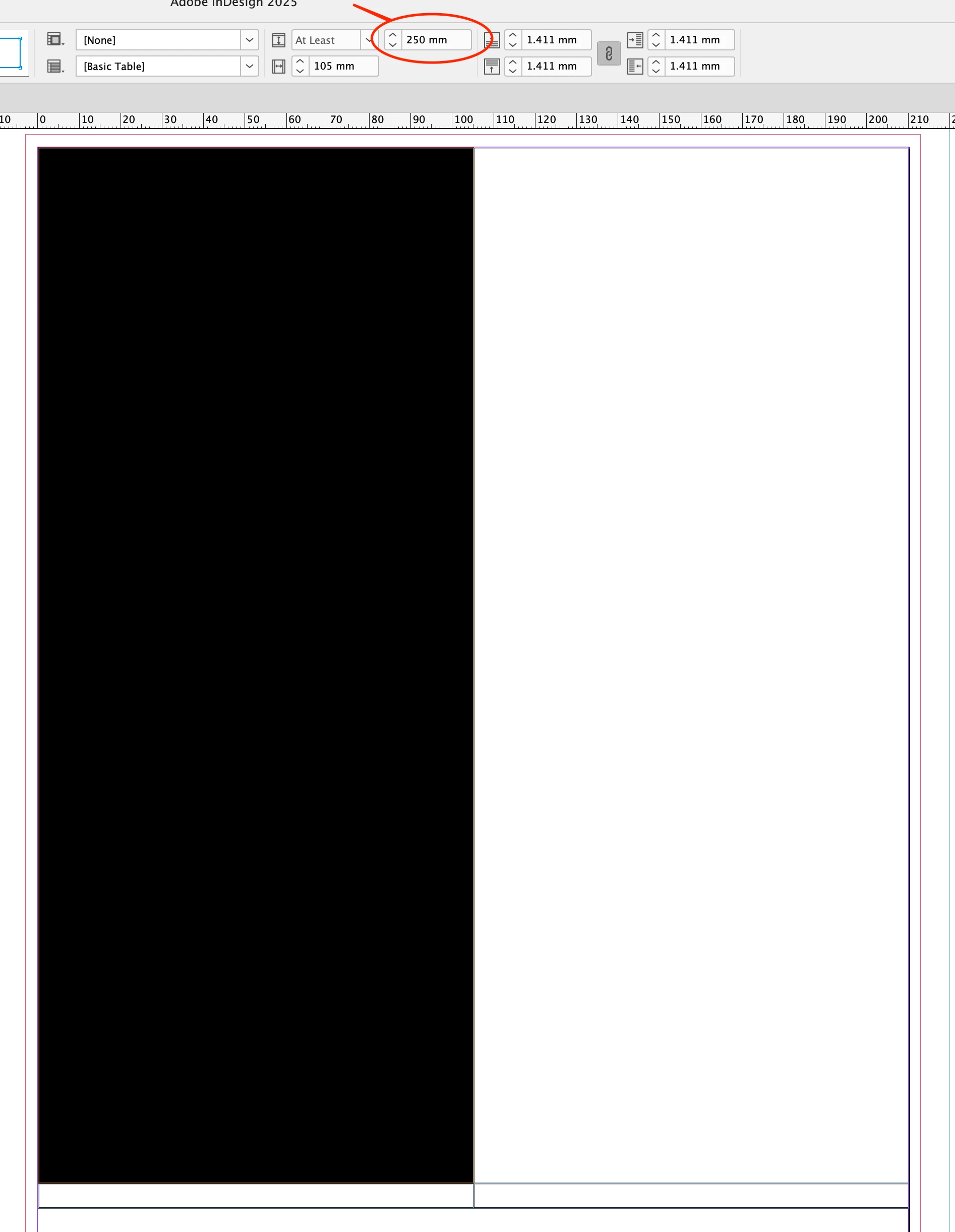

The default is 211.667mm, but you can change it in a live table.
Highlight the cell and go to cell properties (Ctrl/Option B on a mac) and in the new UI go to the fourth tab across the top, rows and columns.
 Where I've circled is the part that dictates the maximum. Now change it to a larger value. In my case, I'll change it to 250mm and click OK.
Unfortunately, you can't set it to that height as a default while no documents are open.
 Hope that helps
