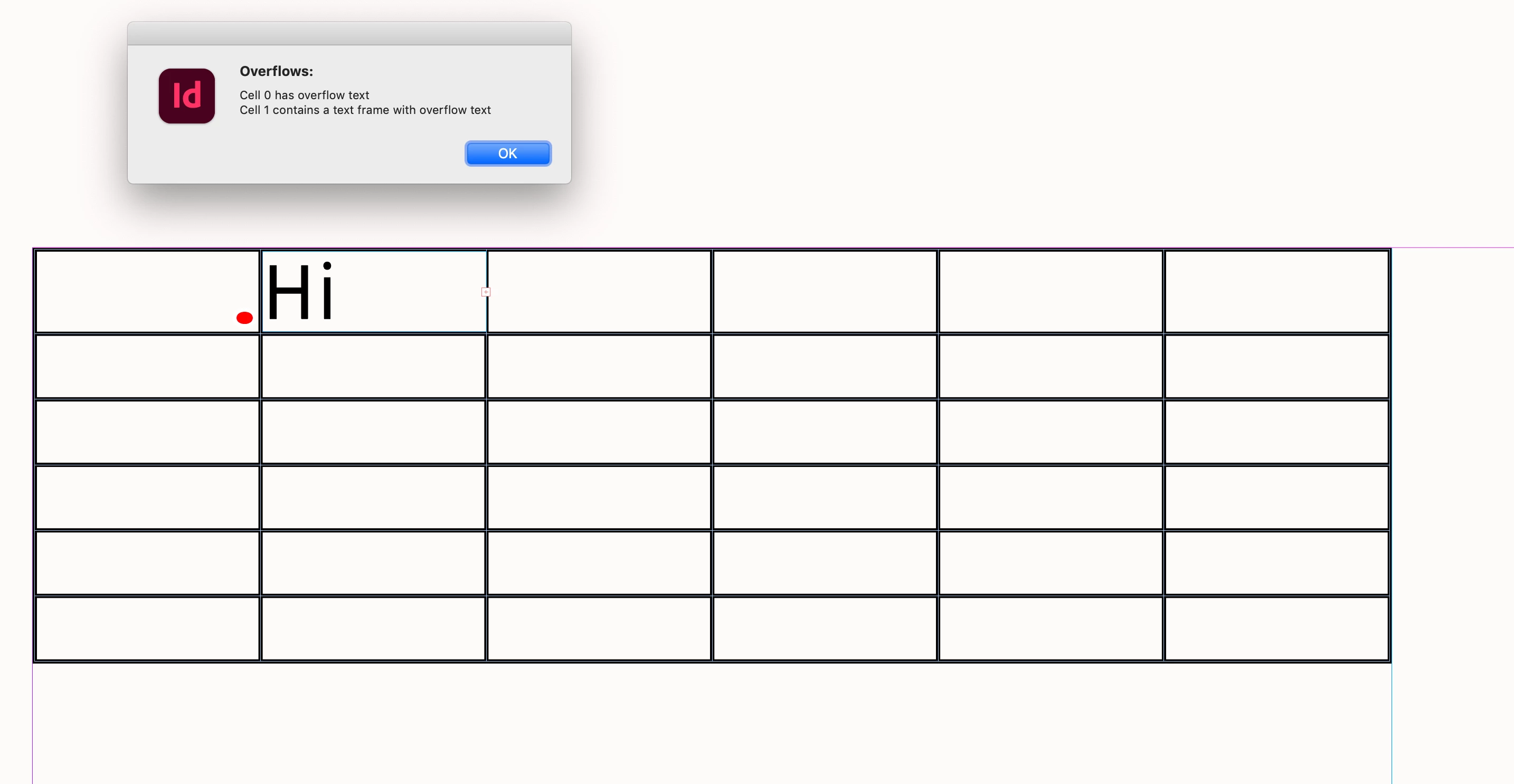

I can‘t help with UXP, but with JS, the cell itself can have an overflow, or it can contain a textframe with an overflow. Here‘s a JS example:
var c = app.documents[0].stories.everyItem().tables.everyItem().cells.everyItem().getElements()
var s = "Overflows:\r"
for (var i = 0; i < c.length; i++){
    //true if the cell itself has a text overflow
    if (c[i].overflows) {
        s+="Cell " + c[i].index + " has overflow text\r"
    //true if the cell contains a text frame
    if (c[i].textFrames.length) {
        //true if the text frame has an overflow
        if (c[i].textFrames[0].overflows) {
            s+="Cell " + c[i].index + " contains a text frame with overflow text\r"
alert(s)
Here the first cell has an overflow, and the 2nd cell has a text frame with an overflow.

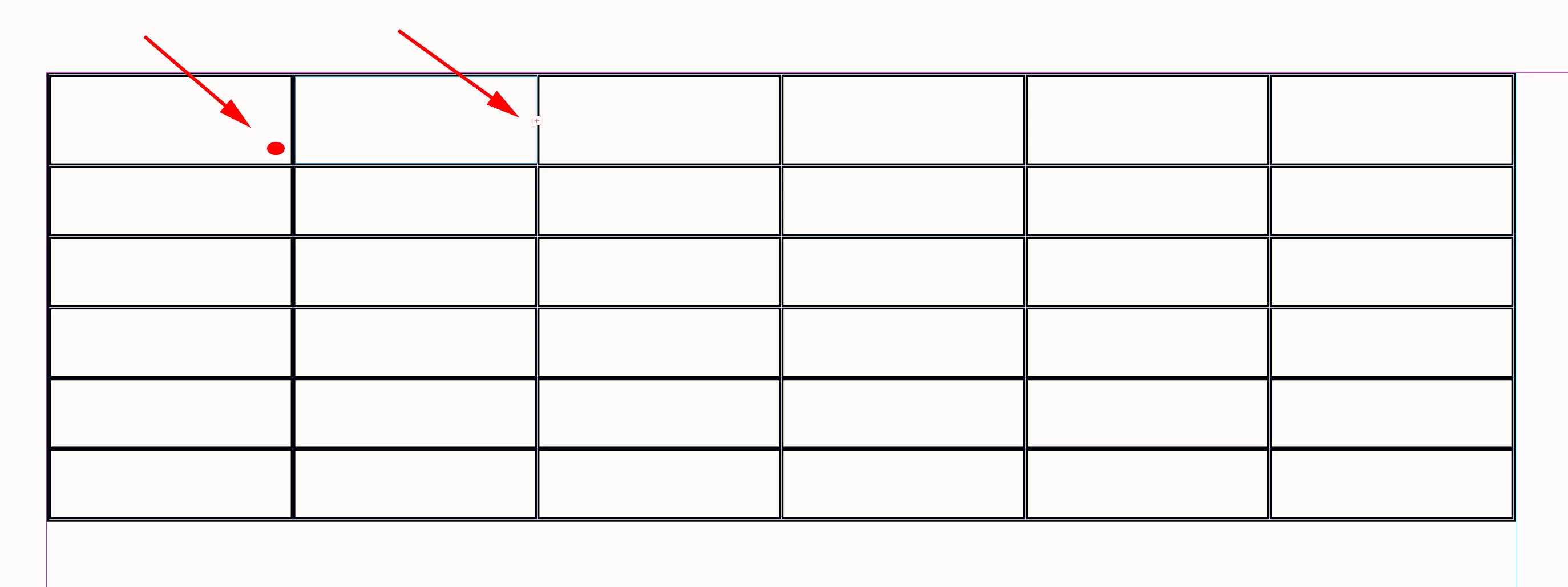

Hi @MahmoodTheDoom ,

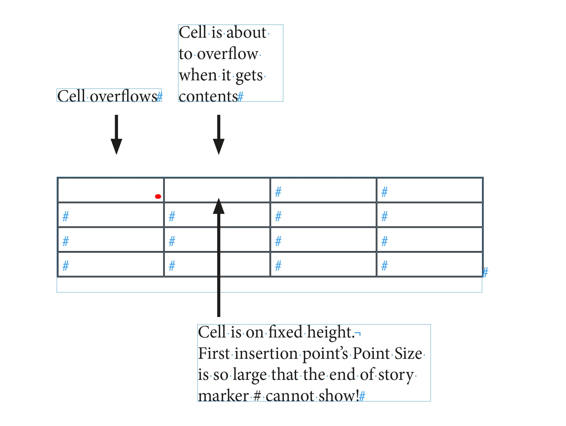

be aware, that there is another kind of visual indicator that an "overflow" will very likely occur if you add contents with e.g. cell.contents = "String" to a table's text cell. The end of story marker is not showing when the cell is on fixed height and the point size of the first insertion point exceeds a certain value:
Uwe Laubender

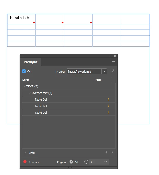

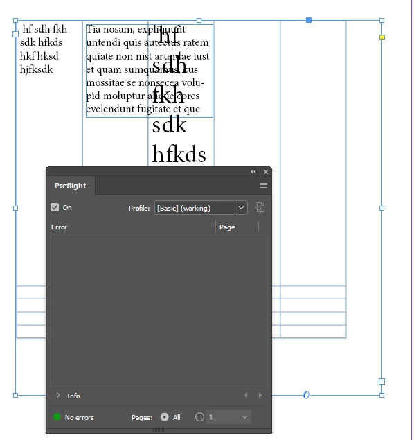

You can use Preflight for that:
2nd cell has a TF inside - 3rd has a text bigger than available height - but there is a red dot - to the contrary of what @Laubender suggested?

Hi @MahmoodTheDoom , Are you sure there are no text frames nested in the cells? With JavaScript the first cell in this table returns .overflows as true, but the 2nd cell returns false because the overflow is in a textframe pasted into the cell, not the cell itself:
July 17, 2024

July 16, 2024
What do you see in the InDesign?
