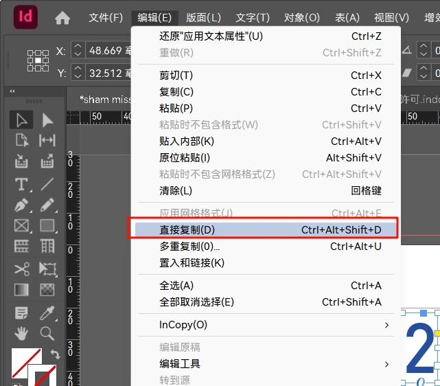

Is the "direct copy" offset random, or is it based on something?
What is the special use of “Direct Copy” under the Edit menu?
Is the offset of the copied object randomized,Or can it be set?

dublove
dubloveAuthor
Apr 22, 2025 6:04 AM UTC
It can't be.
ID version 19.5

Hi @dublove,

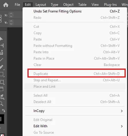

Thanks so much for the screenshot. The 'Direct Copy' you’re seeing is actually the localized name for 'Duplicate' in the English version of InDesign. As the name suggests, it simply duplicates the selected object or text frame.
The small offset you notice is part of the default behavior, just to make the duplicate visible over the original. It’s not random, but consistent unless you’ve manually changed the object’s position after duplicating.
I’ve added a reference screenshot below from the English locale for comparison. Let me know if you were trying to achieve something specific with this function, I would be happy to assist.
