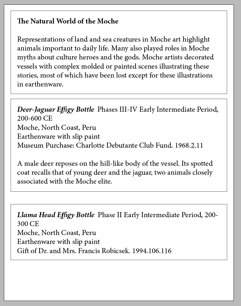

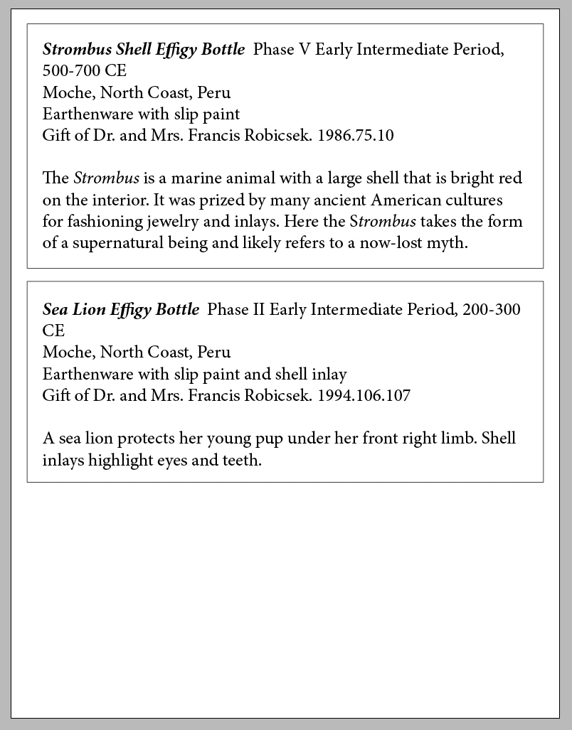

The text is of varying length, from 4 - 15 lines of text, this is inherently the obstacle.  If they were all the same size I could choose the best sheet size to maximize coverage.  Below are examples.  See how the page on the left has unused space at the bottom.  I would like a plugin that can search the document for another text box small enough to fit there in order to use the space, like the right page.
