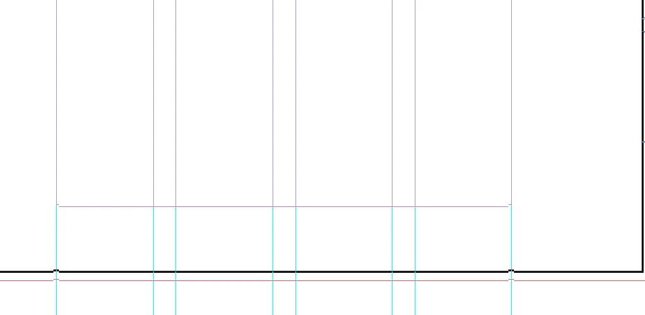

Is there a script for adding reference lines to columns?
When there are many columns, dragging them can be a bit troublesome.
I want to automatically generate column lines.

app.activeDocument.viewPreferences.rulerOrigin = RulerOrigin.PAGE_ORIGIN;
But,I don't know how to add reference lines that extend beyond the page.
See my first reply. You would have to get an existing guide or set a new guide—this makes a new guide that extends onto the pasteboard

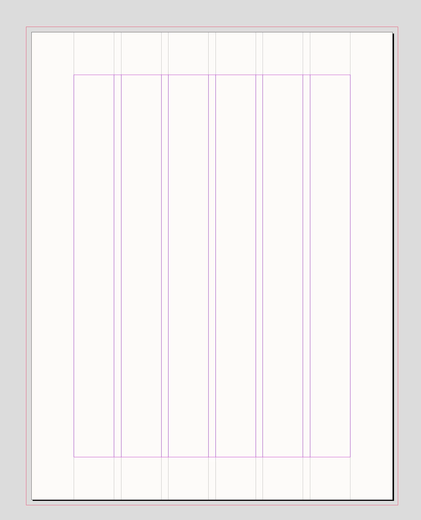

You can get column positions and add guides like this:
//page 1
var pg = app.activeDocument.pages[0]
//the page’s column postions as a array
var ca = pg.marginPreferences.columnsPositions;
//the left margin position
var lm = pg.marginPreferences.left
//add vertical guides at each column position
for (var i = 0; i < ca.length; i++){
    pg.guides.add(app.activeDocument.layers[0], {orientation:HorizontalOrVertical.vertical,location:ca[i]+lm});

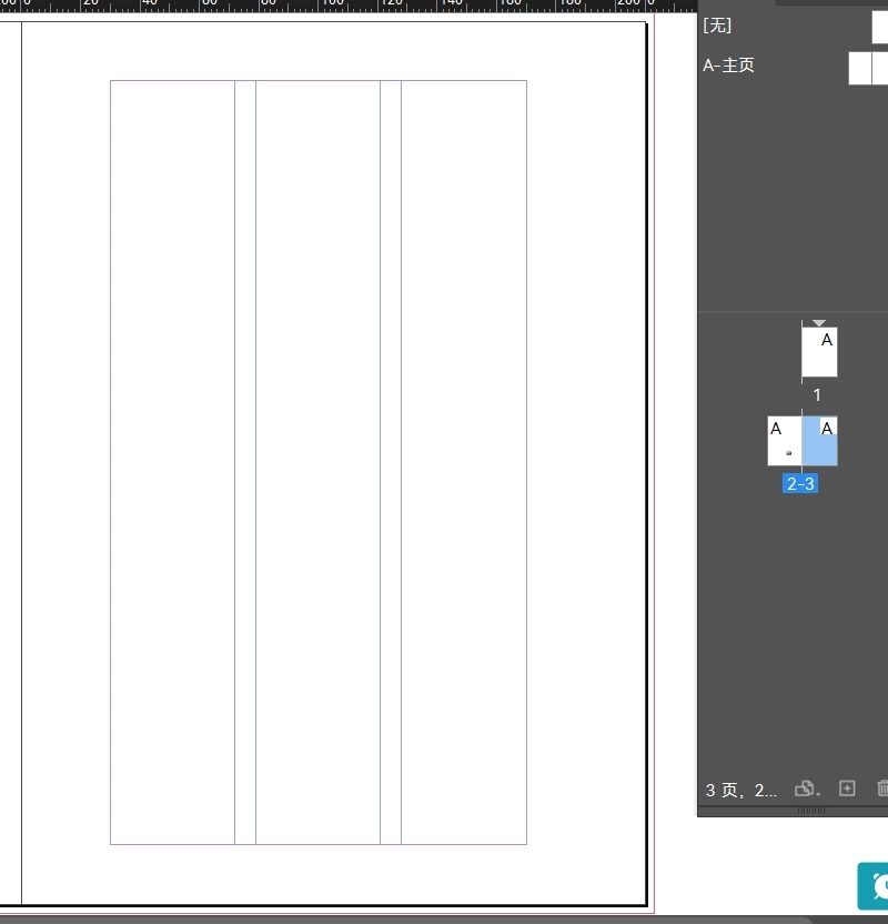

dublove
dubloveAuthor
Jul 31, 2025 3:12 PM UTC
I want to add it to the current page or the home page.
Do I have to select an object to get parentPage?
Is there a currentSelectPage function?

Mike Witherell
Jul 31, 2025 12:30 PM UTC
Layout > Margins and Columns will generate/adjust them quickly.
and if you want to add Guides over the margins and columns, then...
Layout > Create Guides
