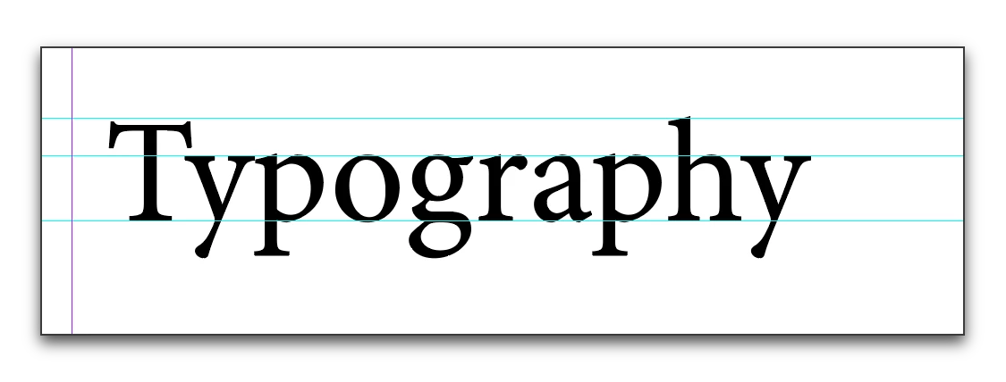

    Sandee -- In your example, green is baseline, lavender is the cap height. The bits that stick out below the baseline and above the x-height are called undershoot and overshoot, respectively. And in some fonts, serifs and flex can stick out above the cap height.

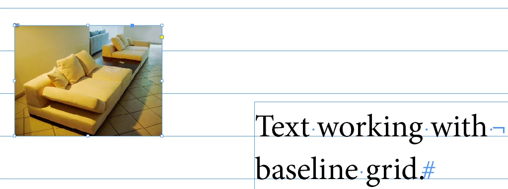

    Hi Marie,
    if your text is working with a baseline grid a placed graphic would snap to that grid.

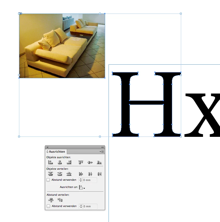

    For  cap-height or x-height you probably could select a character, "H" for cap-height, "x" for x-height and create a duplicate outline of the selection and align your graphic to the outlined character.
    To get a duplicate outlined character just select a character and when on a Mac press the alt key and use menu Type > Create Outlines
    Uwe

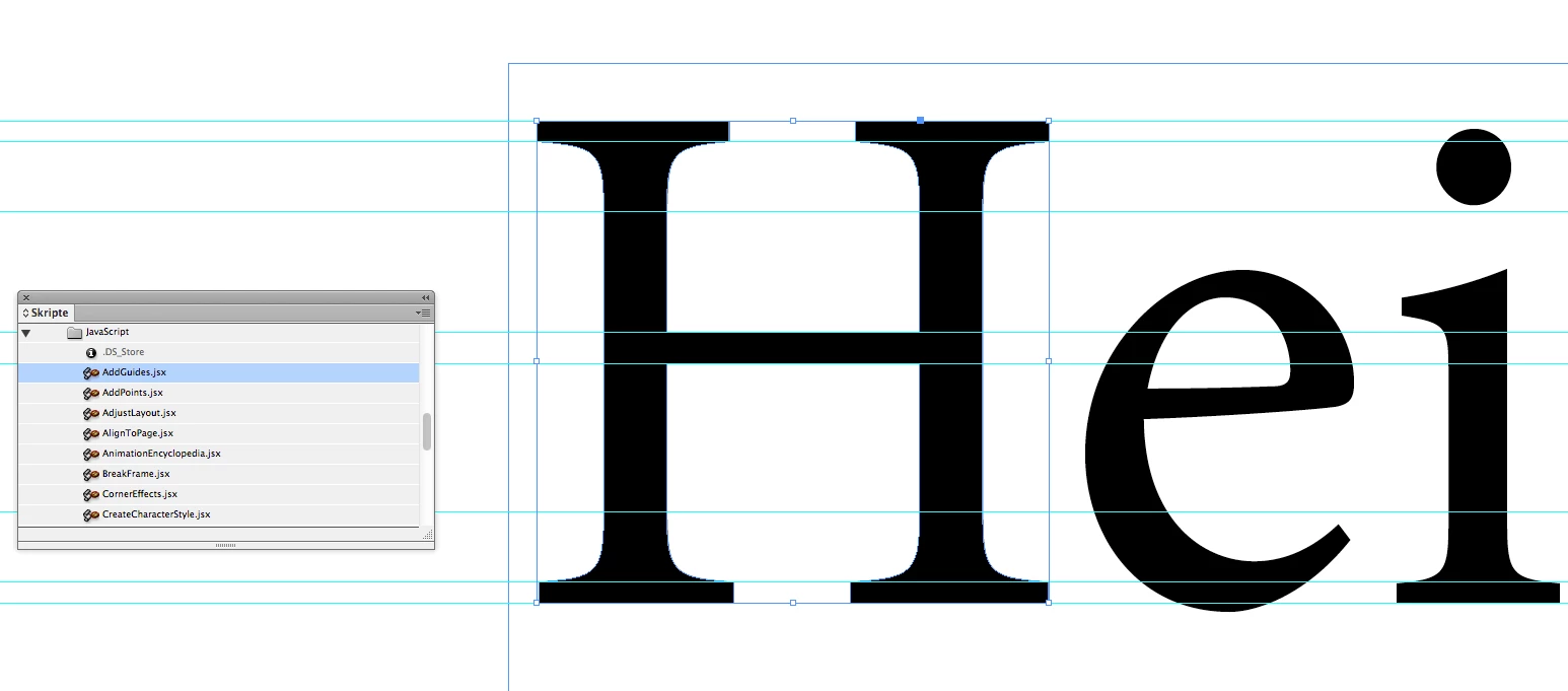

    With a selected duplicate of a character outlined you could also create guides with a script that comes along with every version of InDesign: AddGuides.jsx . Open your Scripts panel in InDesign, look under Application > Samples > JavaScript.
    Select the outlined shape and do some controls after double-clicking the script AddGuides.jsx from the Scripts panel:
    Don't know why
  • the controls say "Add Guides Around: Path Points Vertical Anchor" if I want horizontal guides, but it is working that way. Maybe better would be: "Add horizontal Guide at Path Points" and "Add vertical Guide at Path Points".
    Here the script author used technical terms like "Horizontal Anchor" and "Vertical Anchor" that a "normal" user, who did not dived into InDesign's Document Object Model for scripting cannot understand.
  • After inspecting the code I know why, because the values of property anchor of a pathPoint are used and described that come along with an array of x- and y-values as [x,y]. And x-values would be used for vertical guides and y-values would be used for horizontal guides.

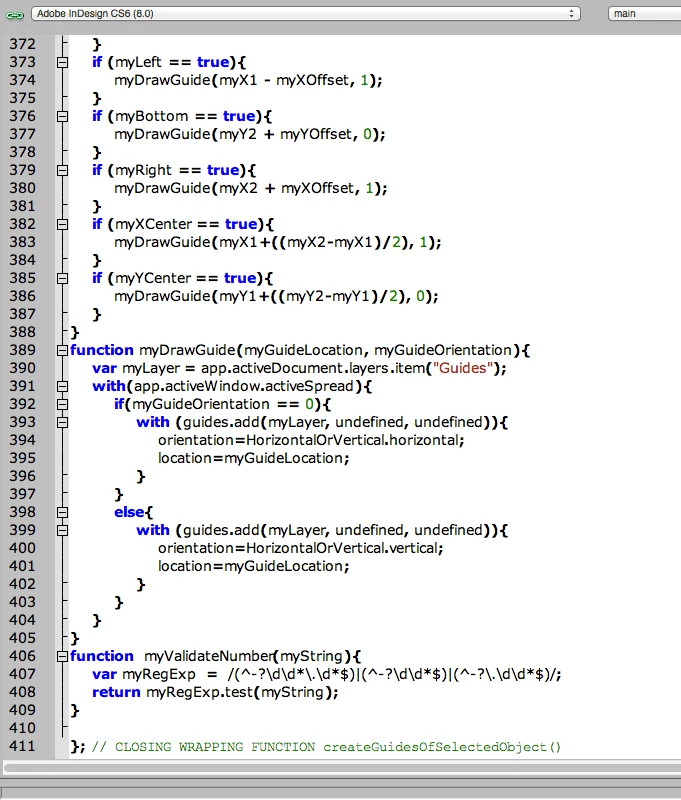

    After running the script:
    Also note that you cannot undo the action of this script in one go.

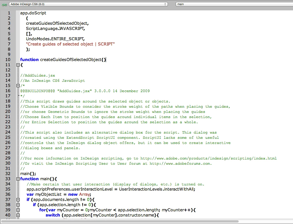

    That would require to add some simple lines of code to wrap the whole script into one single function and call that function with a doScript.
    Something like that:
    app.doScript
        createGuidesOfSelectedObject,
        ScriptLanguage.JAVASCRIPT,
        UndoModes.ENTIRE_SCRIPT,
        "Create guides of selected object | SCRIPT"
    function createGuidesOfSelectedObject()
    /* ADD ADOBE'S CODE BETWEEN THE TWO BRACES*/
    Note: The name of the outer function is used with doScript()
    The string that says "Create guides …" is the thing you'll see, if you go to InDesign's menu to do the undo action.
    Change it to something you like.
    From the ExtendScript Toolkit:
    Do not forget to add the closing brace of the added function declaration above.
    Add a new line at the very end of Adobe's code and add the closing brace:
    Uwe
