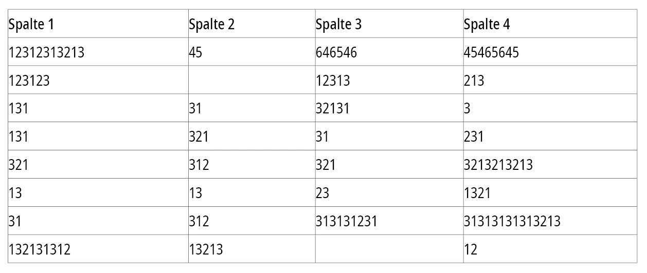

Nov 17, 2021 2:44 PM UTC
There is in fact no "straightforward" mechanism in InDesign. Trying to shrink the cells using "if ... cell.overflows" will make you end up banging your head against the wall because InDesign would need a recompose after each step, well, plus ideally an "idle" phase to reliably redraw the table.
My solution, based on the idea of my friend Martin Fischer, goes like this: I assess the largest cell entry in each column and then assign this value, plus an addition for rounding errors, to the column. Something like:

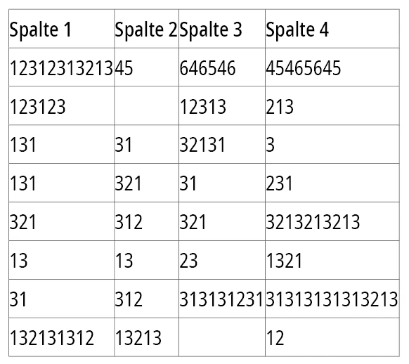

Interestingly, this solution is quite performant; this table is optimised in "no time":
Hope this helps and gives you a kind of starting point.
