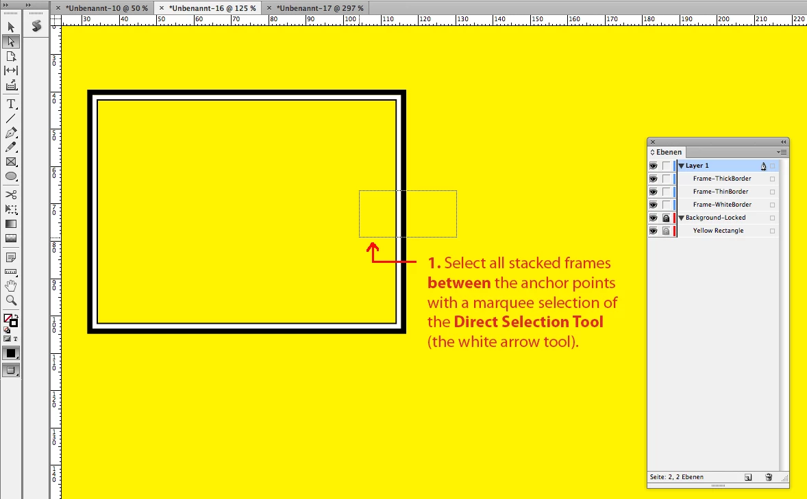

Hi Ryan,
you could do all this with InDesign rectangles.
Do a stack of three frames.
One with a thin stroke.
One with a thick stroke.
One with a (white?) thick stroke.

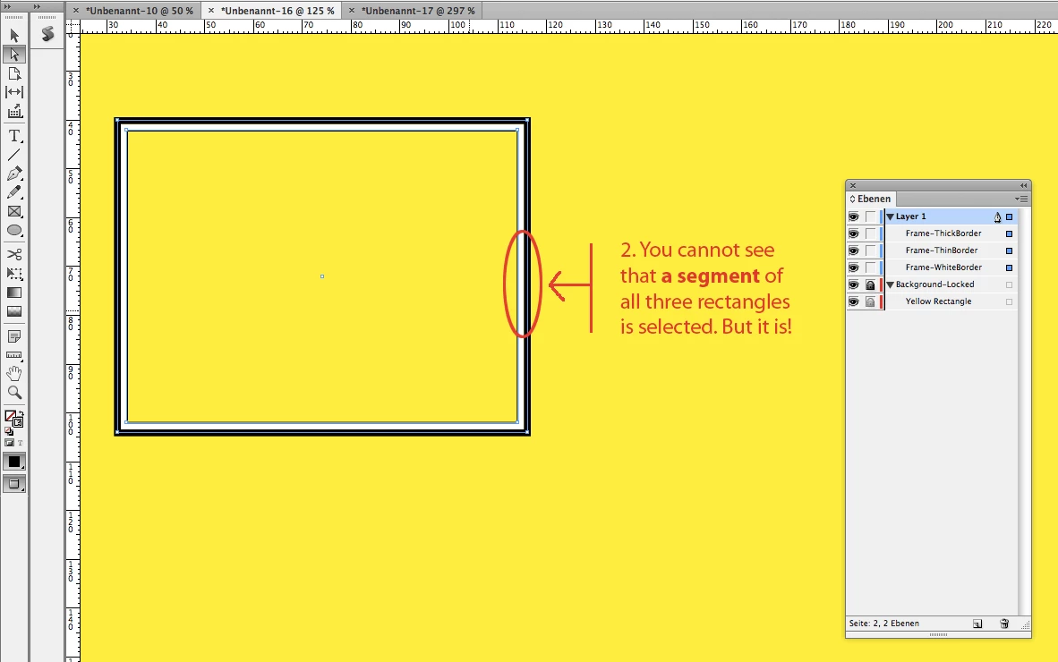

If you want to change their dimensions, do not scale them, but select them with the Direct Selection Tool (the white arrow tool) between the anchor points by using a marquee selection.
Now hold the SHIFT key and drag in direction of the x-axis to change the horizontal dimensions of all frames without changing their stroke weights. Maybe you have to pause a bit after holding down the mouse key before you start dragging.
The result for horizontal dragging the selection of a segment is shown here:
To continue, deselect all.
Then select one of the horizontal segments with a selection marquee to change the vertical dimensions.
Uwe
November 3, 2016
Do not use the Selection Tool (black arrow tool) to do this.
That could change the relative position of the stacked frames to each other.
I did my three frames with different sizes centered on each other.
Uwe
