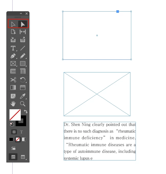

Is there a way to distinguish which selection tool is currently being used?
I have currently selected the frame, but I want to distinguish between the following states:
Is the selection tool being used, or is it a direct selection tool?
Is this possible? Perhaps this would be useful.
Usually, they only display one name:
Rectangle or TextFrame.

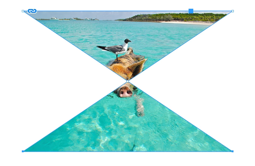

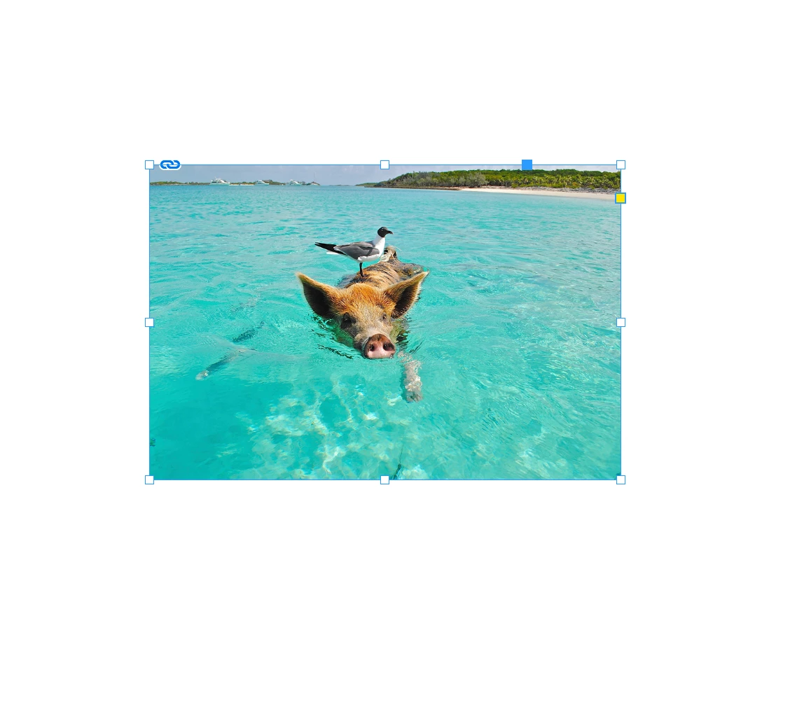

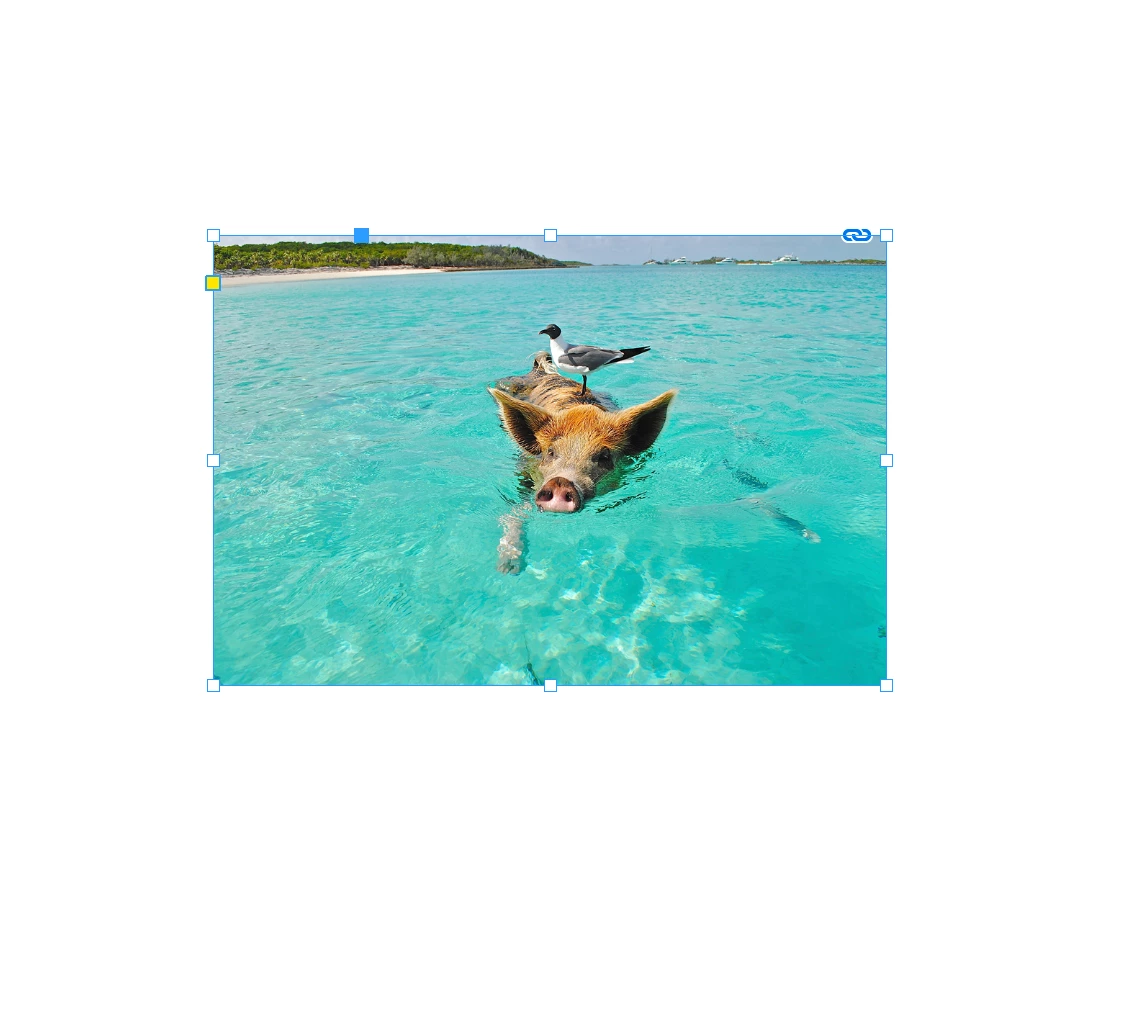

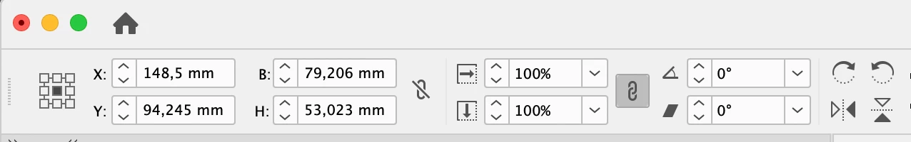

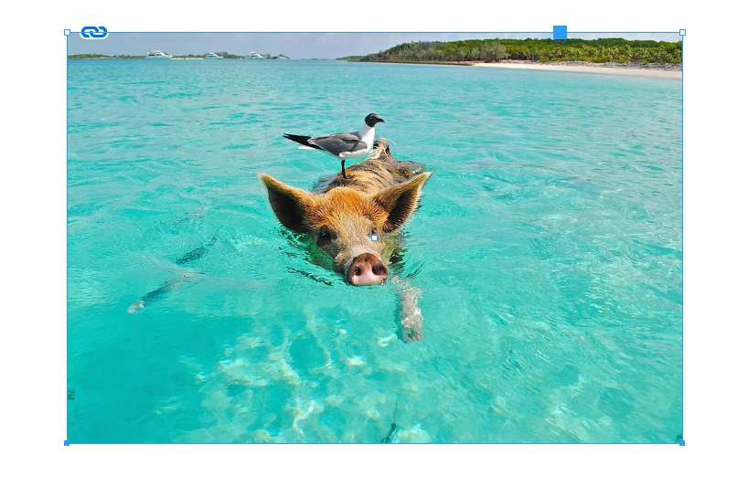

Well, it will make a difference if you are working with the selection and if you use a menu command, a menu action, for e.g. transforming the selection. See the difference between UITools.DIRECT_SELECTION_TOOL and UITools.SELECTION_TOOL for example:
app.menuActions.itemByName( "$ID/Flip Horizontal Menu Item" ).invoke();
Graphic frame selected with the selection tool.
Result after running the script:
Graphic frame selected with the direct selection tool, the bottom 2 path points are selected:
Result of the same script:

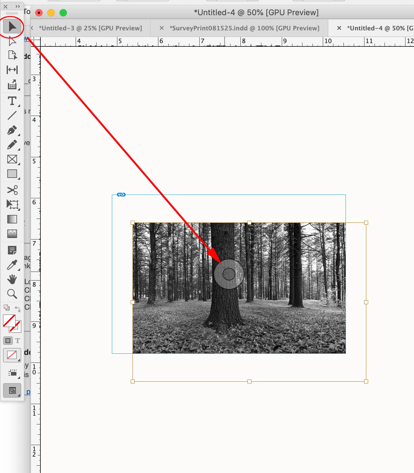

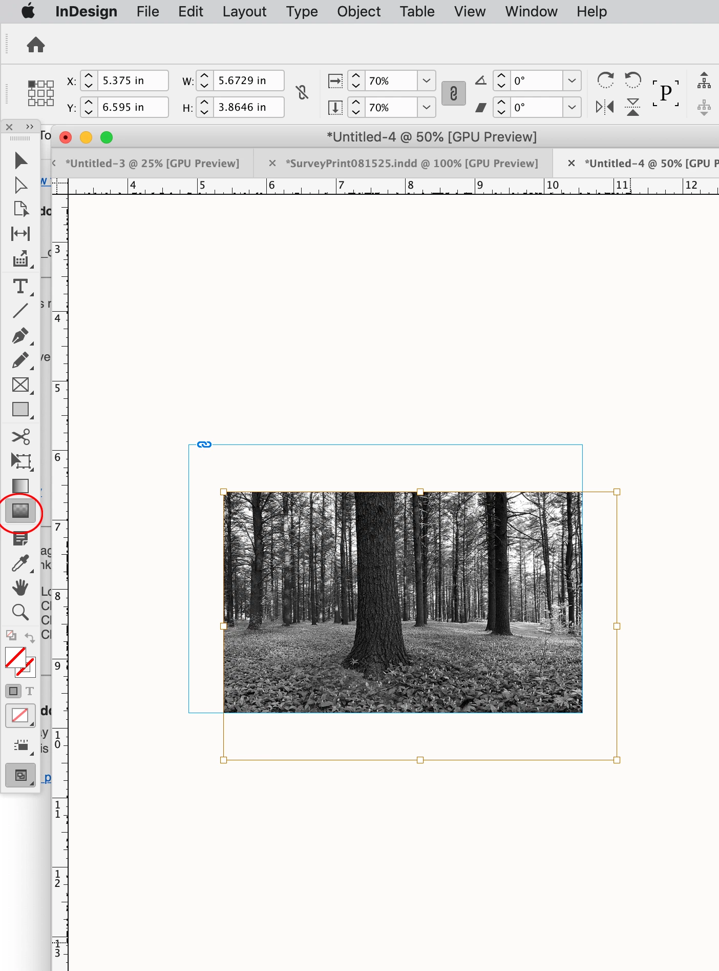

As @m1b  and @brian_p_dts  point out, the currently selected tool doesn’t tell you anything about the selection. I could have my Command key pressed with any tool active and select an image:
