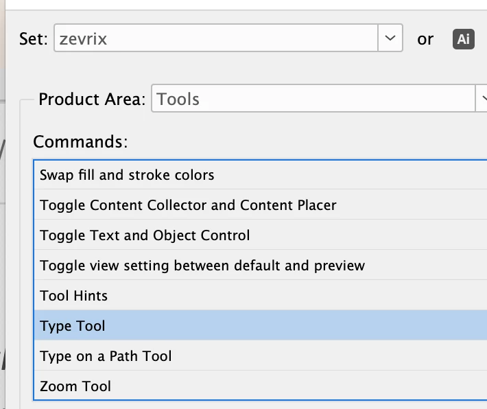

I just tried this - when I'm using the Picker I style some text.
Then I press T and it switches back to the text tool.
The riot happens at wanting to switch back to the Eyedropper -as you have to select from the tool panel
So what I did was set a keyboard shortcut that only works when editing Text (it won't in any other context)
Now I can style the text with the eye dropper tool
Press T to edit the text
Style some more
Then press ALT T (maybe should have picked ALT I ) but it's up to me
Now I can switch from Eyedropper to Text and back again with ease

leo.r
Oct 29, 2024 8:59 PM UTC
quote
Yes, that's exactly what I do but I would wish to be able to swith back to the Text tool *without* needing to swtich to the Selection tool first : why can't I swith to the Text tool directly?
By @Roger Breton
Try to assign your own custom shortcut to the Text tool.
Normally, this should enable you to select the tool in any situation (although I don't know if it's suitable for your particular scenario).
