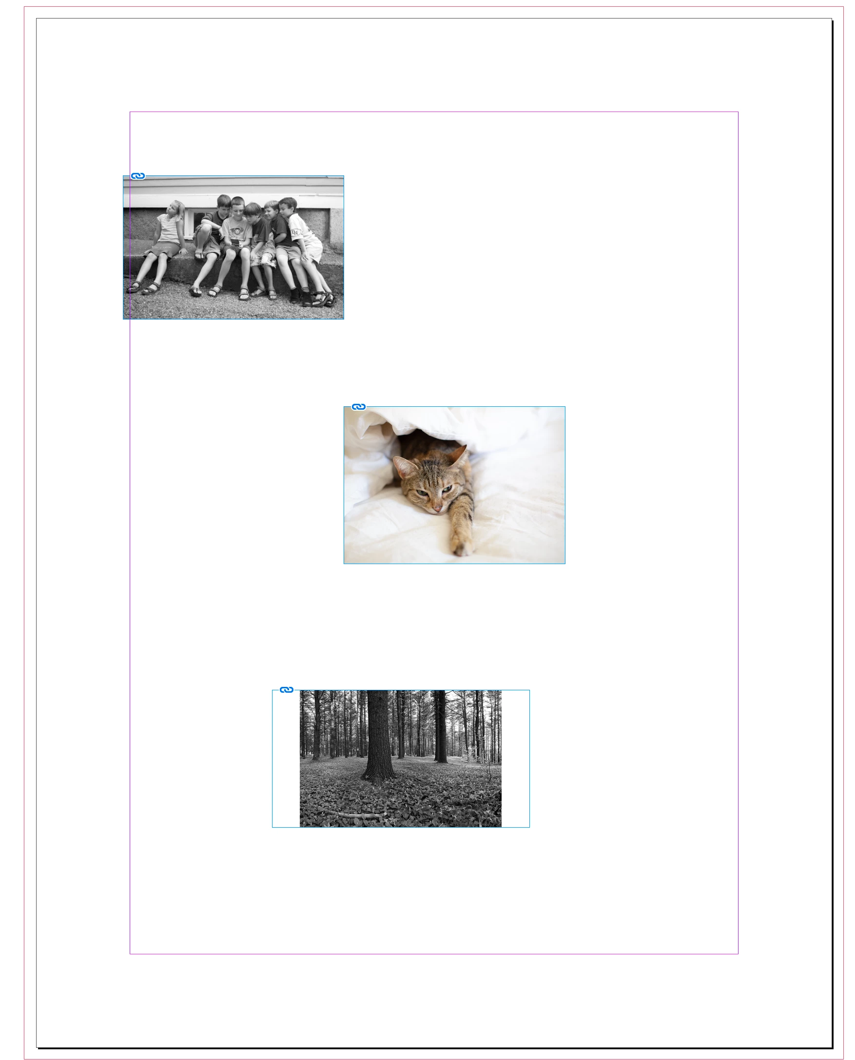

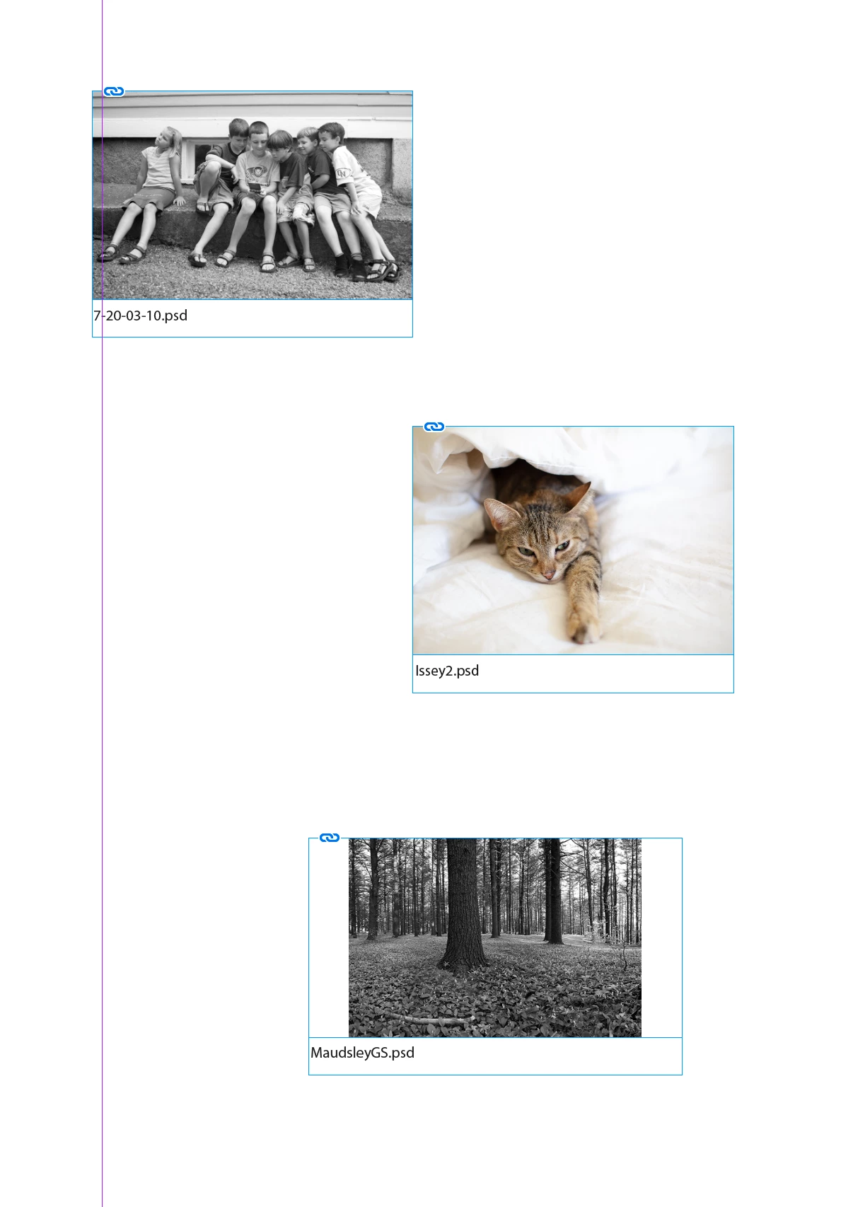

Hi @wckdtall , I do it by invoking the Generate Live Caption menu item to script the caption generation—not sure if there is a better way. This example gets the parent frame of every placed link, invokes the menu, uses the file name for the caption, and styles the caption with paragraph and object styles:

before and after:

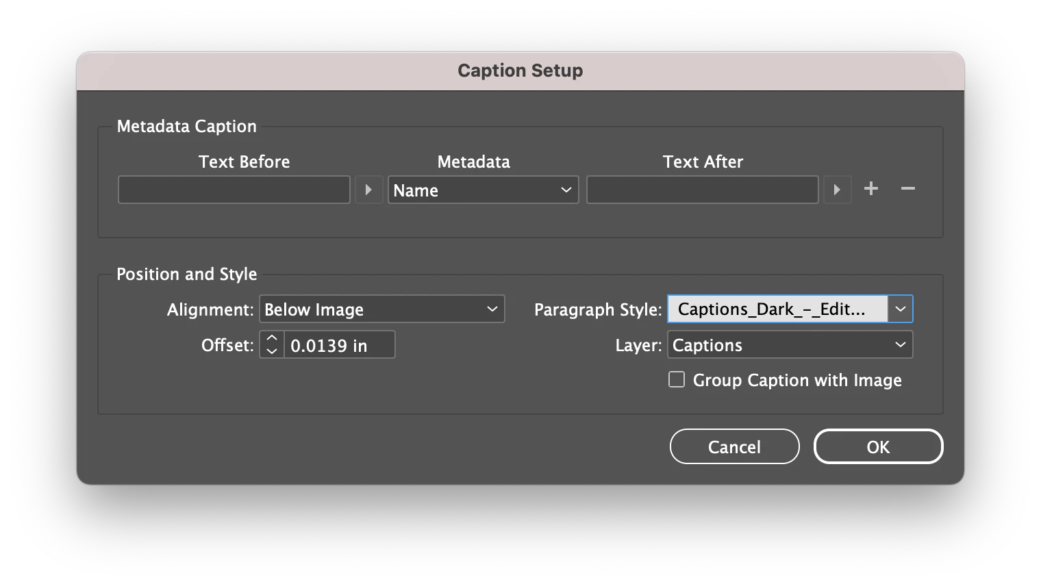

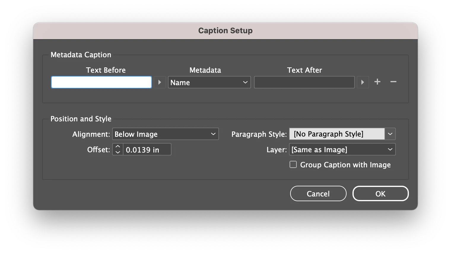

Sure! All I'm trying to do is edit "Object > Captions > Captions Setup" from:
To:
Basically I'm trying to change Paragraph Style and Layer to the preferences showin in the current active document. Is it possible?
