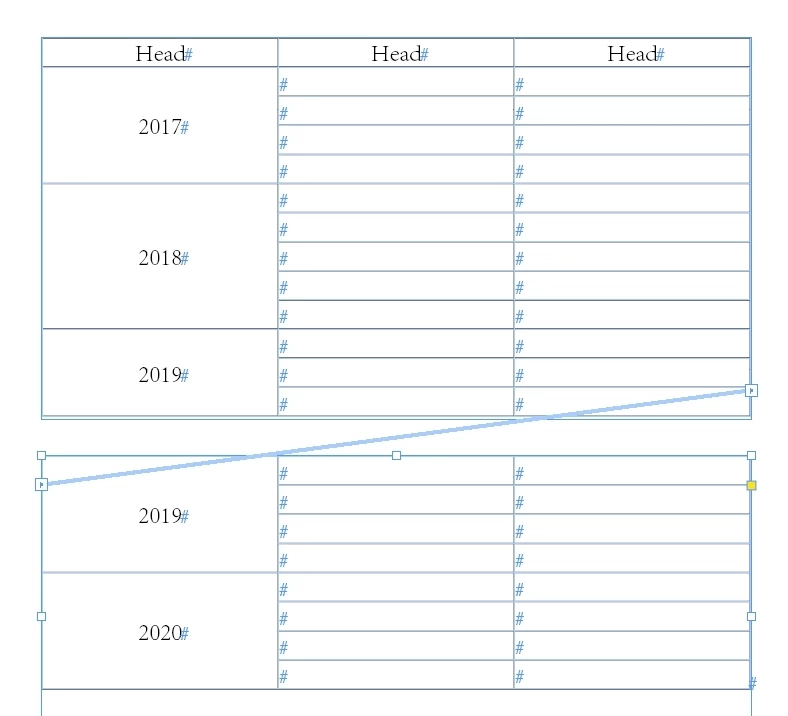

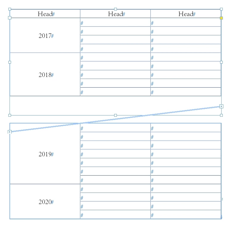

Is there any way to automatically split and merge columns that span multiple rows?
The client always wants to see standardized typography, so it has to be adjusted every time.
But the next time, you need to unmerge the cells again, adjust, and then merge again.
Is there any way to minimize repetitive, useless operations.
Word seems to have this feature in this area?
I've seen examples of setting the middle horizontal line to no color, but that's prone to errors and off is not a good idea.

I THINK this could be done with a database plugin such as Em Software's InData. However, some minor changes would need to be made:
The year would need to be in the top row, and the following rows with the same year would make the type and rules white/none, until it hits a new year. Technically, the years would still be in the data, just not visibile.
Robert at ID-Tasker
Feb 17, 2025 5:54 PM UTC
@Dave Creamer of IDEAS
You're on the right track 😉 but not without a script 😉
Data could be loaded as "rows" - with year duplicated in each row - then script can go though cells in this/1st column - check if next cell in this column has the same contents AND is still on the same page.
It would be a slight modification to the script I've posted recently in another thread - the one that checks applied CellStyle - after "range" has been found - do merge.
So even no need for any database plugins / plug-ins - just import it as a table.
Unless there are images / QR codes to be generated automatically - but that can be done with a simple script(s) as a post-processing.

Robert at ID-Tasker
Feb 17, 2025 3:32 PM UTC
quote
Doesn't seem to have been asked .
As I don't think scripting is likely to make it happen.
Scripting is potentially unsafe here.
By @dublove
Scripting is the only solution and already has been done.
"Brute force" solution:
https://id-tasker.com/split-cells-between-pages/
Not sure what do you mean by "unsafe"?
