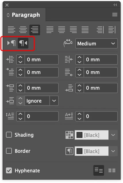

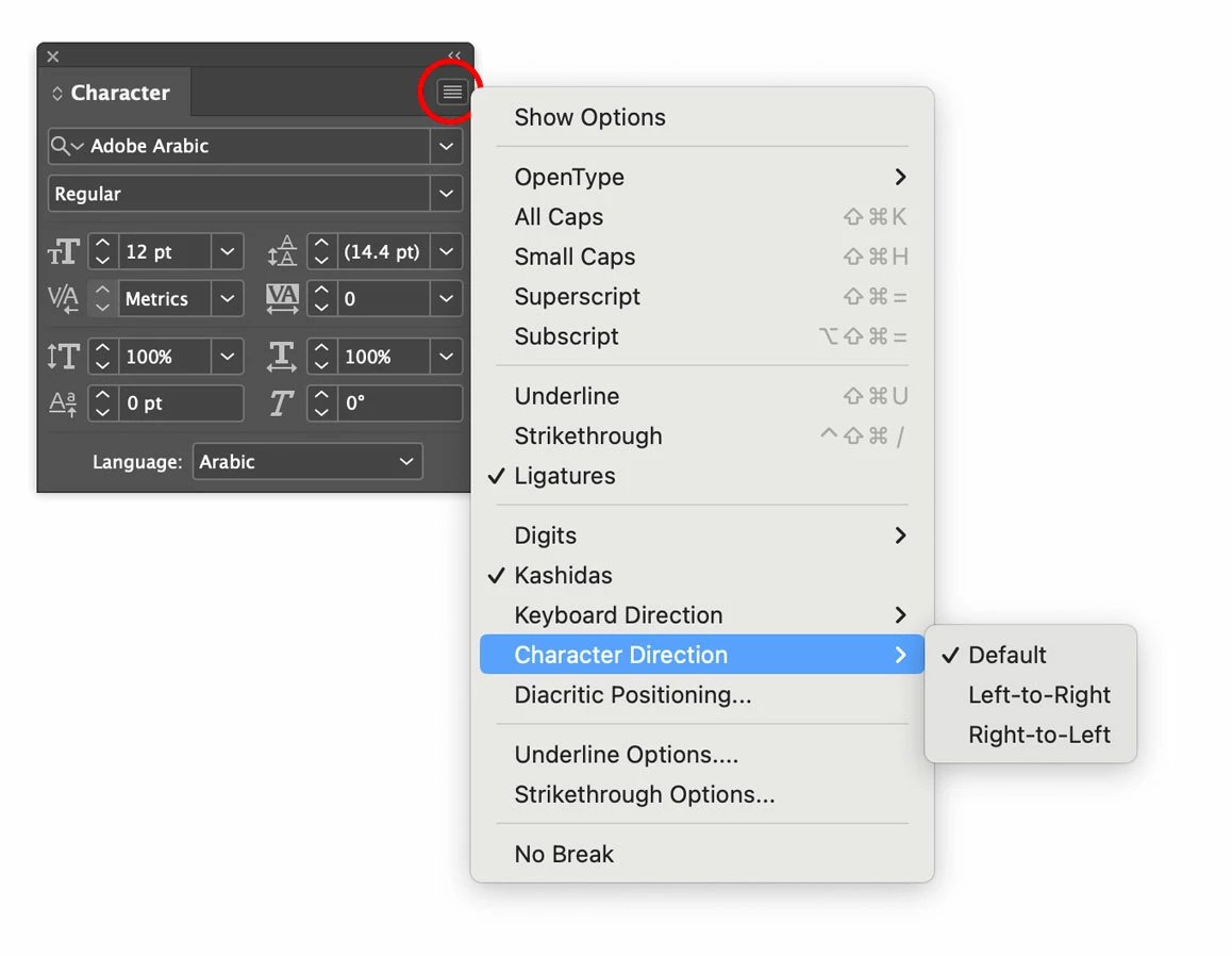

I personally use the Middle Eastern version of InDesign and have the full controls. By the way, what you described about punctuations appearing on the wrong end of the text is related to the "Paragraph Direction" controls found in the Paragraph Panel
not the "Character Direction" found in the fly-out menu of the Character panel

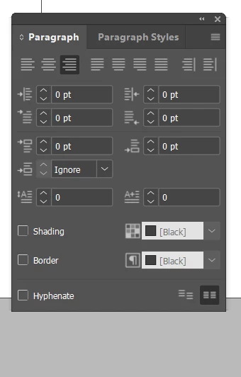

May 26, 2023 11:23 PM UTC
Salam bro,
thats thing i dont have that option, and I even reinstalled it again with the version that support يدعم العربية. still the same issues , and there is no version thats fully arabic i see all the languages except arabic
this is what i have , and for the charachter panel its same thing , there is no mention of any directions
