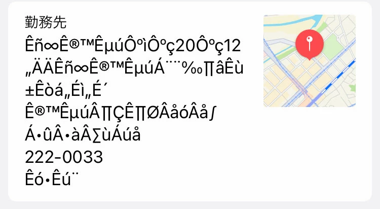

I am designing business cards featuring QR Codes with contact information in japanese (i.e. with kanji characters), exported as PDFs.
When reading these cards with a QR scanner, the contact information appears to be garbled.
Can anyone kindly provide a solution to this?
I assume it's an encoding issue that needs specific character-encoding settings.
Thanks in advance!
