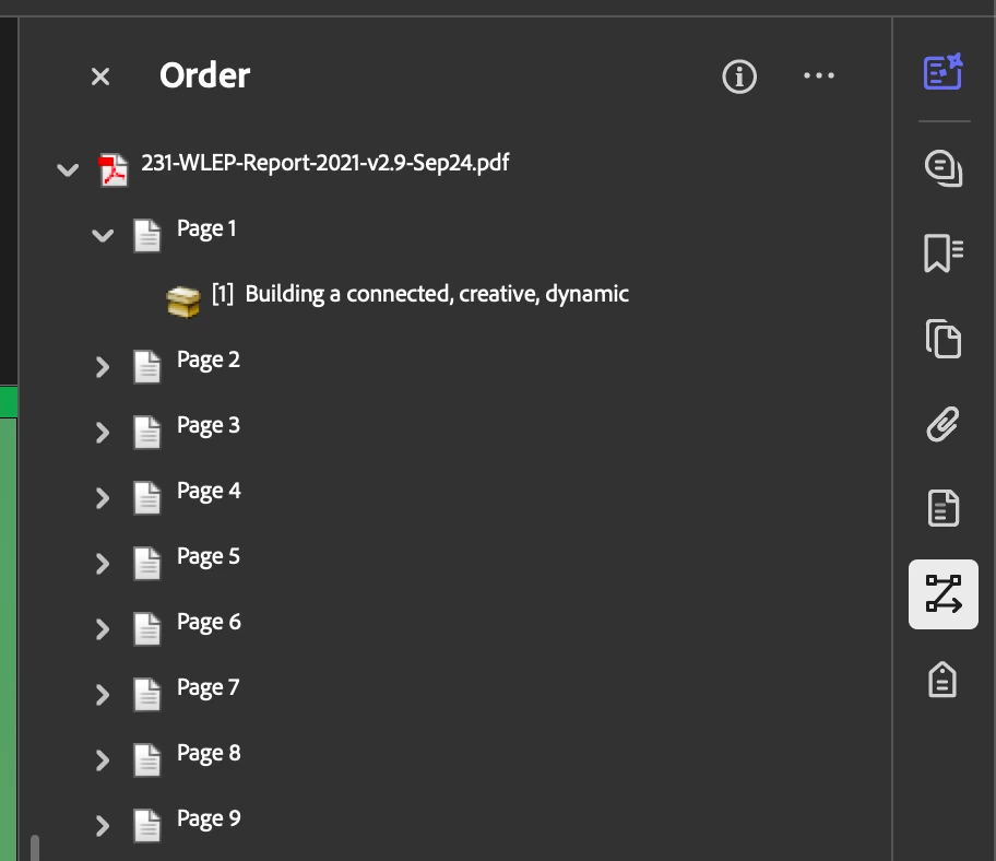

I’ve been working on a 200-page report, meticulously checking all text threads to ensure the reading order is correct. However, after exporting to an interactive PDF, about 55% of the document still has issues with the reading order in Acrobat, even though it passes the Acrobat check.
My goal is to make the PDF as accessible as possible. All other accessibility issues were resolved after the latest export, but the reading order still seems off during visual inspection.

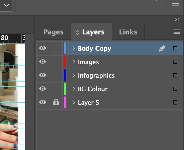

The reading order is determined by the LAYER panel order bottom (first) to Top (last), so it should be the same as Tags where top (first) to Bottom (last) is read, lets say 'reversed' order. What is at the bottom of the LAYER is numbered 1, what is at the top of the LAYER panel is last.
The Article panel order does NOT set the Reading (Z) order:
The ARTICLE panel order = the TAG order (top to bottom)
And the LAYER panel order = the 'reading' (Z) order (bottom to top)*
*Open the layers (triangle) to see items in them bottom to top

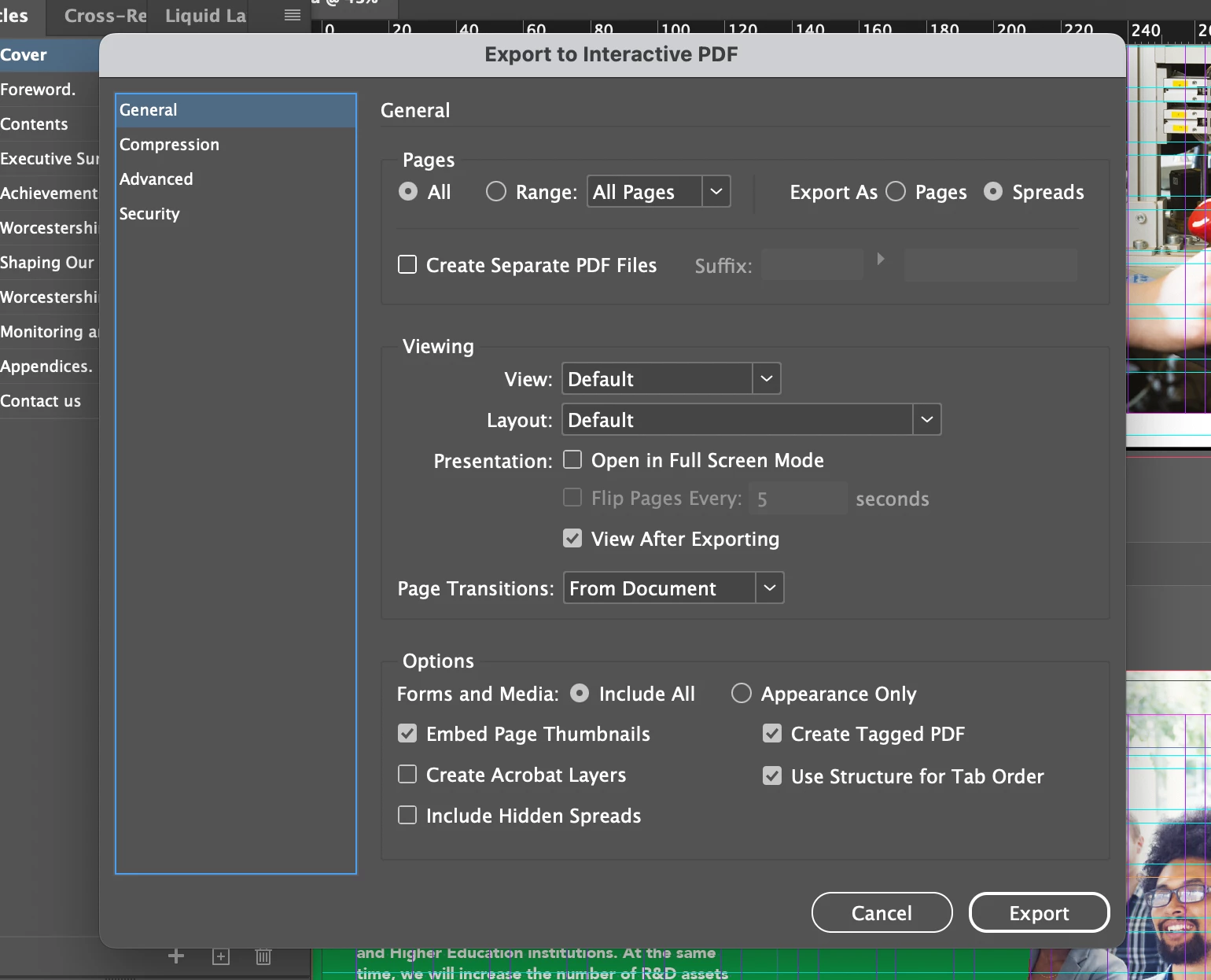

Could you please share the details of your operating system? Also, if possible, could you provide a screenshot of your export settings?

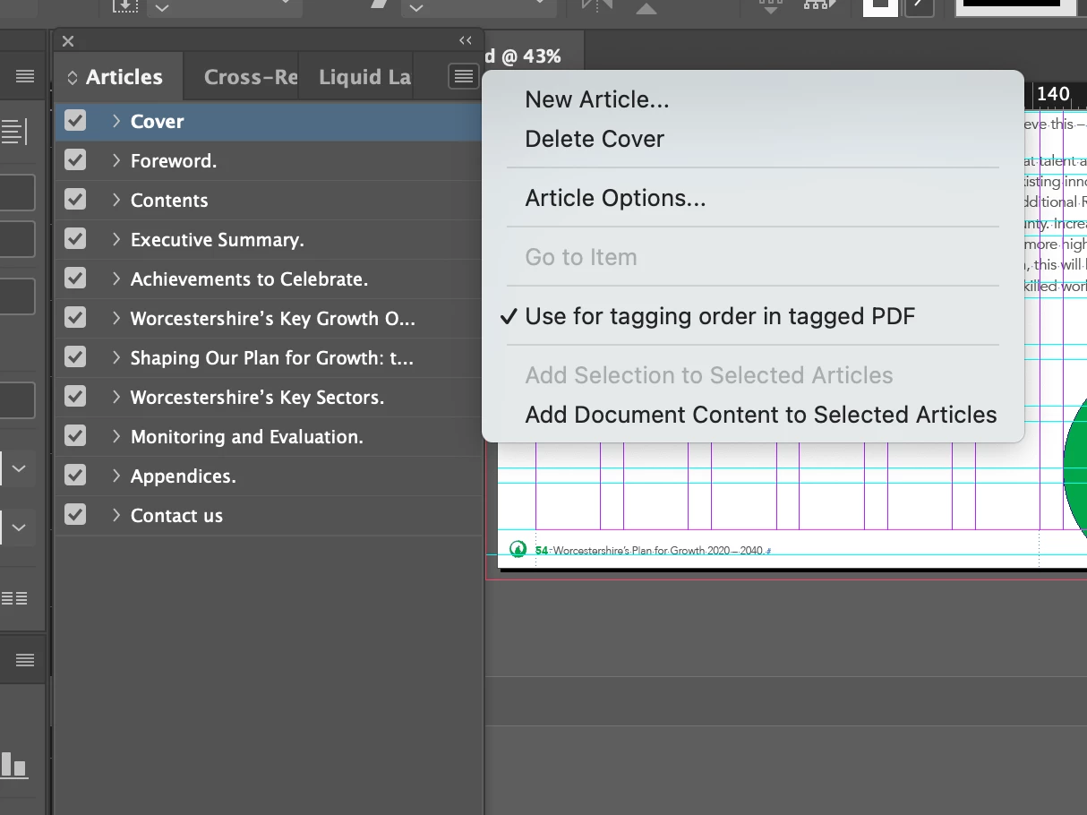

Export setting attached along with a screen shot of my Articles, which are in order.

2. As per screenshot, the onlky settings I see are those for Create tagged PDF and Create structure options
3. All my text is on a single layer at the top, as per screenshot
