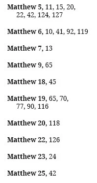

I am generating a Scripture Index at the back of my book in InDesign, using character styles and then Peter Kahrel's great little "Index from Character Styles" script. After I generate the Index, I end up with a list of scripture references in alphabetical order with page numbers after them like this.
Now I need to sort this entire scripture index to be in canonical order (instead of alphabetical order). But after selecting the text and running the sorting script, I end up with this 😞 :
The books are in the correct order, but the chapter numbers are all out of sync! 😞 I suspect that it's the page numbers that are throwing the script out of whack, but I can't verify that, and neither do I know what to do to fix it. I'm slowly learning some simple scripting in InDesign, but this script is a bit above me yet. Does anyone have any pointers for me? @Magnus Gaarde is the one who wrote the script, but I don't know if they are still around on the forums or not.

The script will sort the list based on the characters in the name. 1 comes before 2 etc.
That is why the sorting will look as in your example:
Matthew 1
Matthew 10
Matthew 17
Matthew 2
Matthew 23
Matthew 4
The script was written tocould quickly sort a list of Bible books for a contents page or similar. It was not intended to sort an entire index.
If you are able to GREP your way out of adding couple of zeros to the first chapter numbers that might get the sorting right.
