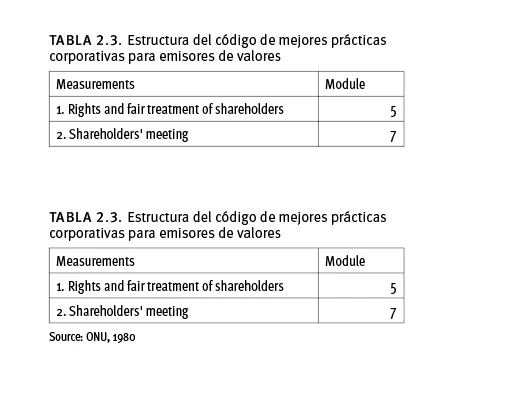

It is possible to add one row or a line of text at the end of a table in a document with many table?
  • January 5, 2021
  • 866 views
Or at least know the code to look at the end of a table and insert a line of text?
Thanks

Can you elaborate a bit more, some screenshots might help to understand what you have and what you need. Also, is this is a scripting question(as you mentioned code)

January 5, 2021
Manan, thanks.
The idea is to introduce the source for these tables and find a way like insert a new row.
January 5, 2021
You could have this be a row at the bottom of each table, and remove the strokes from the bottom, sides and middle of just that row.
