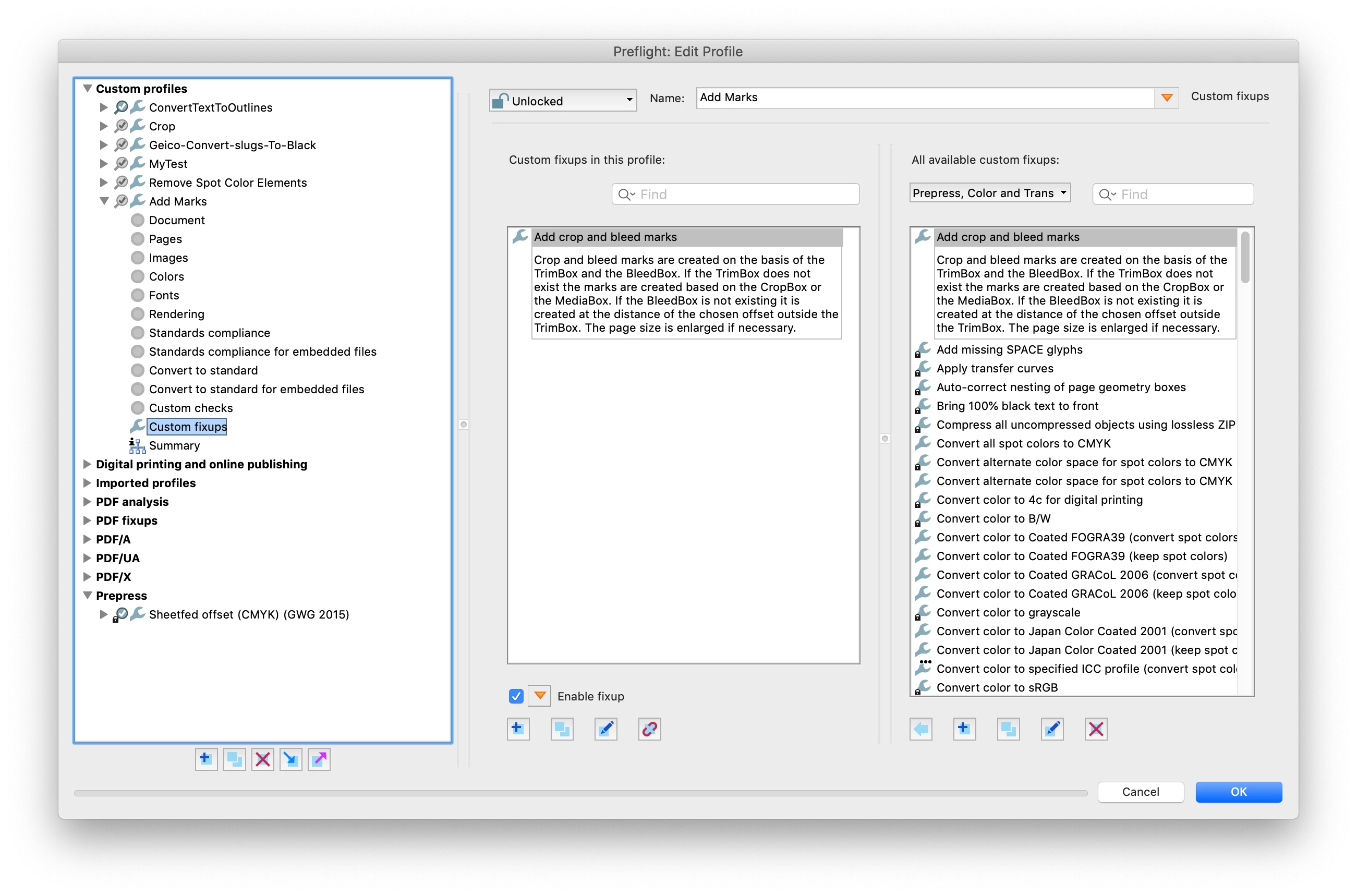

You can add the marks to the PDF directly in Acrobat Pro if the file has true trim and bleed boxes. Create a prefilght profile with a "Custom fixups" to add crop and bleed marks with your specified settings.
Mike

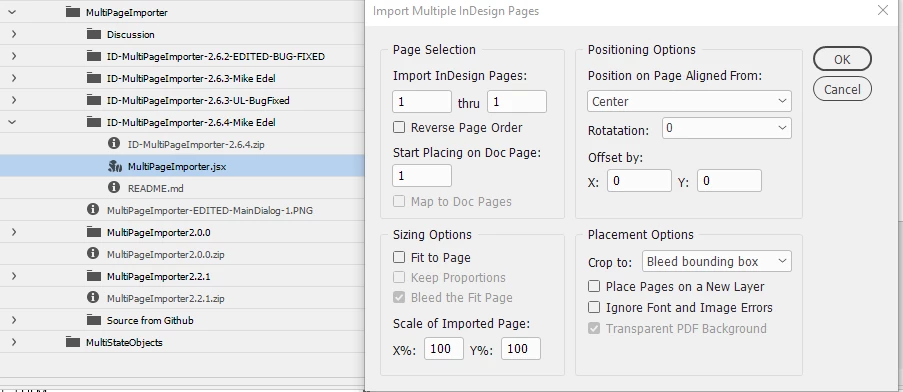

Hi Melanie,
as I said, hard to tell what's going wrong.
Did you experiment a bit with the MultiPageImporter script?
There are several options with "Crop to:" in the "Placement Options".
Uwe Laubender
Mike
June 9, 2021
Hi Mike,
Thank you, this is how I proceed 🙂 I've added the bleed + crop marks directly with Acrobat Pro and it did the job just fine 🙂

June 9, 2021
Hi Melanie,
I would try a different script, MultiPageImporter, originally written by Scott Zanelli and now curated by Mike Edel:
https://github.com/mike-edel/ID-MultiPageImporter/releases
Uwe Laubender
( ACP )
June 9, 2021
Hi Uwe,
Thanks for your advice, I've downloaded the script but still a mistake don't know why but I assume that the PDF might have a problem. And I don't have the time to figure what is the problem 🙂
Otherwise thank you for the script because I find it a lot more complete than the original one.
