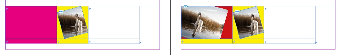

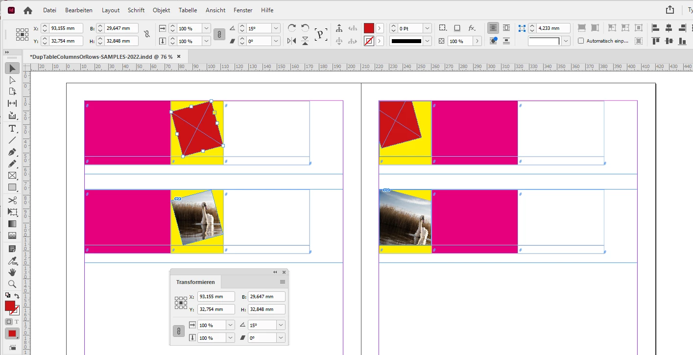

Jun 20, 2022 12:41 PM UTC

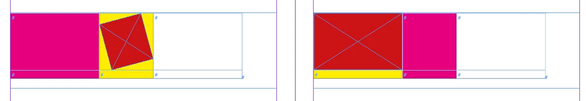

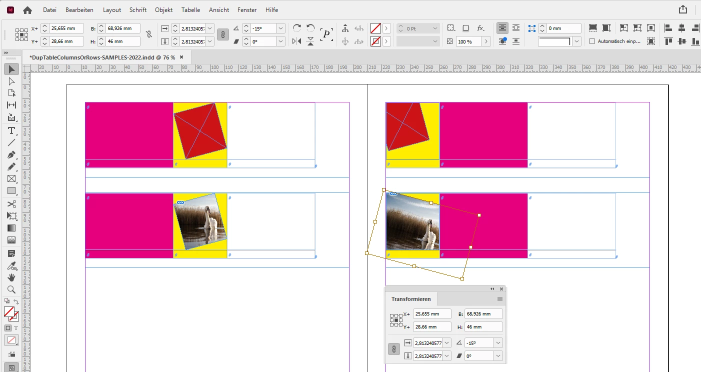

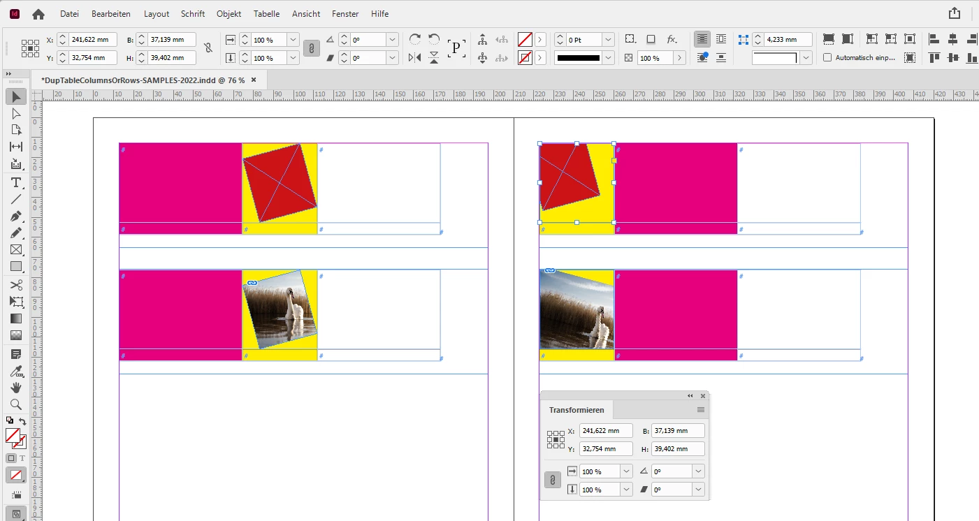

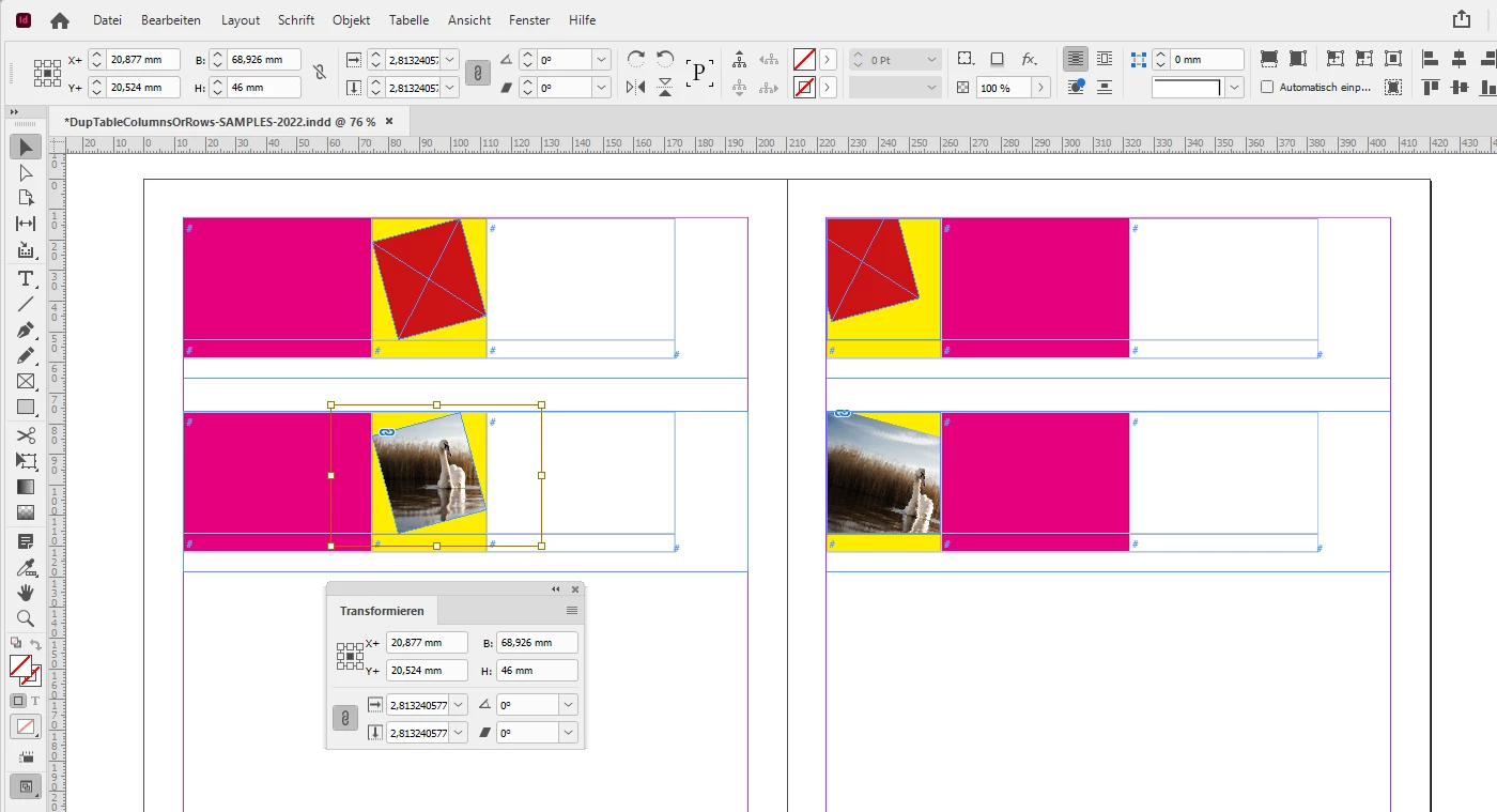

Hi Mark,
just tested your new version of the code v2022-06-19 with one of my test tables.
It contents a special "condition" so to say. A graphic cell where I rotated the container frame for an image.
I get inconsistent results with two variations.
[1] Frame has no image
[2] Frame has an image
Both results are wrong. And different.
I could tell from some experiments with cell.select() and copy/paste that even that will not get you very far.
In fact, InDesign was crashing as I tried to paste one of the two columns. It was the "easier" one with two text cells and no contents at all to a column that contained a graphic cell.
Details below.
On the left the original table, on the right the result after running code v2022-06-19 with:
// Text frame with table selected:
var doc = app.documents[0];
var table = app.selection[0].parentStory.tables[0];
var movedColumn =
moveRowOrColumn
	table.columns[1] ,
	LocationOptions.BEFORE ,
	table.columns[0]
Top table.
Container frame in graphic cell rotated to 15°.
Container frame selected.
Result top table. Container frame selected.
Note, that the red rectangle is now inside of that container frame!
Result top table. Contents of container frame selected:
Now on to the tables at the bottom where I filled the rotated container frame of the graphic with an image.
Bottom table.
Selected: Container frame in graphic cell rotated to 15°
Bottom table. Selected: Contents of the container frame in graphic cell:
Result of bottom table. Selected: Container frame in graphic cell
Result of bottom table. Selected: Contents of container frame in graphic cell
Well, food for thoughts…

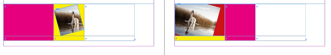

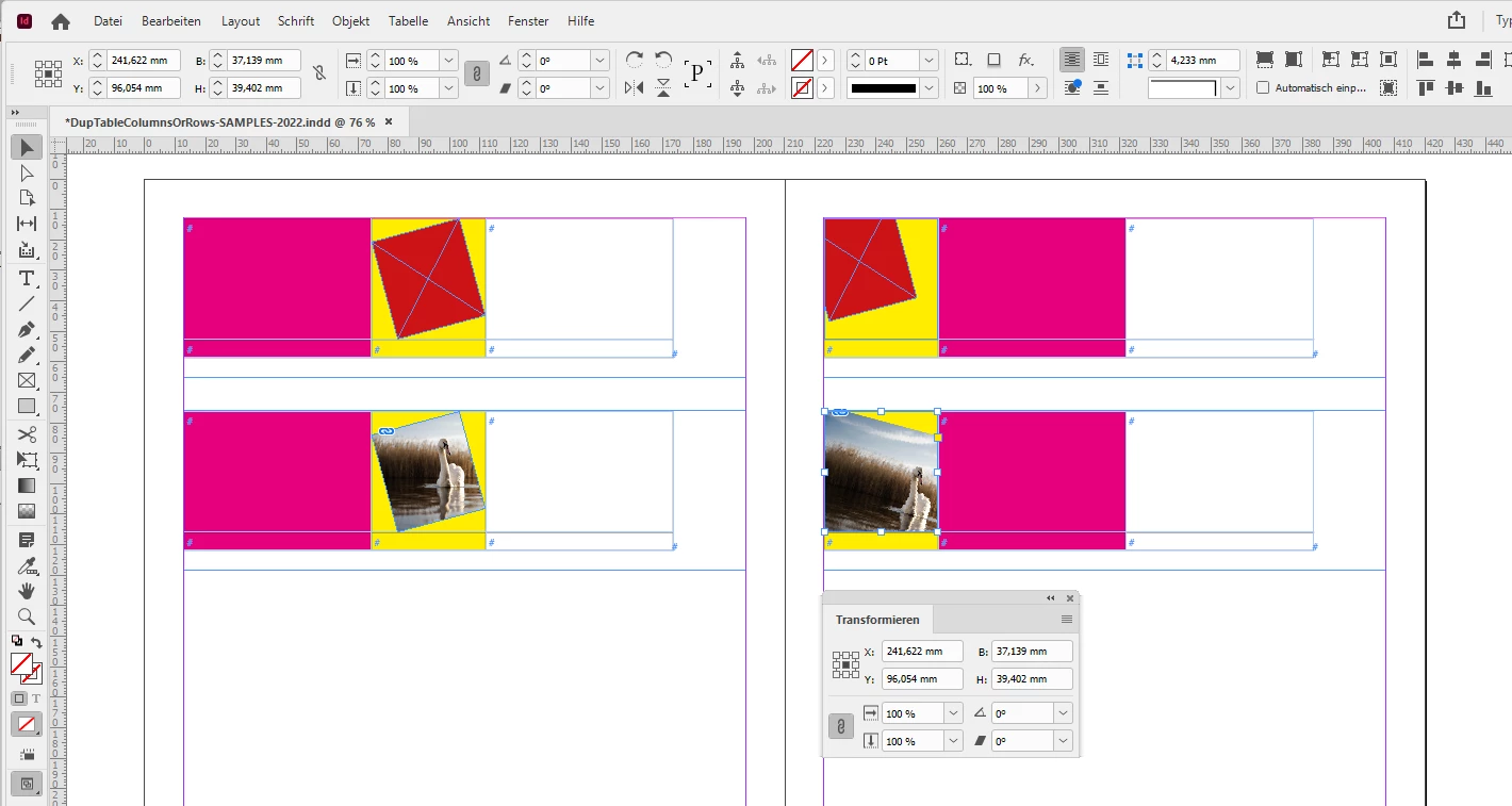

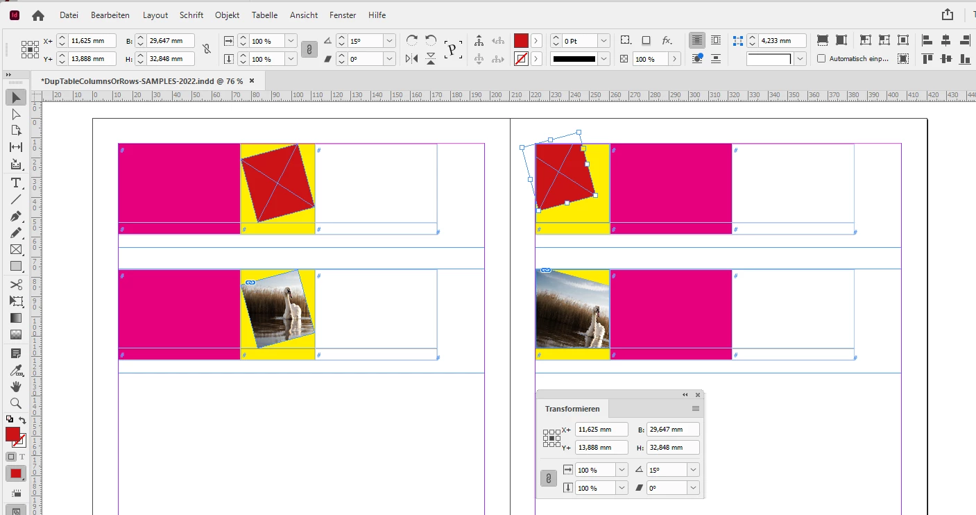

Jun 20, 2022 12:59 PM UTC
Copy/paste selected columns with the GUI. Left the source, right the result:
This time this also was working for my second table without crashing InDesign 2022 version 17.3.0 on Windows 10. Maybe I did something differently? Perhaps I was changing my selection more slow or I had the order differently.
Phase 1, copy column 2 to columns 1:
Phase 2, copy column 1 to column 2:
