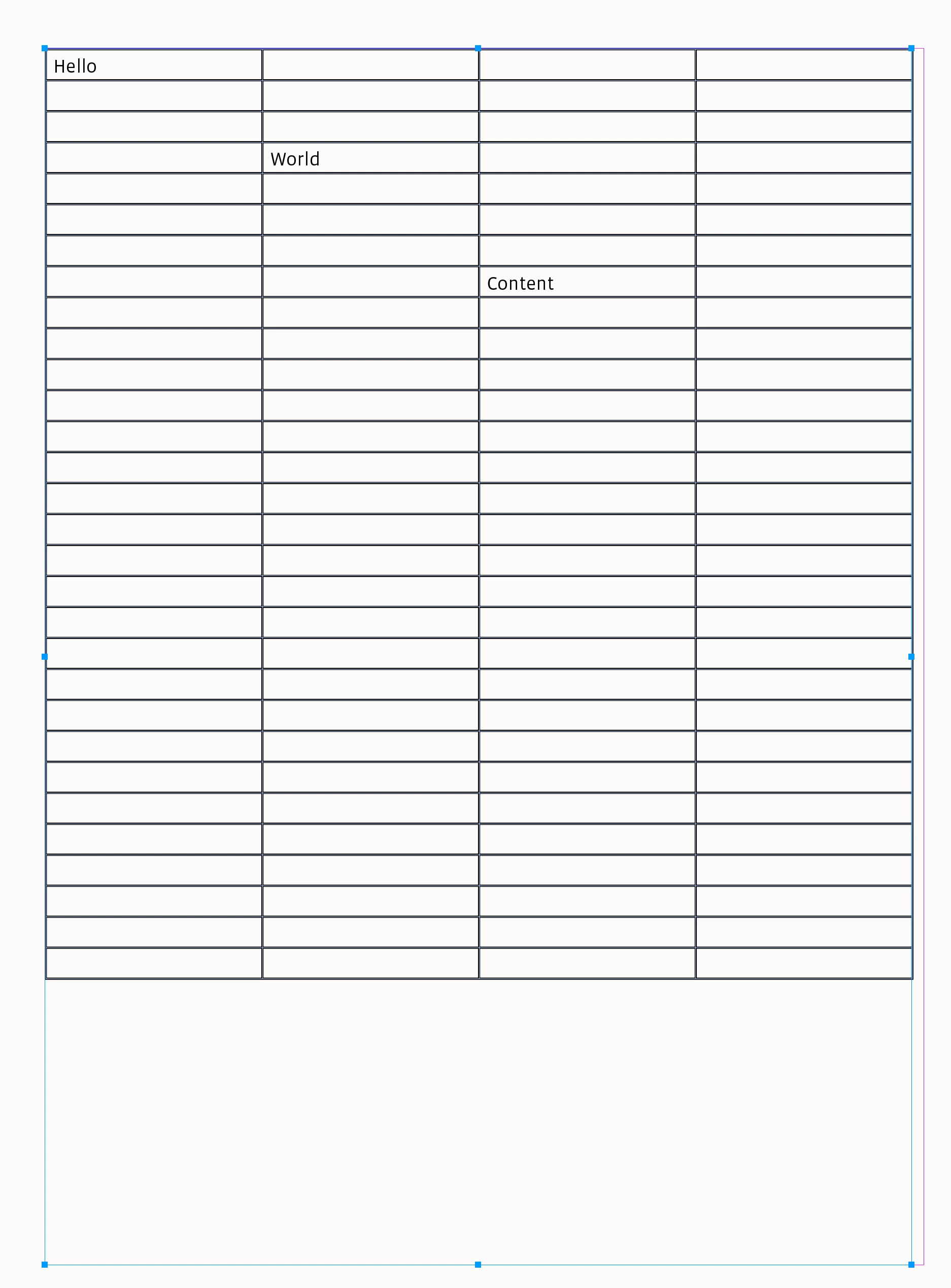

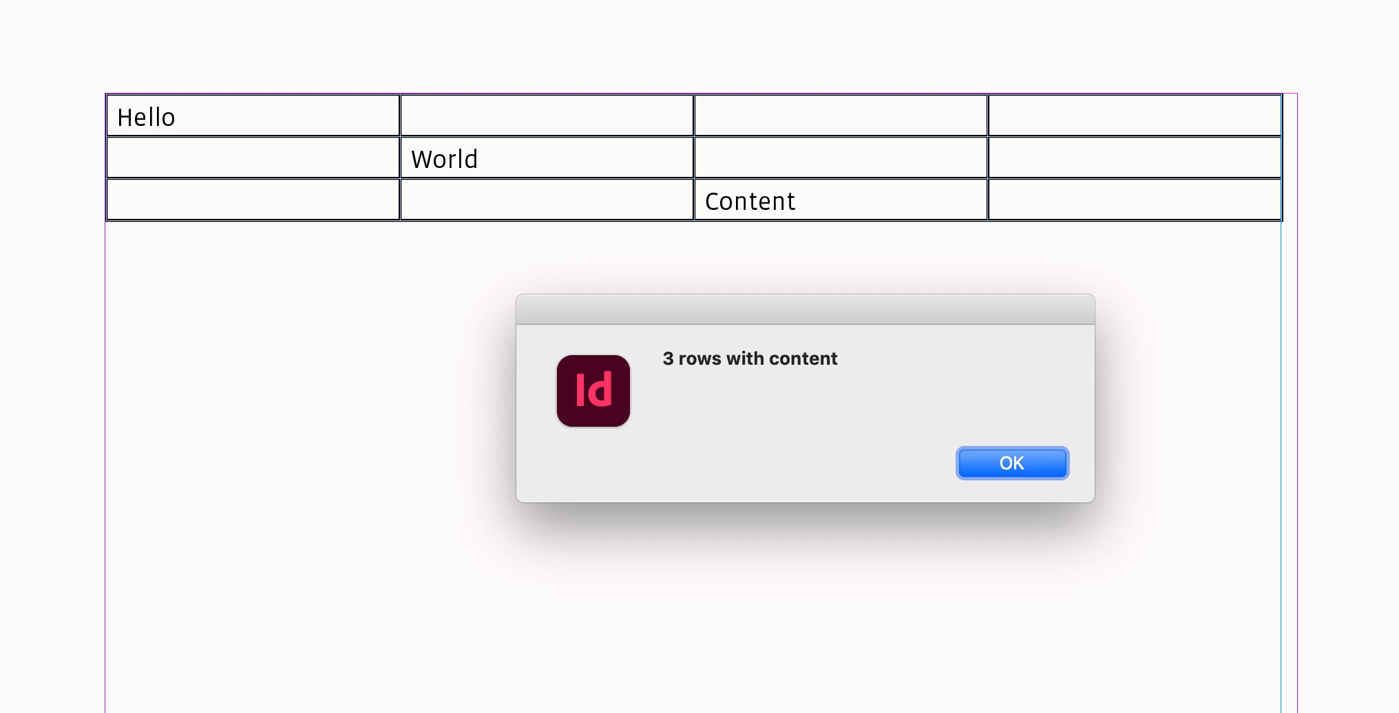

Hi @Jurre37971467hccf , Maybe something like this? My test ran in less than 1 sec
//the document’s tables
var dt = app.activeDocument.stories.everyItem().tables.everyItem().getElements()
//delete empty rows from the document’s first table
delEmptyRows(dt[0].rows.everyItem().getElements())
//$.writeln($.hiresTimer * .00000001)
alert(dt[0].rows.length + " rows with content")
* Deletes empty rows
* @ param r the table’s rows
* @ return void
function delEmptyRows(r){
    for (var i = r.length-1; i > -1; i--){
        if (!checkRow(r[i])) {
            r[i].remove()
* Check if any of a rows' cells contain text
* @ param r the row to check
* @ return true if any row cell has text
function checkRow(r){
    var b = false
    var c = r.cells.everyItem().getElements();
    for (var i = 0; i < c.length; i++){
        if (c[i].contents != "") {
            b = true
    return b
Before and after:
