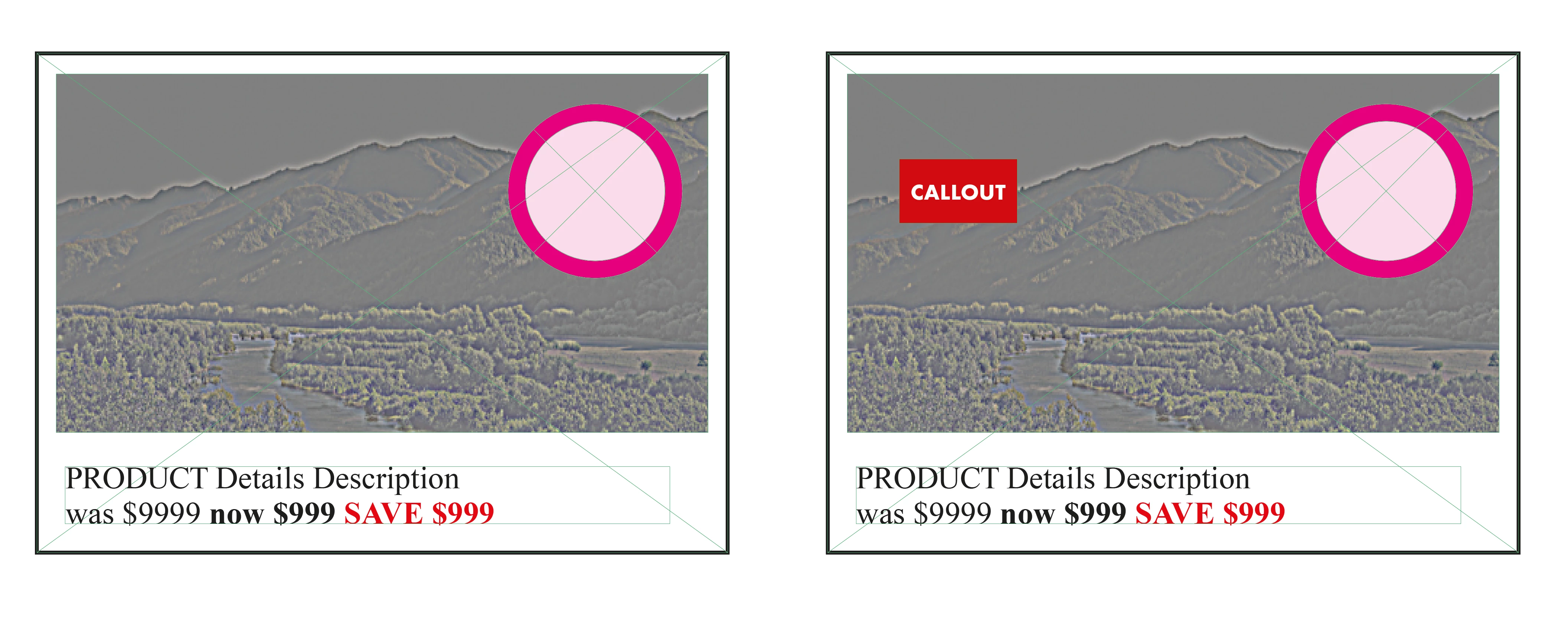

Hi there – I have a scripting problem outlined below but not sure if its even possible.
Is it possible use javascript to loop through all groups in a document and then target the group that contains the word “CALLOUT” with a find replace GREP to remove some pricing? And not touch the groups that don’t contain the  “CALLOUT” . The callout text box and the text box with the pricing are independent  of each other.
FIND was \$\d+(\.\d{2})? now \$\d+(\.\d{2})? & delete.
If possible what would that javascript look like
The group on the left does not contain the callout and the group items on the right does.
There could be many of these groups in a document.
Any help appreciated.
