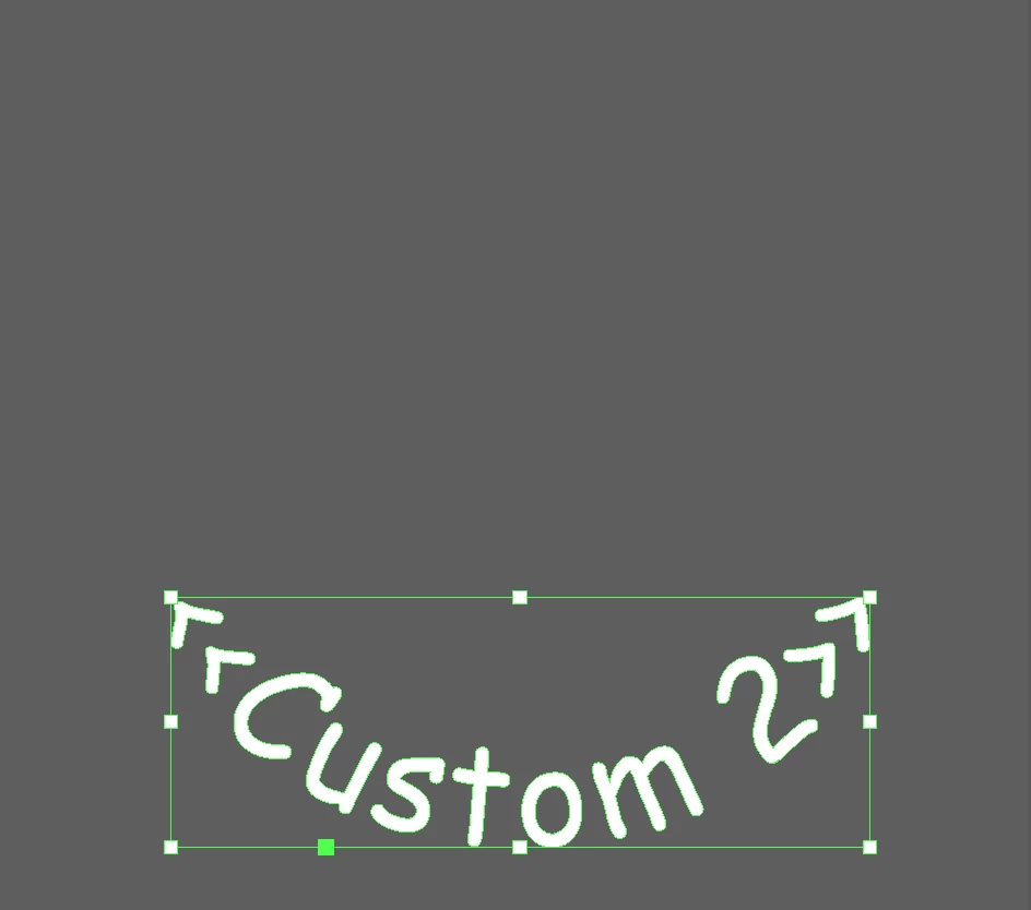

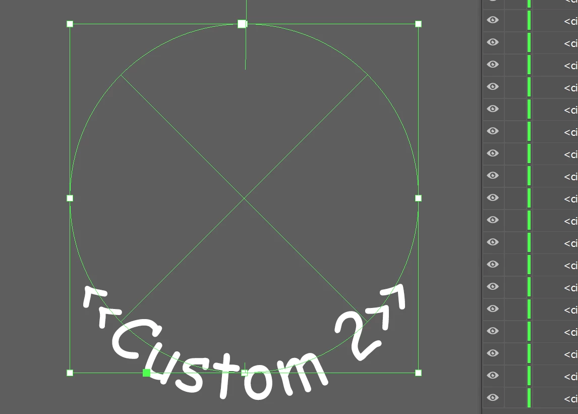

I have Ovals with a half circle path on them. I am trying to measure if the text exceeds half of the oval. My solution to that was to convert the path to an outline and measure its position relative to the halfway point of the circle. If I have the Oval selected in InDesign, and click Type >> Create Outlines, it converts the type path to a single Page Item with correct dimensions. Oval itself has no method .createOutlines();
However, I can't seem to mimic this behavior in script. I've tried variations of the following on the Oval object:

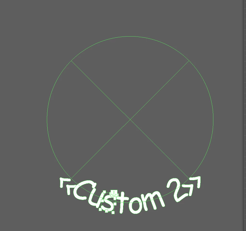

oval.textPaths[0].texts[0].createOutlines();
oval.textPaths[0].parentStory.createOutlines();
If I run either of those two commands, each character is outlined separately as anchored objects on the path, and they get condensed as such. Please see attached screenshots for the oval object, and the outcomes from running the outline through InDesign vs. running it on the parent story of the text path via script. Thanks.

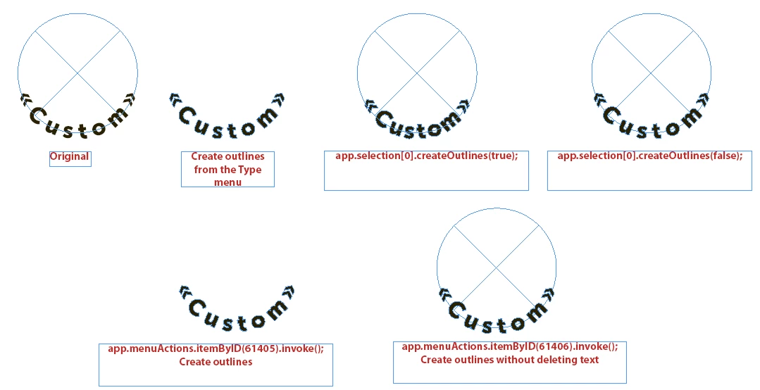

Alternatively, as a workaround, we can select the object in question and invoke the menu item, like so:
app.menuActions.itemByID(61405).invoke();

it's not the most exact method, but I would exploit the values for baseline and horizontalOffset of the first and the last insertion point. Hm, looking at your issue with creating outlines: know, that there is an argument to the method. Try to do a duplicated outline of the text and leave the original editable one alone.
oval.textPaths[0].texts[0].createOutlines( false );
From the DOM description about the argument:
"If true, deletes the original text. If false, creates the outlines as separate object(s) on top of the text. (Optional) (default: true)"
