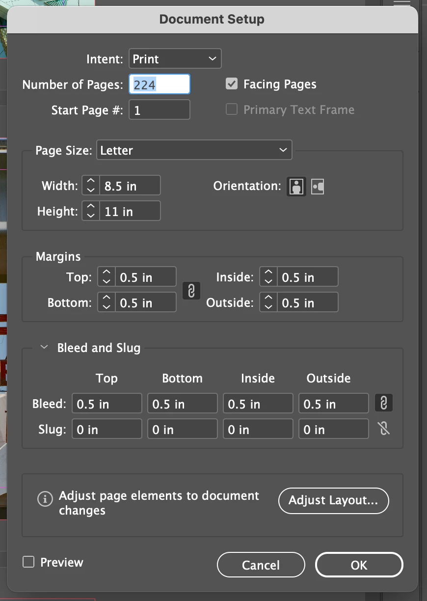

KDP 8.5 x 11 indesign Problems
Hello community,
I'm formatting my paper Photo book with some text inside, primary bleed photos.
Having this setup, I' getting lost, I need to set up a template
Can someone indicates with a photo if you can, the correct numbers for my template?
thanks in advance!

James Gifford—NitroPress
Sep 7, 2024 6:21 PM UTC
Your bleed settings are off.
  • Set up the page as 8.5x 11 inches.
  • Set the bleed to:
    • 0 inside
    • 0.125 inch outside
    • 0.125 inch top
    • 0.125 inch bottom
Most importantly, and KDP is fussy about this, your content MUST fill the bleed margins on al sides. You can't have an image that stops at a page margin or in between the margin and the bleed. You also can't have anything past the bleed lines, but export to PDF usually takes care of that.
Export to PDF with "use document bleeds" enabled. You should get output pages that are 8.625 x 11.75 and wholly filled by your image content. Anything else is wrong and will either be rejected or get you unwanted print/trim results.
You also want to keep "live content" such as text within their recommended page margins. They allow 0.375 inches for most pages but I'd set the margins at 0.5 inches all around — and 1 inch on the inside for any block of text meant to be easily read. (KDP has very tight bindings and any inside margin narrower than 1 inch, even if permitted, will make it hard to spread the book enough to read it.)

Derek Cross
Sep 7, 2024 6:09 PM UTC
Did you supply the document as a PDF, if so, did you tick "Use Document Bleed Settings"?
